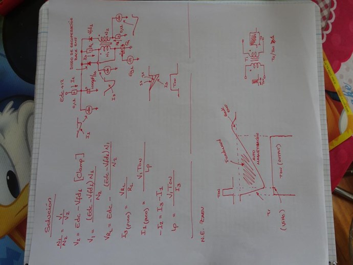

YoElMiCrO have posted some time ago in the ZPM thread the following formula to get the correct relationship between the coils:
@Fighter.
I still do tests to understand your experiment, but everything has to do
with magnetic permeability and standing waves.
The turns ratios must be quadratic because the inductance is.
This means that the turns ratios will be the root of 0.75, 0.5 or 0.25 of lambda for
one of your inductors N2 = SQR (n) N1, where n is one of the previous numbers.
Thank you all in advance.
The Two opposing coils have to be in one of this relationships because the coils acts as antennas, and have to been tuned for quarter wave resonance. This leads to a standing magnetic wave in the core, and to a huge rise in potential.
In my poor mathematic knowledge I asked why the square root, and not simply a relationship of turns or wirelength of 0.25 0.5 or 0.75 ? The answer is because it is a derivation of this formula: N=SQR(L/Al). Well the most important thing is that it works, and it can be replicated by anyone. The effects are very prominent, take care of your equipment when you make a replication. The good news are than basically any core can be used, although some performs better than others, the same applies for the switching. Most important is resonance, and we can use very short pulses of a quarter wavelength. If we use separated coils also the positioning on the core has to be accurate, but in the following tests with ferrites we can see the effect is present with bifilar wound coils. Please understand that it will take me some time to edit some video sequences and to order the images of the test.

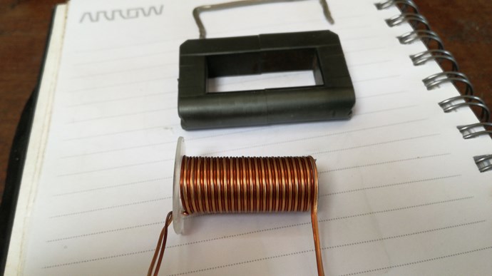

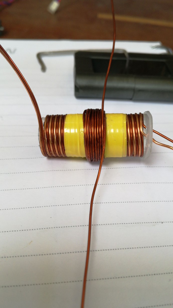

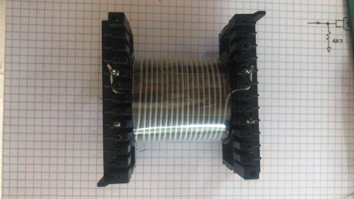

My replication is a bit different, with  recycled materials :

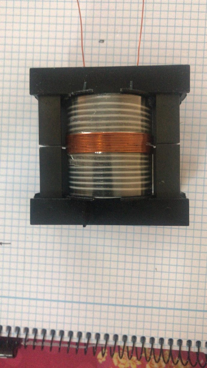

The secondary, for the moment for monitoring purpouse is wound over the center part:
In the built from YoElMiCrO the secondery is in stepdown 1:10 to avoid excessive high voltage.

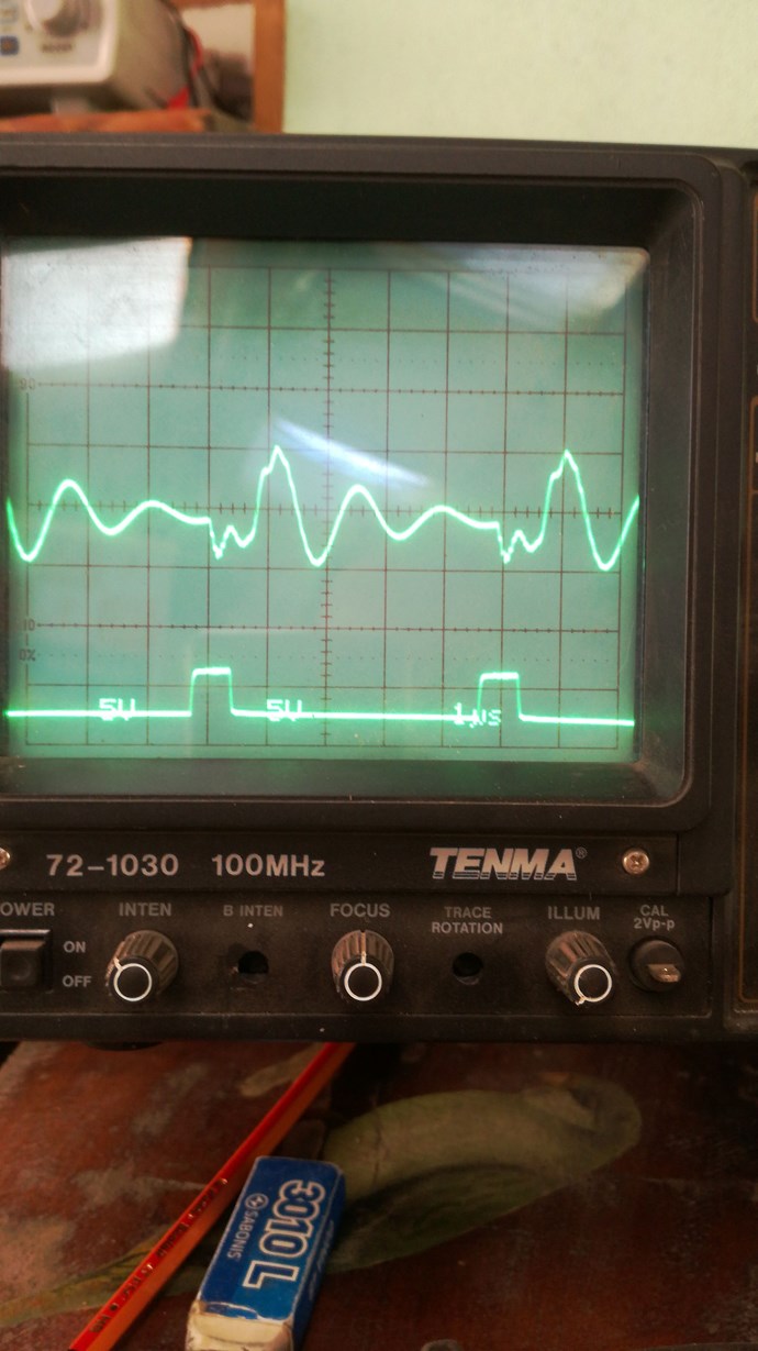

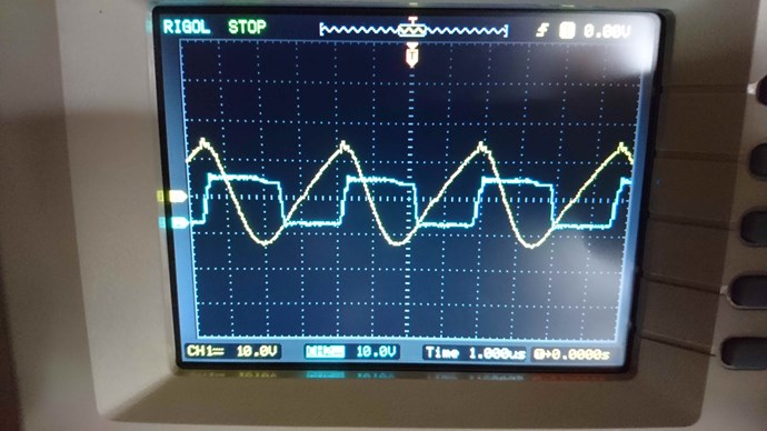

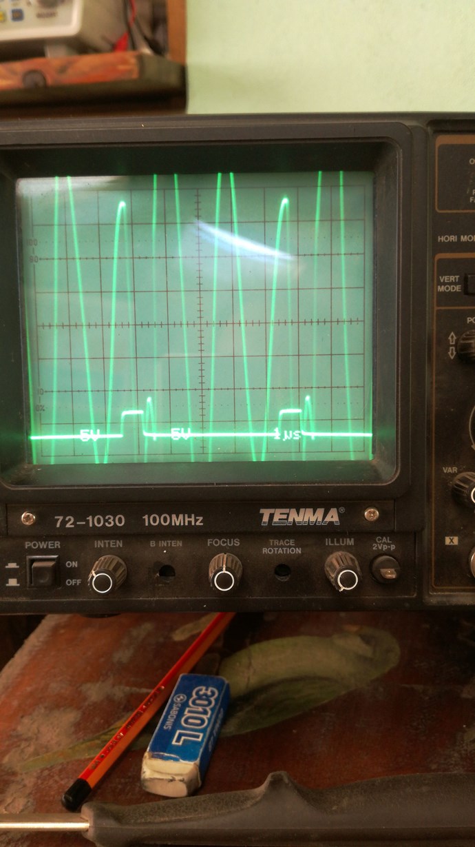

Here a scopeshot from his setup:
Note the alignment of the signals, this is important to have longitudinal oscillations.
Will continue soon.

In the device of YoElMiCrO he uses a complete noninductive primary, so there is no magnetic coupling, the emf of the secondary is induced purely by the E-field. I tested first noninductive, and then i removed 3 turns from the 21 on one side of the bifilar. Here some scope shots of my results, I will add more documentation as i have time to do so.
noninductive, IGBTswitch
with a SIC MOSFET
after removing the 3 turns

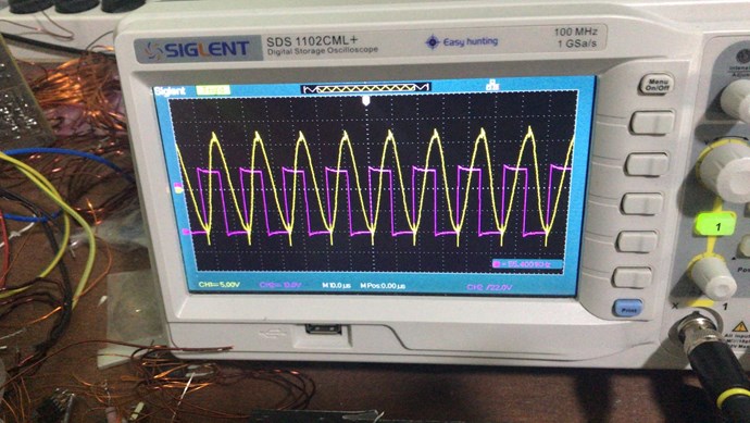

Probe factor 1:10    100V pp  with an input of 5V 10mA
will continue...

as i had some time today i made another coil, this time more similar to the one shown by YoElMiCrO, with another fly back core that i got from a friendly TV repair technician. All the tests shown are made with a noninductive bifilar primary coil, I still did not try the quarter wave technique, this for the next testing series. I can tell you ,this device is really mind boggling.
I wanted to add that this time it was possible to drive the device in direct resonance, but at expense of increased current drawing(reduced impedance). and as the wires are thin to avoid heating I used a lower harmonic again.

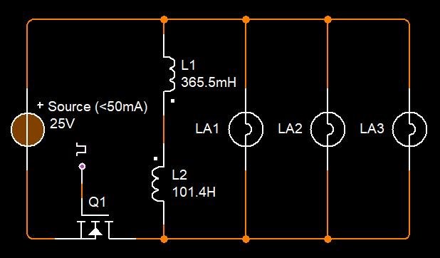

I suggested another thread, one with hard data, some .NET Apps to calculate the turns and so on, but this thread is already that. Remembering Fighters Schematic:
R coil has 365.5mH inductance and approx. 300 turns made of 0.8mm standard copper wire for coils. These are the complete characteristics I measured with my LCR meter (link to larger image here):
Ref: Fighters original Post.
// Turns:
double L1Turns = 300;
double L2Turns = 0.0D;
// Wave Types:
double QatarWave = 0.25;
double HalfWave = 0.5;
double ThreeQatarWave = 0.75;
// Chosen Wave:
double Lambda = QatarWave;
// Do Math:
L2Turns = Math.Sqrt(Lambda) * L1Turns;
L2Turns = 150 turns. Which is correct:
L coil has 101.4mH inductance and approx. 150 turns made of 0.8mm standard copper wire for coils. These are the complete characteristics I measured with my LCR meter (link to larger image here):
I ask, all readers, join in!
Don't be shy, I will protect all, none get trolled here! All Members are important to me and I will not allow any harassment!
Of course, thank you to YoElMiCrO, I did not know about the equation given!

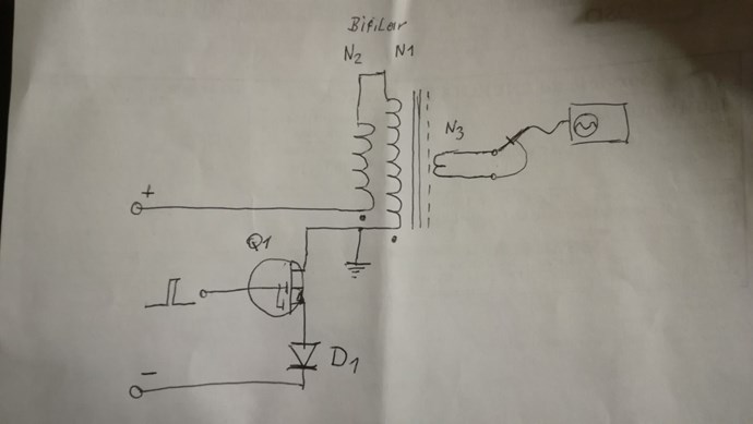

here is a sketch from the setup:
I have tested with and without D1, YoElMiCrO recommended to use it, but the oscillations are less damped without it, further tests with the  loaded device will be needed to evaluate this. Also the earth ground is not needed for the functionality of the oscillations, but it will likely add current for energy extraction. In noninductive configuration( N1=N2) only with the ground connection there was a significant EMF in the  L3. Turns N3 are 10-20% of N1, put the scope probe in 1.10 as the voltage can rise to high levels.
The wire tap on the top of the coils is the junction of the bifilar coils.

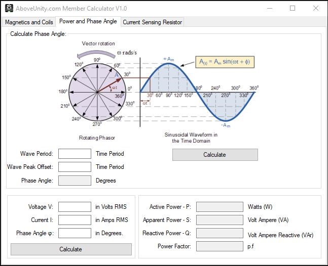

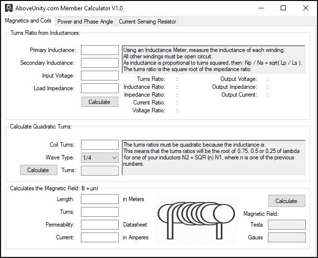

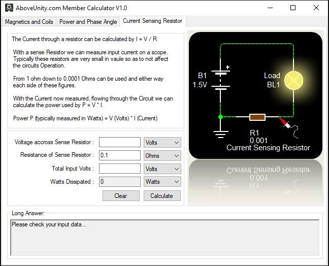

I have a small calculator I am working on, for a few small, simple equations that for some would be difficult to implement outside a Calculator. I will work on this and see if I can make it useful enough to post soon.
EDIT: Calculator attached as Zip File: "AboveUnity.com Member Calculator" - Early Version, please ask for changes and improvements!

Someone has asked if there is a sinewave fed into the circuit, the answer is no, I used only short DC pulses of less 1 us. If you use a SG try to maintain this puls duration when looking for the resonance frequency, you might need to adjust the duty% according to the frequency. Vidura.

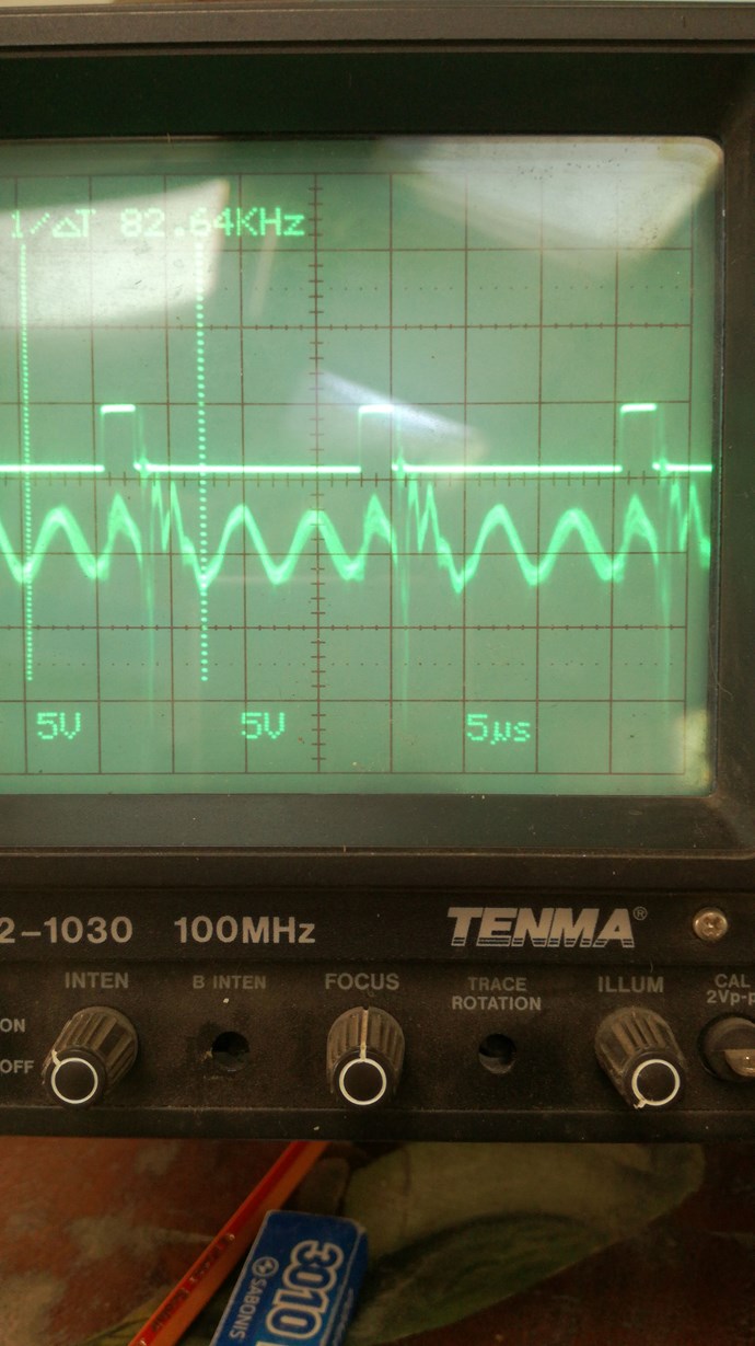

I managed to create magnetic resonance.
What was important for the setup:
- frequency,
-FET fill factor
power supply voltage
As well. The FET (IRF540) used on the first try worked perfectly. I managed to adjust the magnetic resonance. I used the same number of turns as Vidra. (70.5-61T)
Grounding is really not necessary.
I also tried other transformer arrangements.
Magnetic resonance can also be perfectly created there.
But the voltage was higher, so the FET broke down.
I replaced it (2SK2655) but unfortunately I couldn't adjust the resonance.
 (Here you can see the importance of fast FET on / off and low gate resistance.)

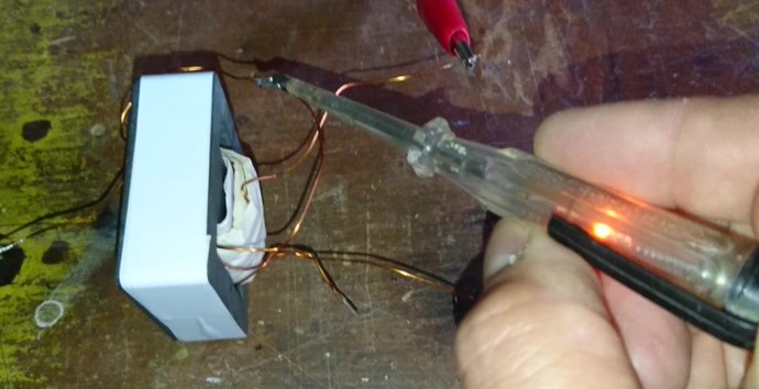

But I managed to take some pictures.
Anyway.Now I know what I'm looking for.

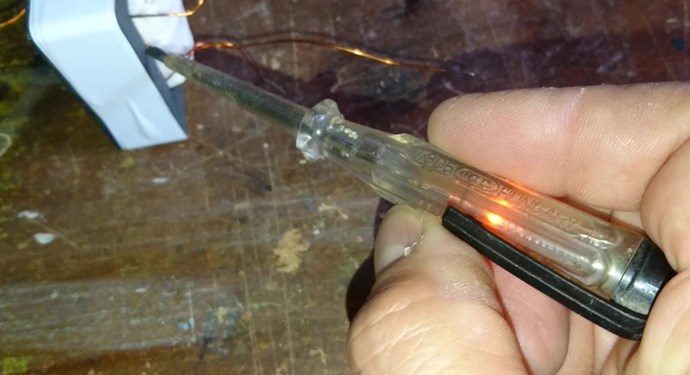

The high voltage also appears on the ferrite transformer. This is shown on the phase search pencil.

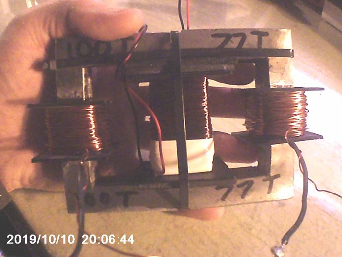

Hey Friends, First I was not sure to put this video in the thread , as I could not get the trace we could see on the last experiments, where the polarity is swapping abruptly when the switch turns off. Anyway the magnetic resonance is there, the standing wave produced by the opposing fields of the nearly identical coils. And the effect of the E-field is stronger than in other devices. Here is the video:
Sorry about the mistake in numeration, number 3 already was poste, it should be nr4.
patrick1 posted this 10 October 2019
Hi Vidura,  i have been playing with the coil inductances, i too believe this is a critical point too tuning. - although i have been testing the square root 1/4 and half wave   - coil setups. ...   i am have difficulties identifying the resonant point... there are promising looking points, when a inductance square wave, morphs into more of a sine wave, - but on my output coil  @ that point. - im not getting anything out lol.  - coupling is too loose, - but thats a diffent issue.   -      i have not seen many attempts @ tuning these machines with iron cores. - bringing them in and out of resonance.
Zanzal posted this 10 October 2019
Excellent demonstration Vidura!

Hi All Here another experiment, some odd things discovered accidentally.
Edit: another odd observation I made is that when i connected both terminals of the coil to the same side of the switches( halfbridge config) the intensity of the oscillations reduced to half, although the polarity, and all other parameters was the same, only with two switches less.

YoElMiCrO posted this 19 October 2019
@Zanzal.
I still keep it as a hypothesis since there are many gaps left to cover.
The basis of the hypothesis is as follows.
For decades physicists gave names to the entity we are looking for.
Those names were, Ether, ZPE, Quantum Void, Sea of Dirac among others.
We know that from somewhere we have to extract energy to finally achieve AU.
From my point of view this entity is only the electric field.
I explain...
In any transformer with two inductors formed by N1 and N2
under pulse work regime, (E) is always present.
We don't have to wait to generate any magnetic field.
From the moment we apply the pulse to one of the two inductors, say N1, it will appear
a voltage in N2 that will be V2 = V1 / (N1 / N2) as we all know.
If we leave the voltage V1 to N1 applied, we will start to use energy from our source
supply due to the magnetizing inductance N1 that will move the magnetic domains
in a given direction.
On the other hand if we apply a charge to N2, then to hold the electric field
that is entering the system will also be our source of supply that provides energy.
That is what T.E Bearden refers to when he talks about not destroying the dipole, at least I think so.
This simple experiment demonstrates how to make only magnetizing energy
the supply source provides while the load current is provided by the material itself.
It is a circuit with positive feedback, in this way N2 will make a clamp to the voltage
of supply and the magnetic field itself will provide the charging current.
It is the same basis for Mr. Preva's experiment but it works in the first quadrant.
N.E Zaev also applies the same hypothesis from my point of view.
But about an inductor and the capacity of self-magnetization that the material possesses
that composes it, because during this spontaneous action the tension will continue induced
in his secondary, in his case the timeline is the one that relates the energy.
The secondary voltage lasts longer than the applied one, then the energy gain
It will be proportional to the time ((T) induced / (T) initial.
If you look, I think everything is related, the idea of ​​getting that field (E) from the middle
and the current of magnetism is what I currently pursue.
Chris is right.
Thanks in advance.
