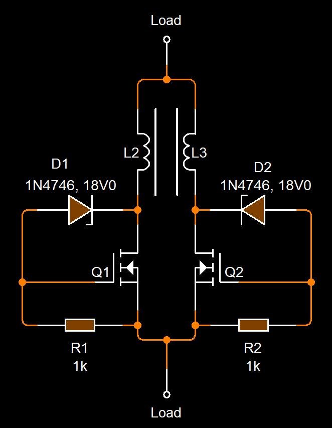

The Effects of Delayed Conduction in Bucking Coils is important. What is Delayed Conduction? What is the point of this?
Delayed Conduction is specifically to get the Voltage on the Terminals of your Partnered Output Coils as high as possible in reason! Its the change in Magnetic Field that Creates Voltage, its the Opposition of Magnetic Fields that Pumps Current!
I gave an example of Delayed Conduction here.

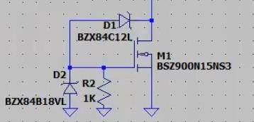

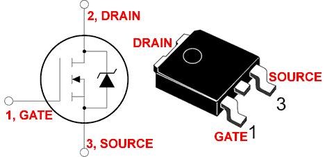

As you can see, the Mosfets will only conduct when the Zener Diodes Conduct, this is rated to 18 Volts.
This means, the ends of the Partnered Output Coils must be at least 18 Volts, before the Coils can power any load!
We have seen this before! This is not new to those that have done the Study!

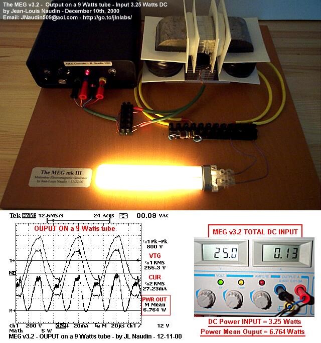

The MEG Demo Circuit
Ref: JLN MEG Replication
Ref: The MEG Team Data.
Where the Top Trace represents the Input Channels, and the bottom Trace Magnetic Resonance in the Output Coils, seen as Asymmetrical Regauging.

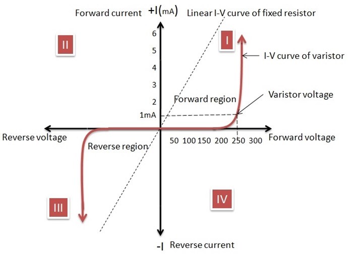

NOTE: JLN used a MOV in his MEG Replication. A MOV has similar Voltage to Current Characteristics!
Ref: JonRB
Ref: Renesas Datasheet
Ref: The MOV or Varistor V I Characteristics

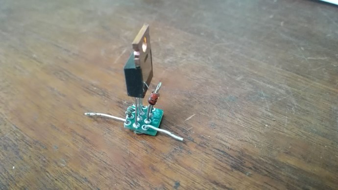

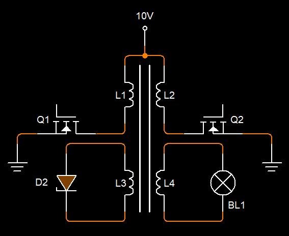

Simple Starting Circuit - Some parts upside down to make you think backwards.

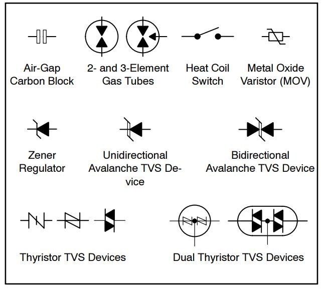

Where: D1 is a Delayed Conduction Device, Zener Diode and a Mosfet or a MOV or a TVS or similar device.

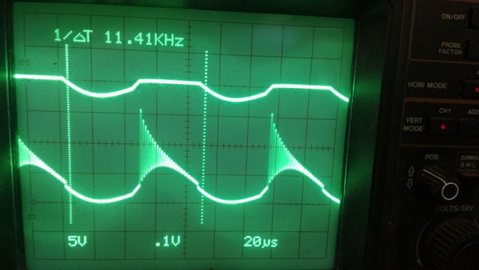

The Sawtooth Waveform
We all should be very familiar with the Sawtooth Wave form! I have been showing it for months now. It is very important that the understanding of how this waveform is achieved! Like I have tried to explain, this is where the Waves Slap Together, the Electromagnetic Fields of each Partnered Output Coil.
The Partnered Output Coils react together to Generate Energy. Using Delayed Conduction to achieve a Resonance in the Coils, called Magnetic Resonance!
Don Smith:
The MEG Team:
Tinman (Bradley Richard Atherton):
Graham Gunderson:
The Sharp Spike is Delayed Conduction, it is where the Two Partnered Output Coils have Magnetic Interactions that slap together very fast!

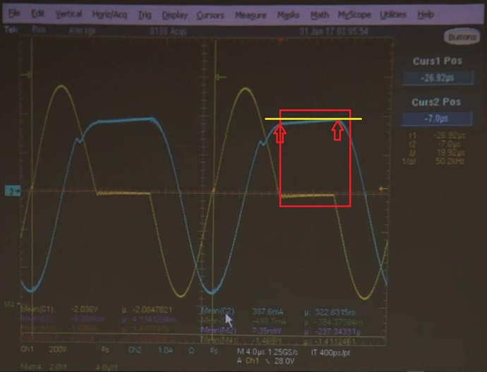

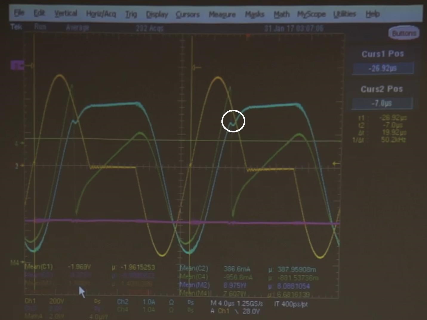

I am not convinced Graham's MIT was in Saturation. I think maybe close, but the problem I see is, if he was in Saturation, the Voltage and Current Waveforms would not be 90 Degrees from each other:
Input Voltage ( Yellow ) and Input Current ( Blue ) would be almost in phase, not a quarter Cycle later. A Quarter Cycle is 90 Degrees and indicated the Core is not Saturated.
So, at Saturation, Inductance is lost, and an LC Resonance Tank Circuit can not be 90 degrees out of phase. The Inductor becomes a Resistive Element, because it has lost all its Inductance L.
Sorry, long winded, but my analysis, is that he is not in Saturation, but is close. I may be wrong and over looked something?

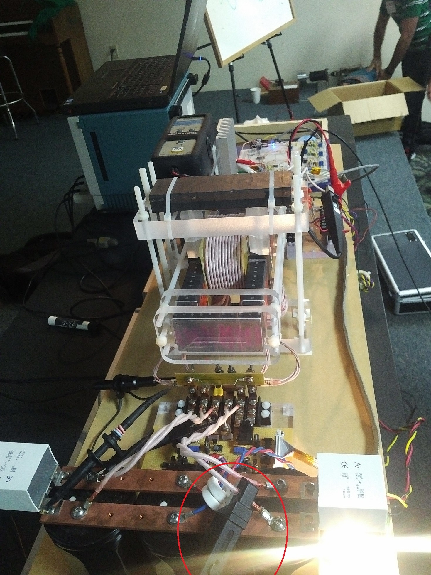

Graham has an interesting machine, yes it is directly related to this topic! But it is done in a slightly different way.

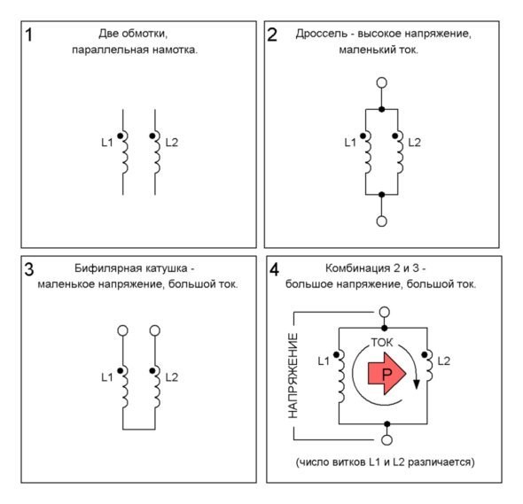

Grahams Partnered Output Coils, should be thought of as two Parallel Wires! Connected in Parallel Series! The Wires have a direct relationship to each other! At anytime the Relationship to each other were to change, so would the Magnetic Fields between them.
Remember, Current is the Magnetic Field!
If the Current between the two Parallel Wires, were to be aloud to change, then there would be a full reversal, which we have seen already. Why a full reversal in Current? Because it must be Equal and Opposite, Faradays Law of Induction with Lenz's Law states this!
This Change, only requires a change is the flow of Current, which is a Conduction related issue!

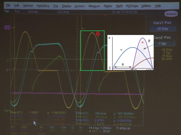

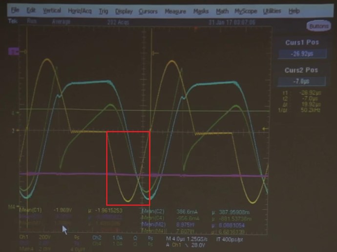

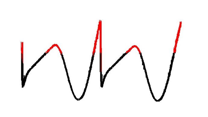

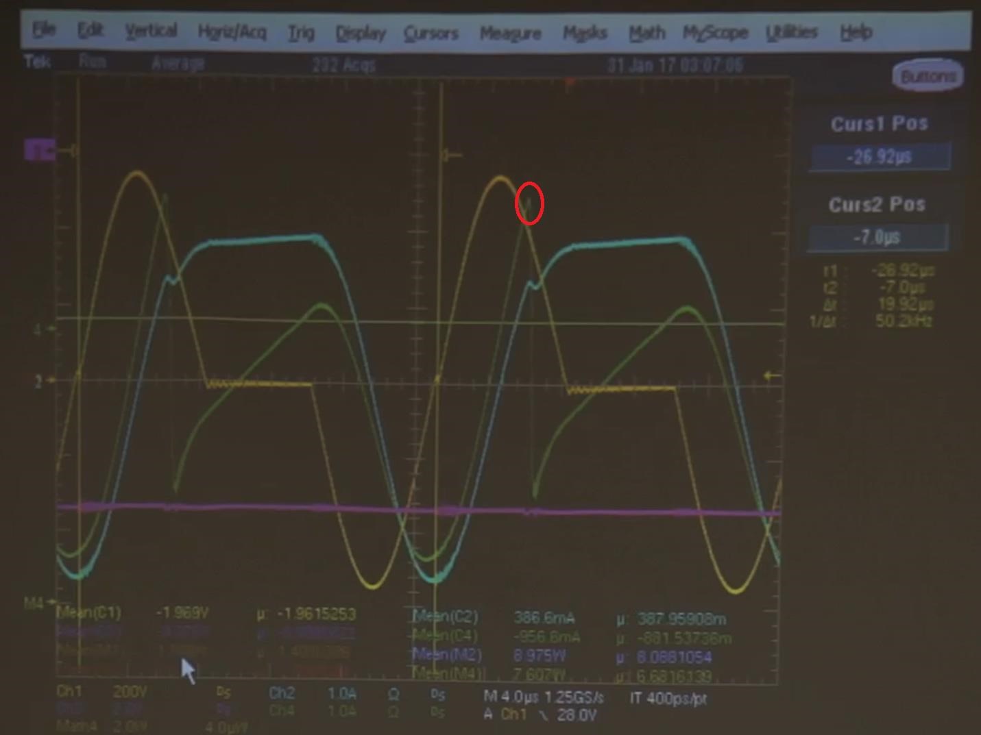

Break up all the parts of the Cycles seen:

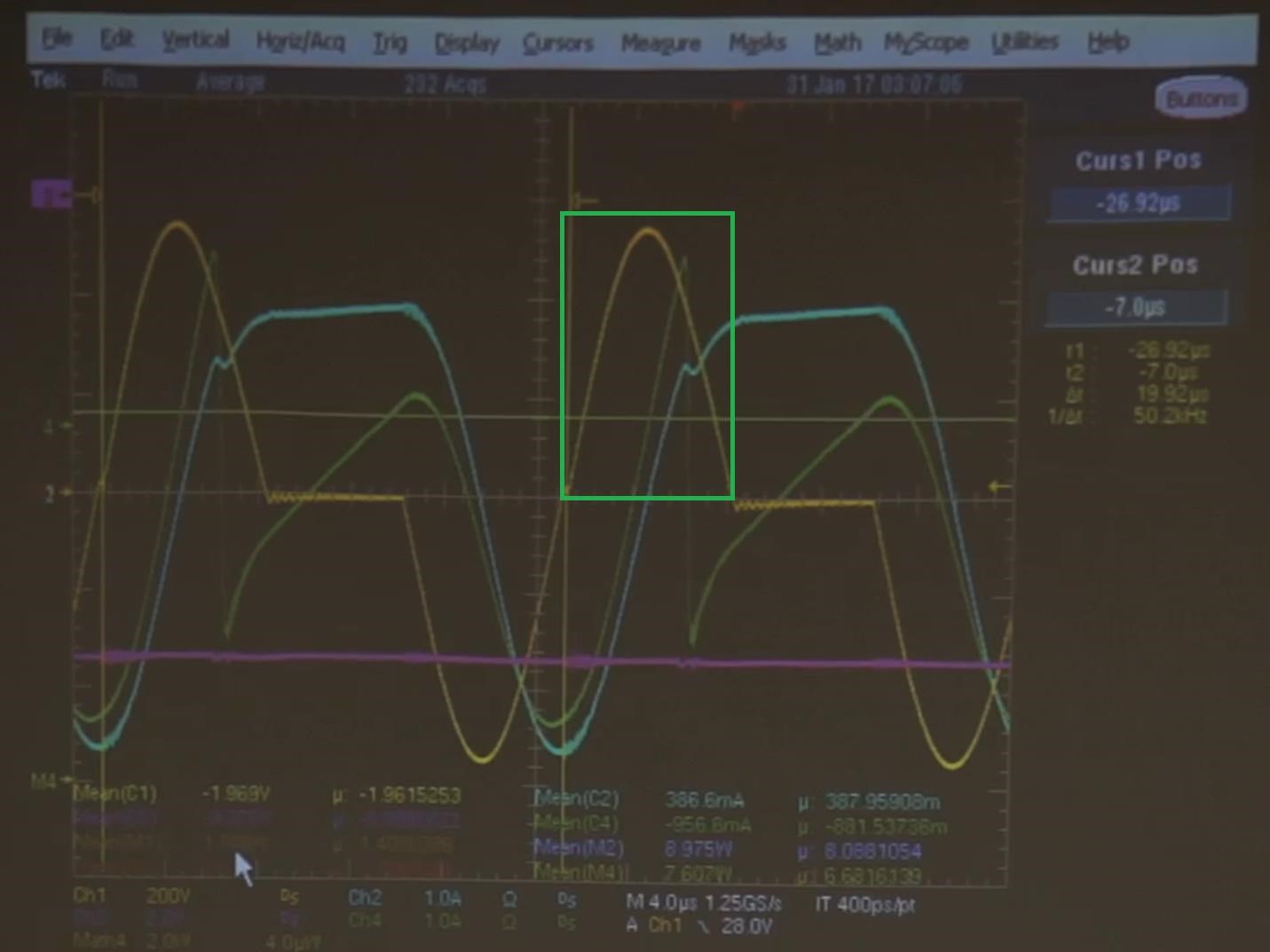

The Area marked in Red is standard Transformer Induction, there is no indication of any overly unusual activity in this region. This region is the Half Cycle, it could be thought of as a negative DC half of the AC Cycle. Power here from Input to Output is Transformer Induction, with losses. The power would look like this:
Marked in Yellow.
Now, marked in Green, the active part of the Action comes:
The power would normally look like this:
Marked in Green. Now we must carefully analyze this, because we only have half of the Power expected, we have a specifically arranged interruption in Conduction at Peak Current, or very close to it.

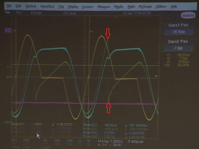

The Switch:
Important: The Green Trace is the Output Current shown on only One wire:
At the point of the switch:
Marked in Red, the point of the Switch! Also seen, and should be noted, the only kick in the waves seen:
Marked in White, the only kick in the waves seen. Its a negative Kick, a kick that shows a negative pressure on the Input Current ( Blue ). Also important: The Input Current, after the Switch, the amplitude increases over time!
So, what's going on?
  1. Parallel Output Wires are building in Voltage and Current, the are fully loaded up until the Switch!
  2. At or close to Peak Current, the Parallel Series Connected Coils are Interrupted, the Conduction on One Coil is Broken...
  3. What happens now? How can the Current Flip so quickly?
The Green Trace above, shown above to indicate the Positive ( Red ) and Negative ( Black ) swings in the Output Current Trace.
Seen in the middle, is the very sharp change from Positive ( Red ) to Negative ( Black ). This happens in a very short time!
The Coils have a Tension, then the Tension in one Coil is broken, via a switch. One Coil still has a tension, but the other has no current, but the other coil wants to change. The Tension in this coil can not stay where it is.
The Coil that has a broken tension, is conductive via the Mosfet's Internal Diode, but only in reverse. We know that Equal and Opposite Currents must start to flow if there is a Conduction Path!
Question, does the Switch need to be turned back on? If so why?
Graham is using the Tension ( Voltage and Current ) on one Output Coil, to Flip the other Output Coils Polarity, to create equal and opposite Tension ( Voltage and Current ). Bucking Coils! He is using Partnered Output Coils!

Jagau posted this 16 March 2019
Very good analysis Chris
As can be seen everything happens when the little kick occurs, the output current (green) is then ahead of the input.
 This happens when both current go through the most negative point.
Perhaps this is due to the timing of the 2 mosfets, there must be this special timing
that makes one of the two resumes the pendulum to project the ball further? An analogy of the swing?
as if it would be the capacitor who would take the lead

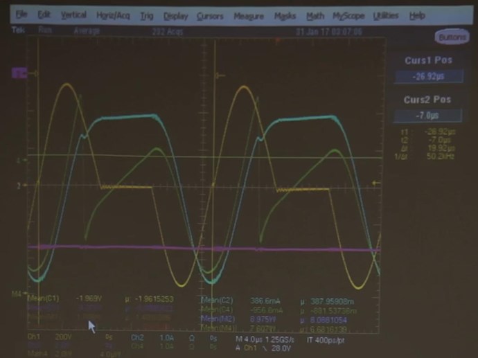

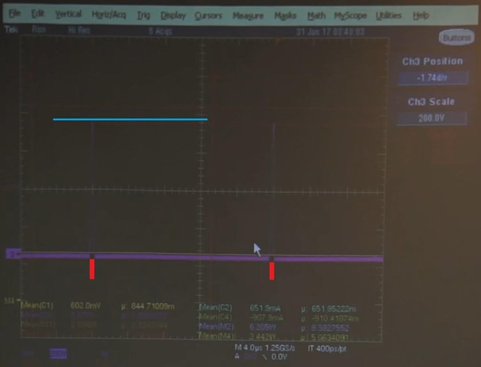

Let me try again:

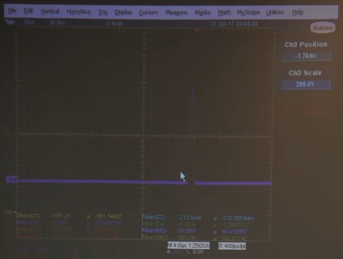

In the Terminals of the Left Partnered Output Coil:

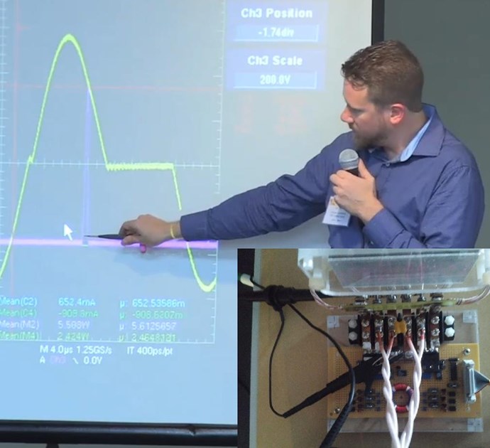

Using the High Voltage Probe across the Left Partnered Output Coils Terminals, shown above, gives this Waveform:
Conduction is Broken for a very short time! Graham said around One Millionth of a second in the video? We have seen the Flip in Output Current on the Output from the Right side Partnered Output Coil:
The Same Time Base is used on the Scope. Note: M = 4μs
I guess, what I am trying to show here, is the Delay in Conduction of Graham Gunderson's Partnered Output Coils! His has done very much more like we saw here. The MEG, a  little different, I showed a slightly different way again here.
At the end of the day, its all a Delay in Conduction all achieving the same end result: Magnetic Resonance.

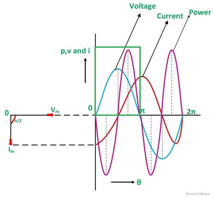

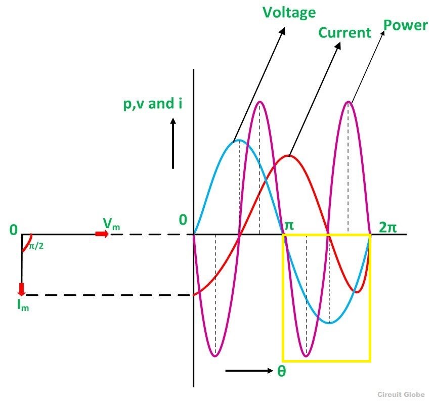

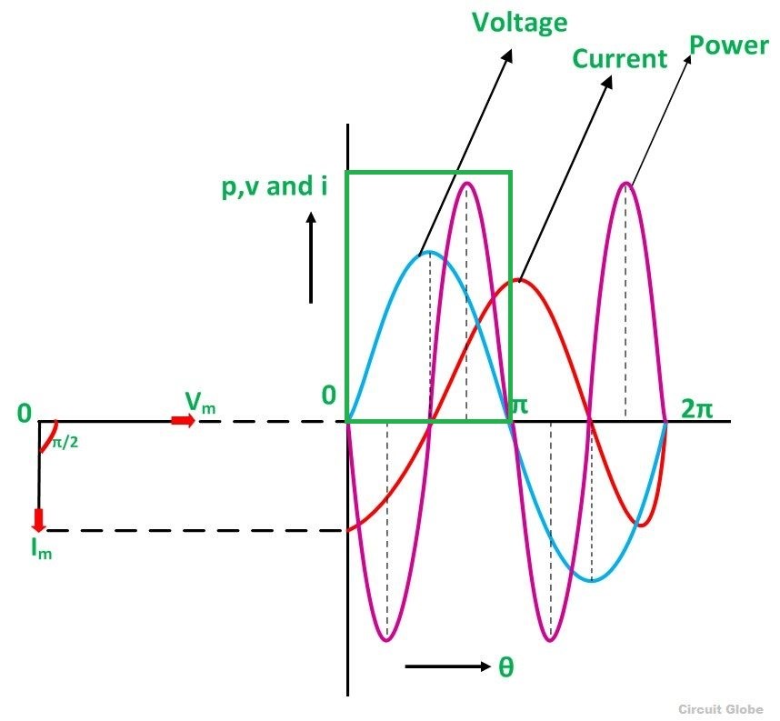

In the Area of Power if Voltage and Current are 90 degrees out of Phase, Current Lagging, is a very important place to keep in mind! All machines I have studied have used this area in one fashion or another, Kapandze, the Spark fires at the peak of the Wave, same place. Through a short thick Copper Coil. This interruption in Conduction, Delayed Conduction, is critical.

For the entire time, between the Red markers! The Red markers indicate Off Time! Thus the Voltage Spike! Almost 700 volts. The Bottom Purple Line between the Red markers, is 9 Volts on the Capacitors, Conduction, Connected to the Output!
Connection interruption also seen here:
A big pixelated mess, but it can ne seen!
@CD - You asked, I wanted to point out, some huge things there for the ones that can see the coming problems!

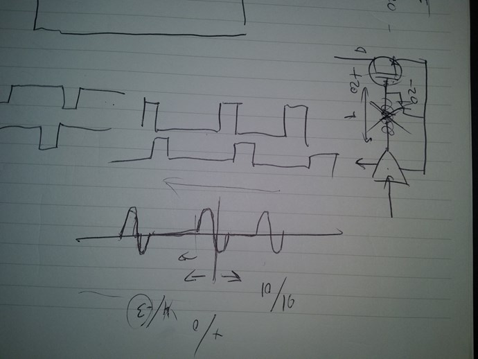

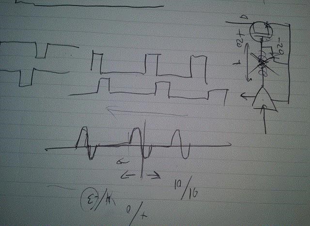

Question: How did Graham make the Right Side Partnered Output Coil always show the same polarity flip in Current? Why does the Current not Flip the other way sporadically?
Chris posted this 18 March 2019

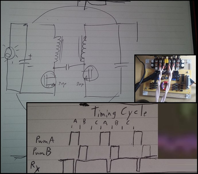

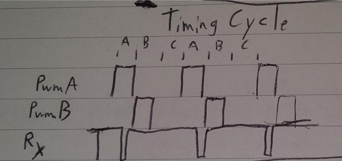

A little speculation with a little evidence:
I believe Graham Gunderson was using Step Switching on the Partnered Output Coils - What Do I Mean?
Two Output Coils, Two Mosfets on the Output. One Mosfet for Each Coil.
In the closeup I showed:
We see evidence for something which Graham did draw for Reiyuki, who kindly shared all his images. He was present at the conference and took lots of fantastic Images while there, he also asked Graham lots of questions. One Image is shown:
With another Image verifying this image:
My Question:
This is achieved by Step Switching the Output Mosfets as I have just shown. You will only find this information here! Other forums have tied this timing to the Input.
@Jagau - Hope you had a good time! It is an interesting subject!
@All:
It is worth noting, The MEG has this exact same Process, One Coil Conducts, then the other, Slapping Together. The setup I showed you also. This process is simply How Hard and How Fast the Waves can Slap Together:
Thus the title of this Thread: Delayed Conduction in Bucking Coils.
There is a pattern, and the pattern is always the same, the Partnered Output Coils must Buck, the Coils must be made to Buck, normally they would not as shown in the thread: Parallel Wire or Bifilar Coil Experiment, and the Currents are always equal and opposite! Methods to make this occur can vary as we have seen on this thread!
No other forum on the internet, as far as I am aware, shows you any of these techniques! This information is new, especially in such detail! Some, a select few, I believe, have known about this for a long time.
Jagau posted this 18 March 2019
Just a Chris question before going any further.
Is this scheme provided by Gunderson?
If yes this schema on the right is an IGBT not a mosfet.
And again the reverse diode is when the voltage goes from + to - is to increase the closing speed of the IGBT (+20 to -20 volts)
i mean diode between gate and emitter of IGBT
Apparently drawn by Graham at the Conference for Reiyuki.
Graham drew the same diagram here:
He used the term Mosfet in the video.
Hope this helps some.
Thank you Chris for the correction it is a mosfet no doubt.
It draws the intrinsic capacity of the mosfet so as to understand how the gate fires in relation to the source.
Moreover, he draws the intrinsic diode of the mosfet in a way that I did not know.
We learn every day.
And in addition it gives a little key design not heatink and when you listen well it's the key.
Chris posted this 19 March 2019

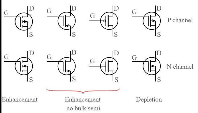

Isn't it silly how many symbols we have for the same thing:
MOSFET - Metal Oxide Semiconductor Field Effect Transistor
Ref: www.electronics-notes.com
I agree, if we don't learn something every day then perhaps the day has been wasted?
Jagau posted this 19 March 2019
Certainly Chris, that's why there is so much confusion in terms of the interpretations,
but most of the time when we look at the manufacturer's dasasheet,
it's the first two on top of the other that we see in datasheet
In addition the IGBT symbol looks like this
Even more confusion with mosfet.

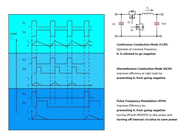

P.S: The image can be found with the article: Synchronous Switching Regulators.
Jagau posted this 21 March 2019

One half of the AC Sine wave can be seen as a half DC Wave, we use linear rectification units to achieve this from an AC Sine Source. We saw this here.
We must think of this DC half Sinusoidal wave as a pressure, or a Potential, or a bucket of water, the higher the Amplitude, the more the bucket is full!
The Partnered Output Coils require the same pressure, but this can not be achieved when there is no pressure to begin with!
Imagine: A Submarine, at the Surface its strong, sturdy, rigid! Go to 2000 meters, its ok, sturdy, go to 10,000 meters things start to creak and groan, and things get pretty scary especially if one hits rocks or something!
We must start from a positive pressure first, this is the Half AC, or DC sinusoidal wave form.
The more the bucket is full, the deeper a Diver can dive into the bucket. The more Pressure the Coils are exposed to, the Harder the Slap together they will have when the Linear Rectification Units time the Conductive Kick.
A Timed connection of the Partnered Output Coils is the Key! Grahams is shown above. Others, do not require this complexity, shown in the first post.
The Conductive Kick is the Waves Slapping together! Like this:
Above is the reason I said to go up close to saturation but not at saturation.
This Effect all happens as the Coils are suddenly connected ( Conduction ), at the right time, One Coil Conducts, then a split second later the other Coil Conducts. Delayed Conduction.
I hope this makes sense!

Input Measurements:
Output Measurements:
Vidura posted this 22 March 2019
Hey Chris, I understood the critical points of operation, My question is more about a detail of design of the MIT: How we can mantain the input voltage in a resonant tank citcuit at zero volt during part of the periode without damping the oscillation?
Chris posted this 22 March 2019
The Input is a measure of Load vs feed back.
For example, take a Transformer, measure with no load, then measure again with a load. Very different measurements! Phase angle especially will be very different depending how much one loads the transformer.
The Input is chopped DC, 50% duty cycle, from the H-Bridge: ( Top Waveform )
I like Cap Inductor in series, not so much in parallel. Not sure why, Parallel just feels wrong. The Input is assisted by the output, I have shown this before. Self Assisted Oscillation in a Shorted Coil - Bucking Magnetic Field Oscillation
That was way back in 2011. The Output assists the Input, one Coil works with the Input, remember we have three coils. There is no damping, there is an Assist.
See this video for a little more info: @ 4:05
A Positive Feed Back to the input.
So: 1 + -1 + 1 = 1 where as we would normally see: 1 + -1 = 0 nothing left over, all the Input Is consumed!
  • mrblobby
So the input signal section at zero voltage is due to the feedback from the POC, I got it , at least I think so. And I remembered that when Graham was asked about the operating frequency he pointed out that it was not at 50%duty, but something like 33.3%positive, 33.3%negative and 33.3%off. Otherwise at 50% duty square input this special wave shape would not likely resonate.
Yes you're right. 33% is divided up like so:
So we see, 33% each:
  • Red
  • Orange
  • Blue
Of course, a normal H-Bridge is 50% to get an RLC Tank Circuit to resonate. Graham Gunderson's MIT is a special case requiring Off Time, this Off Time just happens to be 1/3rd of the Cycle.
Where we see Off Time, we see an increase in Current amplitude:
Of course, this is a significant indicator that the Output Coils are feeding back Energy to the Input. Feed Back as Floyd Sweet told us.
There is so much information in these scope shots, much I have covered here that you will not find on other forums! We truly are Light Years Ahead of the other Forums!

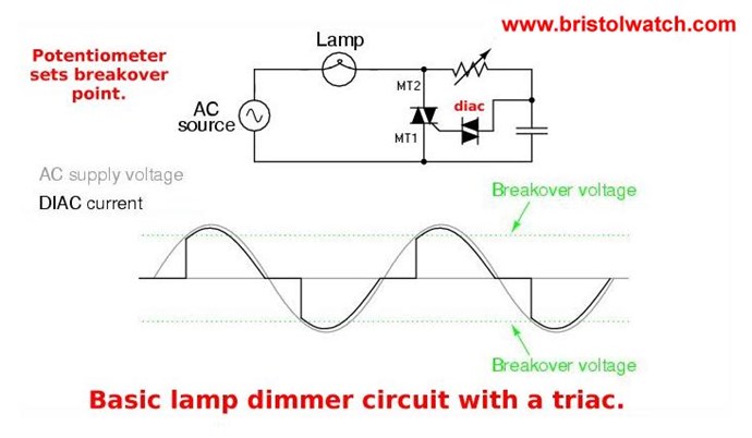

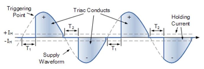

Don't forget, this is not the only way! A simple Light Dimmer Circuit can also give you the same results:
Of course, this Circuit is Bi-Directional. Also, importantly, you can adjust the timing of Conduction in Time t.
I pointed this out here.

this video is very informative and you add something new for me
about a zener between gate a drain of mosfet?

Hey Chris and all following,
Finally back at my workshop i made a test with the proposed delay circuit with the mosfets and zehner diode.
I built this with 18v zehner diode but it resulted in fast selfoscillations of the switch like this:
And the current (upper trace) kept trunked off instead of the desired delay. When thinking about it is due that the gate voltage colapses immediately when the mosfet becomes conductive and recovers at high frequency. With a NPN transistor it might perform better, I will do a try. For the mosfet a stable gatedrive supply will be needed.
Regards VIDURA.
Chris posted this 26 March 2019
Awesome work! The Classic Sawtooth Waveform, which we should see! Look what you have achieved:
Ref: The RT V3 - Above-Unity
Almost the exact same basic waveform! Well done!
Regards VIDURA.
@Vidura,
At all times the Voltage at the point of the Mosfet Drain, and the Cathode of the Zener Diode is greater than the rated Voltage, the Mosfet should be On. So the waveform may not be a true indication of Conductivity.
Some experiments with Inputs of a short pulse might be worth your while. Finding where the Zener is triggered and how long after the pulse the Ringing lasts.
Again, great work! This is a huge step forward! The Sawtooth wave is there, you have Nailed it! Nice!
P.S: How many turns on your POCoils? I would look at increasing the Turns Increasing your Inductance and this should decrease your optimum Frequency and Input Voltage.
Vidura posted this 27 March 2019
I used a 40 mm EE ferrite with 13turns  CW- CCW ot the outer legs, ten turns primary on the inner leg, the first triggering seems to be at 18 volts  as the zener diode, but the current of the positive halve wave fails to flow. the voltage was measured across the load(12v incandescent lamp) and the mosfet. I have made a test with a 13007  transistor instead of the mosfet, the effect of delay could be observed, but not always, only at higher powerlevels and certain frequency, and the transistor heats considerable, the voltage rise higher to around 30volts. Anyway the TVS, Varistors, GDT devices and also the sparkgap have considerable losses as well, but the gain of magnetic resonance should be far greater.
later ill make a test with another coilset with more inductance to compare results.
Chris posted this 27 March 2019
Cool, ok, yes I would increase Output turns to 20 or 30 turns if possible, input to 8 turns.
Drop the input voltage.
Add a Zener Diode for Gate Protection, with a slightly higher break over voltage: D2
Jagau posted this 27 March 2019
hi
In trying to protect a mosfet against a high energy transient coming from the drain such as from a large inductive load, we connect one or sometimes two zener diode between the gate and source in order not to exceed maximum ratings for Vgs (e.g. +/- 20V) .
We know a zener diode is already between drain and source du to structure of the mosfet.
What we meet very rarely is if we add a zener is between the drain and gate, it will turn the mosfet on so the majority of the energy pass from drain source .
During off time of mosfet,  Vz will keep mosfet on and no delay conduction occur i think? Because of low Vz
Am trying to understand?
Apologies, today has been busy.
I have corrected my mistake above.
Yes there is a reverse diode between the Drain and Source. The internal Mosfet protection Diode:
We are putting a Zener as a delayed Trigger from Mosfet Drain to Mosfet Gate. The Zener Diode Cathode is connected to the Mosfet Source, sensing the Voltage if you like. Yes I agree, there is a good requirement for a Gate protection Zener Diode.
I agree, and yes, the Mosfet should be off during the reverse bias from the coil.
I agree and from my simple experiments, not including capacitance of the Mosfet itself, the possible ringing of the arrangement, at high frequency, so, I suggest, stay at a low frequency.
