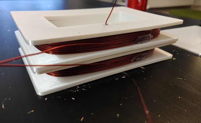

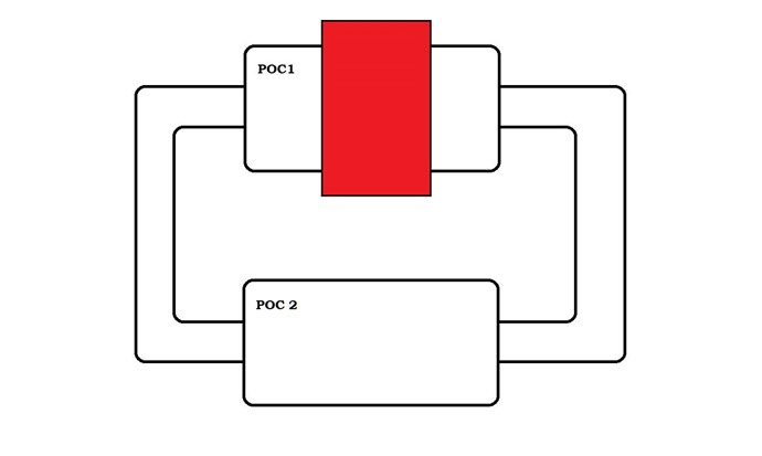

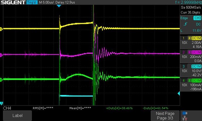

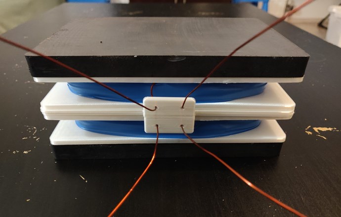

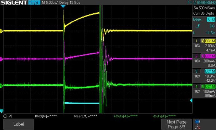

I'll start this thread more or less for my documentation and a bit of questioning. I've been reading a ton and going over the videos several times. However, I'm pretty sure I don't have this correct yet. And I'm pretty sure I'm starting to confuse myself. 🙂
L1 is the input, 20 turns clockwise of 0.8mm wire. It's wrapped over, the same direction clockwise, mutually inductive, to L2, which is 140 turns of 0.8mm wire. L3 is next to these, also 140 turns of 0.8mm wire, but wrapped counter clockwise. The lamp is on L2.

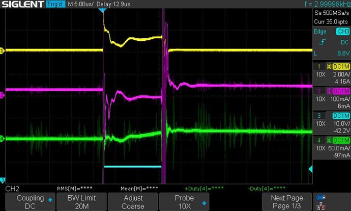

The pictures were taken at about 5.6 KHz, nevermind what the scope screenshot says, the counter was all over the place. I'm pulsing 12v from a power supply at 10% duty cycle. Yellow and purple traces are L2 and L3. L1 voltage is the blue trace.
The core makes horribly loud 8-bit video game music while I'm messing with frequency ranges, so I assume some bucking is taking place. But the scope shot doesn't look right, not sawtooth enough. I noticed comments on Madscientist's recent experiments about polarities and the exponential curve instead of sawtooth, but I believe I have my diodes correct. Still, not really seeing magnetic resonance I think.
Correct me here, I'm wrong somewhere I'm sure. The input coil raises the magnetic field, north pole to the left side as it's wound clockwise from the right. Current flows in L2, the same direction, and when L1 is turned off, what is left is the magnetic field which will want to collapse and create current the opposite direction, creating a north to the right side. But then the diode is wrong, as it would be blocking the current from the collapse. UNLESS, we see a flip of current polarity because of the magnetic resonance, Mr Preva. In that case, then we have the currents, and magnetic fields from L2 and L3 opposing, and we should see the sawtooth waveform. But I was under the, possibly ignorant, impression that the Mr Preva experiment worked because of the mismatch of coil turns, 7 to 11 I believe it was. But on these coils we want matching turns, in my case 140 to 140 turns, correct? Because we want matching magnetic fields when loads are applied, for a maximum fight against each other. Again, correct me if I'm wrong please.
So, again, I think I might be seeing a tiny bit of magnetic resonance, but not enough. I need to pick up a few new printed bobbins from a friend this week, but I will increase the turns on L2 and L3 to bring up the magnetic fields, maybe 200 or 250 turns to start. Also, I'll try to increase turns on L1 so more magnetic field is delivered. Maybe overdo that too a bit, so I can walk it down a few turns at a time to see what is best. In the meantime, any advice or pointers would be completely acceptable. 🙂
I'll update more soon. And this has been fun getting back to research, so thanks to everyone that has contributed.

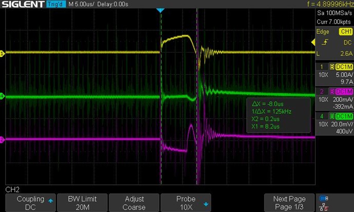

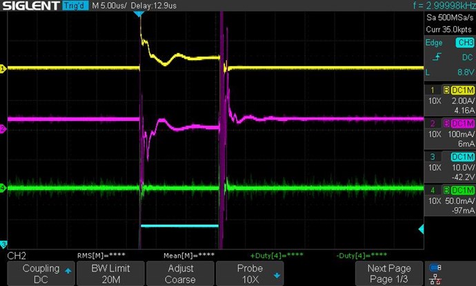

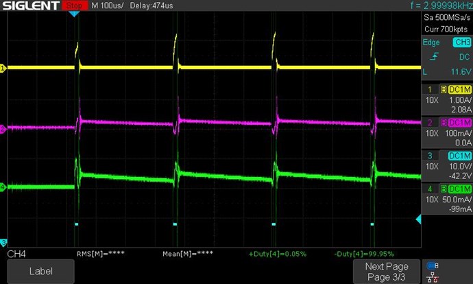

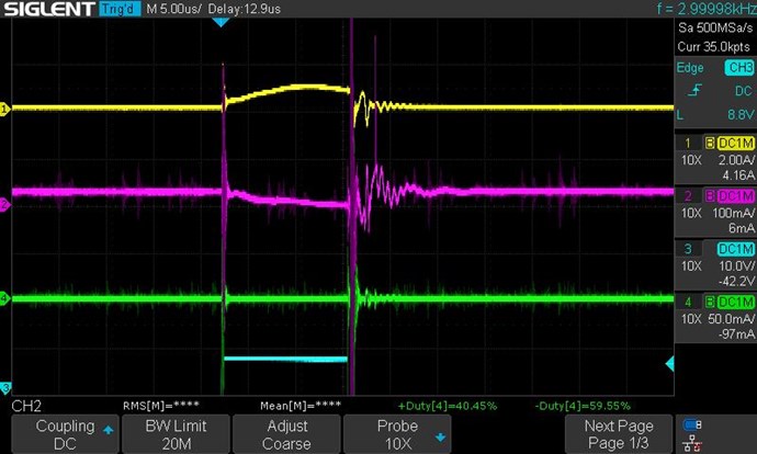

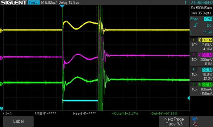

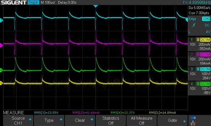

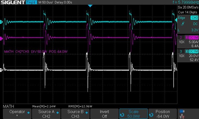

Concerning my setup, I got a little time yesterday to play around.
Adding identical loads on the POC coils, 55V 3W lamps, at that frequency of 5.8 KHz or so, instead of shorting POC2, results in more of an exponential drop and the voltages and currents are about 1/3 on POC2 of what they are on POC1. That alone is a bit confusing due to the fact that I have my diodes setup so that the input first interacts with POC2, then POC2 interacts with POC1.
From here, I noticed I could either play with different loads, or drop the frequency until the voltages and currents seemed to match. Dropping the frequency, down to about 2.1 KHz or so, just made the decay faster, more exponential. And I'm guessing I'm getting away from any resonance in the coils, so I stopped experimenting with that.
I then played around with different loads. I got a decent voltage and current match, at around 4.9 KHz, which if you remember was my open-end resonance frequency of the POC coils. So with a 240V 20W on POC1, and a 240V 15W on POC2, voltages were about equal, but current on POC2 was still about 1/3 . And the decay again was more exponential.
POC1 is blue(V) and purple(A), and POC2 is green(V) and yellow(A).
The input coil:
In this configuration input was around 2.14 W mean, POC1 1.5 W rms, and POC2 800 mW or so rms. No real improvement just yet assuming my measurements were clean.
But I may have some faulty components. Looking at the blue and purple trace above,  they swing negative quite a bit which I'm sure adds to the rms value of POC1. I took a scope shot, closeup, of the input current (yellow), POC2 current (green), and POC1 current (purple). This is the order that I have them set up to interact with each other.
The X cursors are the input time of 4% duty 4.9 KHz. So when the input fires off, POC2 in green should be climbing and it's not. POC1 in purple (which has the input wrapped around it) is being pushed down. On the other screenshot above it shows both V and A are negative. I would imagine the diode should be doing it's job here.
Anyhoo, sorry for the long post that really went nowhere lol 😂
I'm running to the hardware store later today to get a few new bulbs. Tomorrow I'll double check the hardware and give it another go.

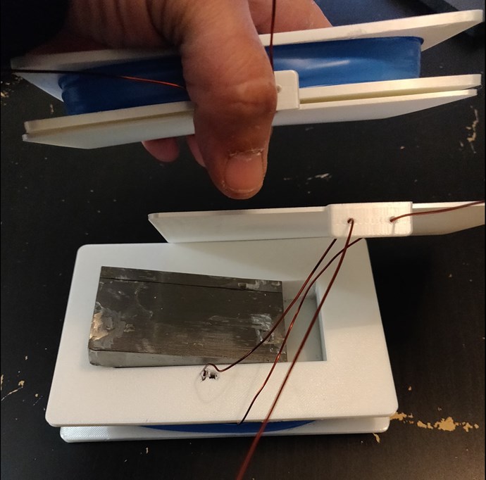

Hey Chris, looking for some advice.
I'd like to leave this thread as is, and move on to some other related experiments. But a few questions.
I was thinking of cutting my core to see if it makes any difference. But I'm wondering if you might know, or if there have been any experiments on, what difference it makes where the core is cut. For example, the Y axis in red under the coils, or the X axis in yellow equally between the coils.
I've read a little (somewhere) about where this bloch wall (middle of coils) vs the area where the fields meet (sides along X axis) might be, which is why I ask.
I'd also like to experiment with the input coil, different variations and positions. Not sure if I want to do this before or after the core cutting though.
Is there possibly something I should be looking at before I cut the core?

Chris posted this 26 January 2024
Hey Marcel,
There is a lot to it, Core Reluctance, Magnetic Field Inverse Square Law and more.
Yes, if the Coils are closer together, then you have more Electromagnetic Induction occur, but the core, once cut may exhibit more core leakage...
I would keep the core as is and experiment with another core.

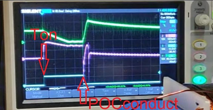

Hey!

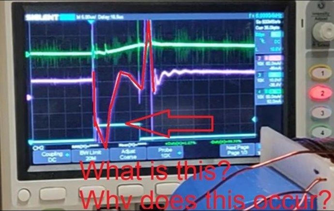

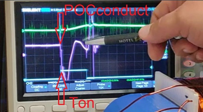

So I've been re-replicating this experiment with my new AMCC800B core because there were some other details I'd like to get back to. And there were some things I wanted to share that might have helped out @madscientist, though from his last video it looks like he figured it all out.
https://www.aboveunity.com/thread/madscientist-s-non-inductive-coil-replication/?order=all#comment-dc21820f-695f-444f-85e4-b1e800ceca25
Nice! I'll share anyway, maybe it's the same thing he ran into. Maybe this will help someone else.
First off, the specs:
  • AMCC800B Core
  • POC coils are 0.8 mm, 410 turns.
  • Input coil 25 turns of 1.2 mm.
  • The effect shown is at a 16% duty cycle, 12.5 KHz
  • 12 V on the input.
  • Load is a 34 V bulb.

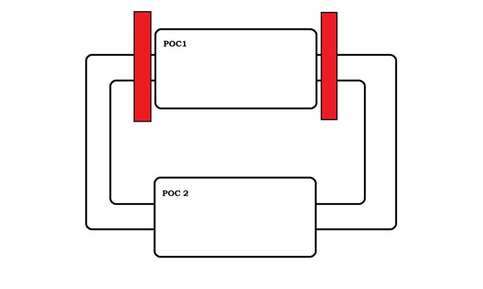

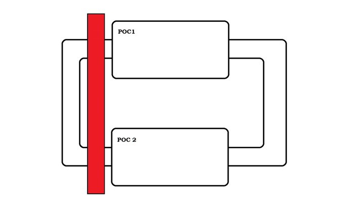

  • My setup, is again like last time, input coil opposing POC2, then POC2 opposing POC1. So POC1 assists the input, in this setup.
Input roughly 1W. Output roughly 1.2W on POC1. POC2 not measured.

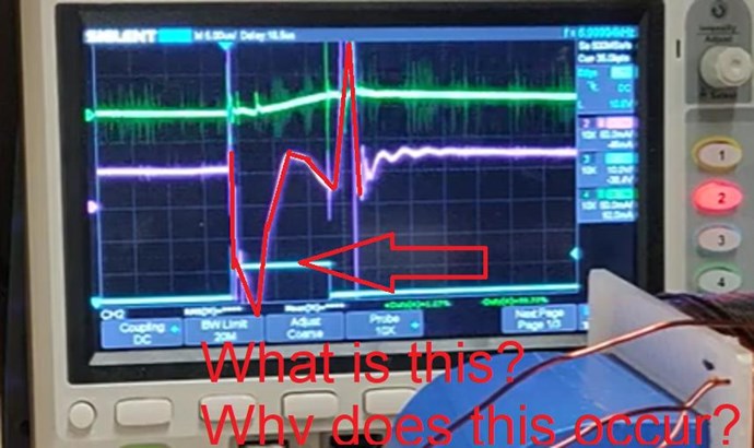

The main purpose for this video was to show something else though. At one point Madscientist and I were both having this issue where shorting POC2 would cause the bulb to dim, rather than get brighter. And the input would go up, rather than go down. Chris mentioned check polarities of diodes, etc. But I found, and wanted to share, that the opposite effect that we were seeing could also be brought about by the wrong frequency and/or wrong duty cycle. Please see the video here..
I'm not exactly sure why this happens. My immediate thought would be that we are dealing with setting up oscillations. And either those oscillations work together, or work against, each other, depending on the duty cycle and frequency.
Anyway, I'll keep this short. I'm going to continue to play around with this and just have a closer look at a few things. At some point I'll start moving on to the input coil, possibly an input coil that surrounds both POC coils so they are more equal and opposite to begin with.
Hope this helps someone!

Hei Marcel, interesting work, I have to clear something, I did not change the polarity of my diodes, i checked and confirmed it so I kept them as  in Chris's circuit.  I had seen different variations of this effect when connecting poc 2.
  • Sometimes input current goes up, and light brightens,
  • Sometimes input current goes up and light dims,
  • Sometimes input current drops and light dims,
  • Sometimes input current drops and light brightens.
The last statement is the correct effect Chris thanks for confirming that, so I have been concentrating on the last effect, Another thing, the effect on the bulb is more visible under a certain load range.   If I put a 12V  20W bulb, the bulb dims less when poc 2 is connected, I tried 1W, 5W and 10W bulbs, and found the 5W bulb to be the best at showing this effect.
In the video above i am using a 12V 5W lightbulb I hope this info shines more light on this effect. Otherwise good work on everything there nice big core you got there, as Chris said CSA will give better results.

FringeIdeas posted this 24 September 2024
Nice video! And thanks for sharing, and confirming I'm not crazy 😂
I'd have to say, Madscientist, I like your persistence and work ethic. Keep it up!

Yes, three things to improve this:
  1. Larger Cross Sectional Area
  2. Shorten the Length l, of the Partnered Output Coils POC.
  3. The above, 1 and 2, will give you the the ability to Reduce Turns N, and use thicker Wire Gauge AWG.
Keep in mind, we are Generating Voltages, and the Magnetic Fields Changing in Time t, is what makes this occur, so you need to stay around the 200 Turn mark.
My Friend, you are doing a really good job! Keep it up and don't give up, ever!

Hey Marcel,
My Friend, I am sorry, I missed your post Here.
I have now caught up and have left a comment on the video. This is excellent work and an excellent Build! Very nice My Friend!
I would keep this Build exactly where it is, do not change a thing, and just experiment here. Don't change Coil Turns or anything, leave it all where it is, and just document Diode Polarity Configurations.
You are right, the Propagation Delay in the Core can play a role.

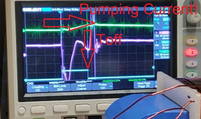

In some posts I talk about the Rise over Run, the Rise Time and the Decay Time on the Mosfet, we can adjust this and this can help in the POC Voltage Generation!!! Tom Bearden told us this:
@10:13
if I want to get a little bigger E Fields I make a sharper rise time and a sharper decay time I get an E Field one direction one time and the other and what happens is the space here I can have as many coils wound on this core as I wish.
You can see here, by observing the Slope:
Or we can focus on a specific Frequency and use a Half Sine Wave to do the same thing, covered in the thread: Utilizing a Single Shot Sinusoidal Pulse, to make this work. This is what Floyd Sweet did, making the VTA operate at 60Hz.
Remember: A Voltage is "Generated" and a Current is Pumped.
The Voltage is Generated via Faradays Law: E.M.F = -N ΔΦB / Δt which is, again, as Tom Bearden said: "if I want to get a little bigger E Fields I make a sharper rise time and a sharper decay time" because its all about the Change in Magnetic Field.
FringeIdeas posted this 26 September 2024
Ok, nice, that sounds like the direction I was thinking of going. I was just stumbling on the input coil again.
I need to check my switching a bit first. My highside driver TC4431, when on load, the duty cycle drifts smaller as I go up in frequency. Strange issue, I've never seen this before, but I'll figure this out and get back to machine.
As always, thanks for the information and direction!
FringeIdeas posted this 03 October 2024

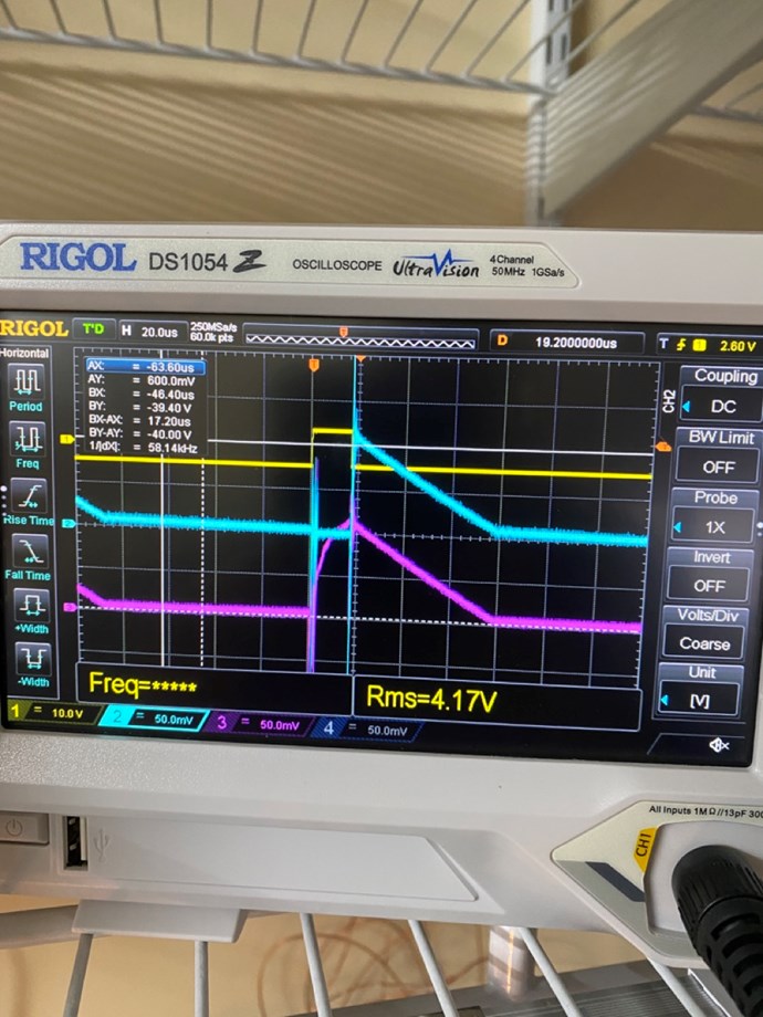

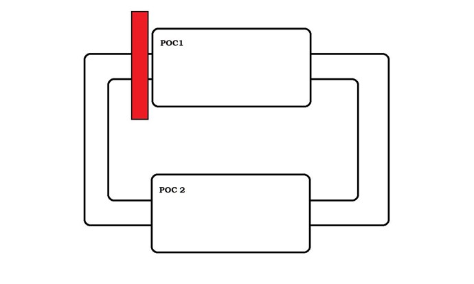

Ok, a little investigation into polarities.
I made a video and here are some points I cover.
I have mentioned before a few times that I feel I have something backwards, because it seems to me that my input coil during the rise time is interacting with POC2 and not POC1. And that with the way I have it configured it's the collapsing field interacting with POC1, then POC1 engaging and fighting with POC2. So in the video I just try to explain why I'm thinking this.
More importantly I wanted to show that depending on the direction of how the field from the input coil engages with the POC coil, a different input and output can be seen. The same idea as in the some coils buck and some coils don't experiment. https://www.aboveunity.com/thread/some-coils-buck-and-some-coils-dont/
So in the video I show one configuration where the induced voltage is positive on the outside layer of the POC coil. The output was about 1.15 W. I then switched the direction of the input coil, and the wires across the diodes on both POC coils. So essentially the same exact setup. The only difference being the induced voltage appears now at the inside layer. The output went up to around 1.25 W. Not a lot, but enough to show what I mean.
I did also forget to show in the video that the input drops in the better configuration. So we see better interaction between the coils, depending on how they are configured to function.
I think next I'll be playing with the rise time, trying to tune a bit.
Ok video, and I need to run. Thanks!

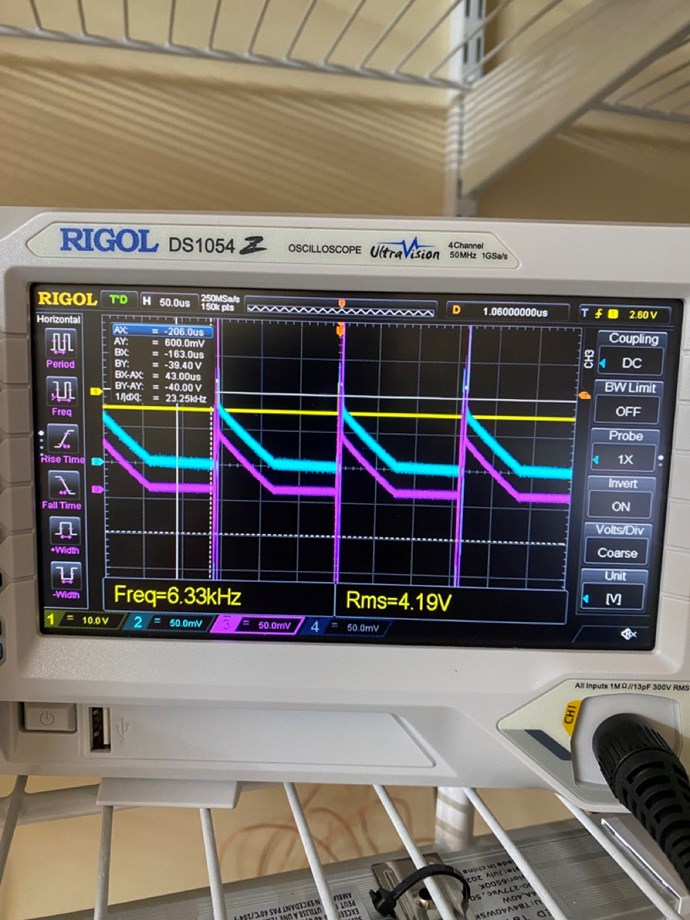

Scope Analysis:
Polarity One, shown in the video at approximately: 2 : 07.
This configuration uses the Input Coil Collapse to Generate a Voltage in the POC, and you can see, this is not an ideal Configuration, with Input being: 14.02 Volts and 0.307 Amps, roughly: 4.30414 Watts.
Polarity Two, shown in the video at approximately: 4 : 53.
This configuration uses the Input Coil Ramp Up to Generate a Voltage in the POC, and you can see, this is an ideal Configuration, with Input being: 14.02 Volts and 0.130 Amps, roughly: 1.8226 Watts.

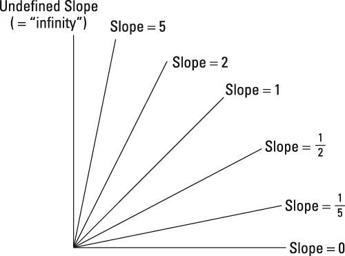

Rise over Run
The Rise over Run is the POC Slapping Together, this is where the POC Generate each others Voltage, this is the Time Rate of Change of the Magnetic Fields! Faradays Law dictates that this is how an E.M.F is Generated, via the Equation: E.M.F = -N ΔΦB / Δt, where the: ΔΦB / Δt is equivalent to the Time Rate of Change of the Magnetic Fields in this Machine!
Waveform that is hard to explain
Why do we get this Waveform? What causes it? Are both POC's doing this? If not, why not? There is a lot to be learned here!
With no Configuration changes to any of the Coils and Circuits, we must assume a Negative Resistance for a short period, because the Voltage goes negative, you can do the Math and analysis here for yourselves, but I would like to ask, Post your analysis, don't be shy!
Ohms Law gives us a clue here, if Voltage or Current goes Negative at any time, we must account for this:
Playing with a few equations:
  • R = V / I = R = -10 Volts / 0.2 Amps = -50 Ohms so, a Negative Resistance is seen at Point X of -50 Ohms, at a rough guess/approximation.
Here, you can see, we have a machine that is behaving outside the realms of Conventional Science, its Simple and its Cheap! You only need to take some time to understand these very simple things, to do the study and work to understand what they decided not to teach you in Class!

I still need to sit and really mull over what is going on here. I would completely agree that the configuration 2, as you point out, is the one we want to focus on. However, my brain is still seeing it backwards in regards to the POC coils coming up with the input rise time, vs, POC coils coming up on the collapsing field. But with my history of senior moments, the possibility of me not seeing something right in front of my face is likely.
Granted, I do see how in the scope shot in configuration 1 only POC1 (purple trace) is brought up, and POC2 (green trace) dies off. In configuration 2 they both come up during the input on-time. Anyway, porch time and a couple pints are scheduled. I'll handle it.
In regards to your question about what is happening during the rise time (config 2), "Waveform that is hard to explain".
My mind can't help but think about the reduced impedance effect. I'd be inclined to answer, yes both POC coils together cause this, but I'm not completely sure. So I'll put a bit of study into that again as well.
when setting up the diodes so that POC1 reacts to the input and POC2 reacting to POC1, I could not find the sawtooth wave form.....
I think I might have had it configured so that the input pushes POC 2, then POC 2 to POC 1.....
Hi Marcel! What a wonderful job of documentation! Reminds me of how I was documenting things earlier, but then stopped because something went off for me in my results.
Reading your note reminded me of exactly the same problem that I've been struggling with, and pondering on your comments gave me the correct insight which I have documented in detail on my thread here.
In brief, your thinking that the input pushes POC 2 is wrong. Obviously it cannot push a coil that is farther away more easily than a coil that is next to it. Actually, it is the negative spike on L1 that is pushing your POC 1 (coil L2) because it is so much higher in voltage that your input pulse.
So wiring L1 in reverse has the benefit of driving your POCs with a much higher voltage for free using the negative spike to "tickle" the POCs rather than "driving" them!
The rest of the discussion is in my thread where I have also suggested how we can modify and tune this spike for best results.
I look forward to more interesting results from you! 😁

FringeIdeas posted this 12 October 2024
Hey!
Chris, you said my "way of thinking may be a little unsure at the moment?". I think that is an understatement 😂
About ISLab's information.
I'll be completely open, I was thinking along the same lines as ISLab, and I am having trouble seeing it another way. Chris, when I read your scope analysis  above It's backwards from what my brain is seeing. This is what has been haunting me.
However, while reading through it a couple times, I noticed that you are not often referring to POC1 and POC2 individually, but often just say POC, like the two are one thing. My mind flashed to one of your videos, around 7:40, Understanding the Action, Reaction and Counter-Reaction in an Asymmetrical System.
You are referencing something Atti was doing, and you said that maybe it's a case of Atti not thinking about what the coils, currents, are doing as a whole. Related issue, or not, that got me thinking.
With that in mind, when I read your scope analysis, I do see in the bad configuration that the poc coils are not interacting together at the correct time. Only when the input coil collapses do we see both poc coils engage.
In configuration 2, the good one, I have no idea why L2 current drops negative like that.. I don't know yet anyway. With the diode in place that should not even be there.. BUT yes, shown by the traces, both poc coils are coming up at the same time, during the rise time. That cannot be argued.
So if we are looking at them as one system, then I would say your analysis does not look backwards to me anymore 😀
About the strange negative current
Again, I have absolutely no idea why this happens. And the current running in that direction, in my mind, should be impossible because of the diode. Either way, I've ran a couple quick experiments to get the ball rolling on understanding this.
At first my mind thought it was something the POC coils were doing together. So.. I started with a screenshot of the rise time, normal setup.
Input current (yellow), POC1 current (purple), POC2 current(green)
So there in purple we see POC1 having that strange negative kick.
In the next picture here, to see if it had anything to do with POC2, I completely removed POC2 from the core. So this is only with the input coil on top of POC1, nothing else on the core.
The negative drop is still there and almost identical. So, no, I'm now going with the idea that this negative kick is not part of the interaction between POC coils.
Then I took it a step further. I would a separate 20 turn input coil to the side of POC1, instead of using the one wound on top of POC1.
Still some oscillations, but the negative drop and steady climb, is gone.
So. Still.. no idea what is going on here 😂 But, this is interesting. It appears to be input coil related. Bloch wall collisions?

There are two Phases to POC, Rise to Peak Voltage, and Decay, from Peak Voltage to Zero Voltage, shown here.
The Green Phase, above, is the Voltage Generation Phase. Voltage is Generated in your POC, because of Faradays Law. That's why you must always have POC Loaded! More Voltage Generated, the more Current is Pumped on the Output.
The Decay Phase is the Pump:
The study of this is important, I have tried to encourage this study, for a long time, but no one seems to study this important criteria.
ISLab's work has always been important, but I have to be honest when I see something wrong, or I would not be doing my job. I respect ISLab and love to see his progress, and the same goes for all here.
It all becomes much more simple to understand when one understands the Electric Generator and how it works.

All configurations have the POC coils set up in the standard way (opposing each other), with diodes standard, a load on POC1 with POC2 shorted. An input coil of 20 turns, being pulsed in the standard polarity, with the same 10V pulse, 3KHz, 4% duty cycle.
Configuration 1:
Input coil wound standard over POC1. Note the negative dip, and the input current seem to interact together.
Configuration 2:
Input coil in the same position but with POC2 removed from the core. This was to identify if the POC1 negative dip was caused by interactions with POC2. It seemed to make no difference with POC2 removed.
Configuration 3:
Input coil moved to the outside of POC1, with POC2 placed back on the core. This, and the next configuration, kind of came from the idea of maybe there was something going on with the bloch wall of the input coil being in the same place as the bloch wall of POC1. With this input coil placement we do see the negative dip disappear.
Configuration 4:
Here I continued the input coil to the other side of POC1 as well. So input coil on both sides with magnetic vectors pointing the same way. Like two magnets, NSNS. In theory, and I'm not up to par on my bloch wall studies, but this should have a bloch wall developed in the center of the POC coil, just as if the input coil was right on top of the POC. Yet, still no negative dip on this one.
Configuration 5:
This has the input coil wrapped around the whole core, directly over POC1 and POC2. Just for observation, I was curious. And curiously enough, the negative swing comes up for both POC coils. And both seem to be interacting with the input coil in the same manner.
Configuration 6:
I moved the input coil off to the side, again just for observation of anything interesting. The negative swing disappeared for both POC1 and POC2.
Trigger scope shot:
This was just again for fun, observation. I wanted to trigger a scope shot on the first pulse going into the system when it's turned on, just to see if there needed to be a pre-established condition on the POC coils before this negative swing takes place. And it's a bit hard to make out here because I wanted to capture a few cycles, but it seems the negative dip is there on the first pulse, although maybe not as pronounced.
Thoughts:
So, with these configurations it seems that the negative swing is occurring between the input coil, and any coil that is skin to skin with the input coil. Parallel wire type interactions.
I'll leave it at that though, because I really don't have any deep thoughts on this at the moment. I'm not even sure if this is behavior that we want in the machine or not. Going to take some porch time with it.
Again, I hope this was not a waste of time. If it's in the correct direction then awesome. If not, then I know one more direction I should not go. 😀

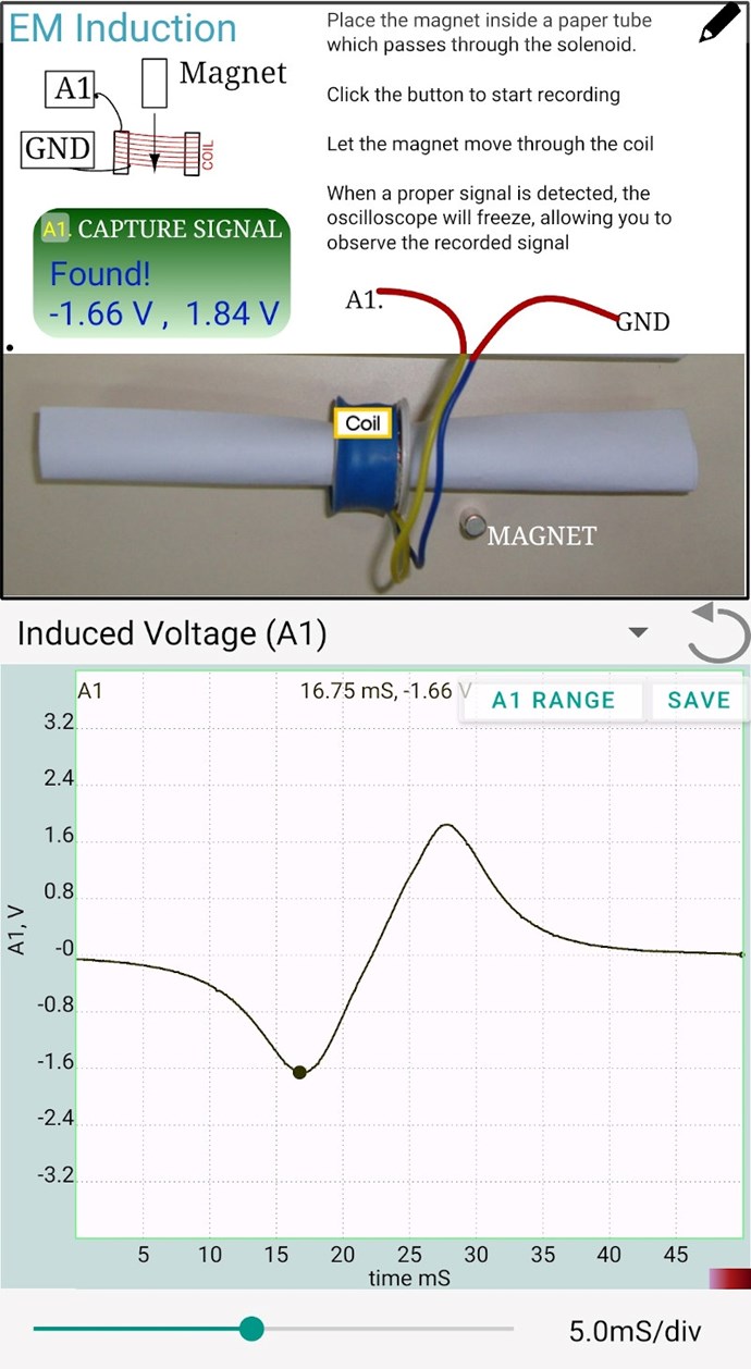

The Negative swing can often be seen in an Electric Generator, for example:
Ref: https://expeyes.in/experiments/school-level/em-induction.html
This is a tell tail signature of Electromagnetic Induction, a very easy way to see if the Coils are in fact: "Generating" Electrical Energy!
This swing is related to the Induction Cycle, and the phase that the Coil is Exposed to.
The question remains: "Is this what we are observing in our setup?"

Chris! Here is a build update.
I was going to say that mine looks better than yours, but my 3mm 3d print started bulging a bit toward the end and the winding got a little out of control.. You got lucky.
So this is just a replication of what Chris had shown here, and later posts, https://www.aboveunity.com/thread/non-inductive-experiment/?order=all#comment-f5bd3052-e3a8-44e2-a463-b1fd00174a5a
I liked the gap and the large cross sectional area, and I have to start learning about what the magnets contribute to these machines, so I decided to at least start putting together this build for future experiments. Here are the specs:
  • 0.8 mm wire, each coil is 250 turns, CW and CCW wound.
  • 3 mm gap in between the coils.
  • 3 mm gap between each magnet and its adjacent coil.
  • CSA is about 54 mm x 105 mm.
  • Coils length is about 14 mm or so.
  • Magnets are 150x102x12 mm (I also have a few 150x102x25 mm magnets).
  • The core material is taken from a microwave oven transformer, hacked to pieces.
  • No input coil yet.
Here are a few pictures.
I still need to epoxy a few things together but it turned out quite nice I would say.
And like I said, this was just a build update. I don't plan on diving into this just yet, as there are a few things I'm still playing with over in the Melnicheko thread, in which I'll probably post some experiments soon. But I will get back to this as soon as I can, as well as the few loose ends that I still have in this thread. The wife took the kids on a short vacation to see family, so for the rest of the week I should be able to get some experiments done. Let's see.
Chris posted this 20 February 2025
Hey Marcel,
Thats beautiful! Thanks for sharing!
This is a very valuable experiment! You can experiment with Open Cores, High Reluctance, No Cores, with the same Reluctance, and even use a C Core to close the Gap and reduce the Reluctance.
With Iron Laminate cores, the Frequency will need to be lower, but this is obvious!
