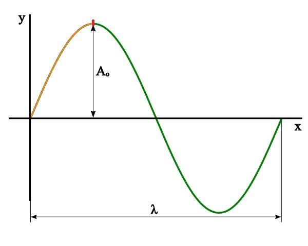

P>S: Thinking in terms of Magnetic Resonance - Not DC Pulsing as a Sine Wave
This might sound a little out there, and may not be an entirely correct way to think of this, but, Imagine a piece of Wire, it has a length equal to X - 10 meters as an example.
The length of wire is the Length of the Orange + Green portions of the Sine Wave, we are viewing the wire as a Wave, like so:
So, the Orange length is 10 * 0.25 = 2.5, and the Green portion is 10 * 0.75 = 7.5 and we have 2.5 + 7.5 = 10
The Red marker is the point where the Wire length is Centre Tapped, this is the point where we switch in out In Pulse. Typically a Diode(s) is placed here, to stop Electromagnetic Induction at the wrong time.
The On pulse must be short, have the right Duty Cycle and Time Constant, measuring the Input Current can determine this if necessary. You can get an idea by viewing the wave, Approximately 0.25 or 25% Duty Cycle, the Current ramps similar to the shape of the Orange Wave Form. We have Maximum Magnetic Field for the Input Power Supplied, now its time to Use It...
Then, with some fiddling, following this sort of idea, making sure the Input is not loaded when the Output is Loaded, you will see gains in Electrical Power, "Generated" by means of Asymmetrical Electromagnetic Induction.
We must force our brains to think about Electromagnetic Induction and not allow Brute Force to take over. Inducing Currents is the Key here. Magnetic Resonance.

Hi, Chris! I think you wish to make us think about using Electromagnetic Induction as a mirror, to reflect a wave such that it adds with the wave that produced it.
However, I don't quite understand how to practically apply the relationship between the length of the wire, wavelength, frequency and DTC. I'll keep thinking and reading.
There is a big question in my head: why Akula used 0.025% DTC with frequency 256 Hz for the length of the wire he is using. How did he come to these numbers?

Hey CD - Coils, Currents, Magnetic Fields and Time are all related - This is Electromagnetic Induction.
One Quarter Wavelength, λ * 0.25, or 25% Duty Cycle of the Current Wave Form is Peak Magnetic Field.
Three Quarter's of the Wavelength is also Peak Magnetic Field, but this is irrelevant, its not used.
In a DC Circuit, the Current in a Coil takes time to reach its maximum, this is normally 5 Time Constants, at this point the Magnetic Field is also at Maximum for the Voltage applied.
Keeping the Voltage applied any longer than this is not bennificial if one is only requiring the Magnetic Field.
The wave length and length of the wire have a relationship, now I am still learning so I encourage you to cross reference and check what I say, but, Energy, if impeded by a Miss-Matched wavelength, will reflect and as a result less power will be available on the output:
The above videos are meant to tie in with the Picture I posted:
I know your calculations resulted with a figure of: 0.025, there may be a harmonic used at this frequency, but the concepts apply. Remember, Akula was a Radio Electronics man, I think something like 9 years in the Radio Electronics arena. So he knew all about this stuff.
Others, Floyd Sweet and Don Smith, no doubt more, knew about this also.

About L1:L2 lenght ratio (Hooper/Tesla ratio) i have an idea, why don't you try Golden inductance ratio GL=1,618:1. I think it is crucial ratio for pure magnetic resonance, because have roots in etheric resonance/s.
