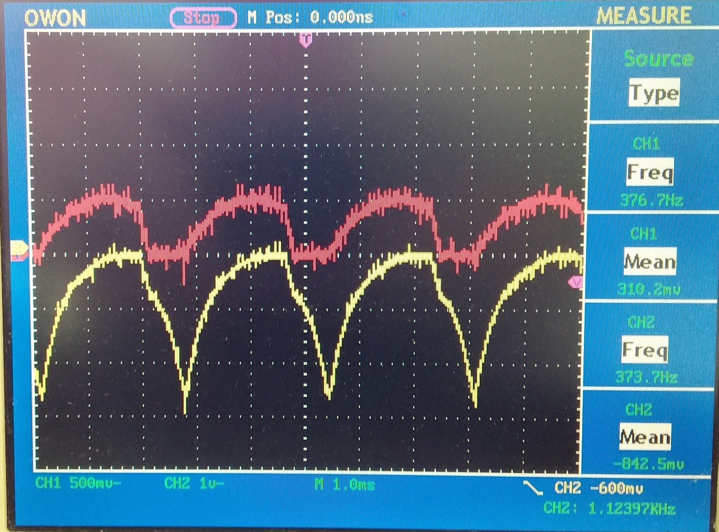

I should mention, when I have said Currents Equal and Opposite, be carefull of the Turns and the Timing of the Circuit.
Often what appears on the scope, may be completely different from what you may expect! As an example:
The above image has a 31% On time, seen partly on the Red Trace Zero Graticle Line, all the rest is off time. None of the Currents are inverted!
Take special note of the very large Negative Current on the Yellow Trace! It almost appears as if the Current on the Yellow Trace is moving backward in Time ( t ).
These currents were only supplied from a 400 ma supply, the total on the scope is: 1152.7 Amperes.
So take your time and study carefully!

cd_sharp posted this 06 June 2018
Is this obtained using the same exact circuit?
The so called "time-reversed wave" that nobody knew what it means except Bearden.

A slightly different Circuit, Akula style. I can see, that you can see whats going on here now!
I am so happy that others are picking up the ball and running!
For others following, LL is Inductive ( L ) Inductive ( L ), basically this is where the Partnered Output Coils are showing Magnetic Resonance.
Great Work CD! I am very pleased your'e getting good results!
P.S: My Sharp Peaks, also i am saturated at this point.

Your wave is perfect. What you see on the Yellow Trace is Current Ramp Up ( Storage ) and Ramp Down ( Decay ):
The reason you're seeing this, is because your Current Sensing Resistors are on the other side of your Input.
So you're seeing your Input as well as your Output. To resolve this and only see Output.
You can see Current Sensing Resistor R1 will not see the Input Current, only Output Current. This will give you the same Yellow Trace Waveform. Other than this, your Wave forms are perfect!
CD, you should be extremely proud of yourself! As you said, a lot is already learned. And the most important part!
Yes you're correct, your Coils have become a Battery! The Interactions between them are now Supplying Current in Excess of what was supplied to them! This is am amazing fact, something that 99% of Physicists could not explain!

Hi, guys! There is another question in my head about this circuit: why is the output voltage so low and how can we make it grow?
My guess is the voltage is low because we are using only the decay phase of the input current.
Can we do anything about it? Can we really light some usable load, like a 21 W bulb with this circuit?
The bigger bulb is a 21 W, the other one is 5 W. Here are the currents (L1 current is yellow, L2 current is blue, input voltage is magenta):
Now why do we see such a constant current on the blue trace?
The only thing I can think of is that it's because the power supply limits the current to about 2.2 amps in this case.
The setup is 32 turns L1 (the yellow wire), 176 turns L2 (the brown wire, hardly visible because it's wound under L1).
L2 wire is 4 times longer than the L1 wire.
The blue coil is disconnected, it's for another experiment. One more thing, the MOSFET is mounted on an active cooling system from an old laptop, otherwise I'm pretty sure I would have seen smoke laughing.
Please let me know your thoughts!

Chris posted this 12 August 2018
@CD - Apologies, I have a big job on the go atm.
Voltage is a product of the Rate of Change of the Magnetic Field.
The Magnetic Field changes very slowly in these setups, so the Rate at which the Magnetic Field changes is slow, this is the Triangle or Sawtooth wave. A Linear fall in time.
To make the Voltage start off High, we must give it a good sharp pulse, or use Electromagnetic Induction to the best of our ability, which is CSA Magnetic Field and Turns.
Something one could try is a small delay switch on one of the Coils.
They then will slap together harder, inducing a higher Voltage. many ways can achieve this result.
