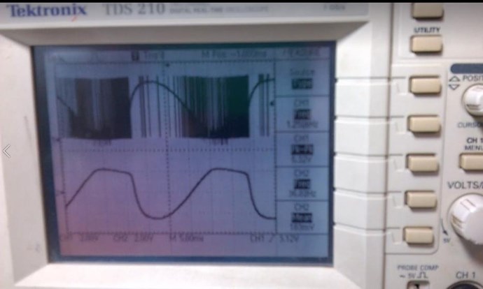

they don’t burn, but we have a voltage going on here goes 19 hertz 19 hertz is going on I'm not talking about what signals of their time and about his time about everything else I have no right we go to this spoon 1910 the power goes 2 and 6 volts and what do we see in our coils in our coils we see here the signal that the vadik showed, but I have it a little stronger since I’m just not the first time to assemble this design with a similar design so I have more serious fronts, that is, we feed 2 and 6 volts and we see that the pure moreover, we supply 2 and 6 volts and a frequency of 19 hertz, but this the transistor and what we see undamped oscillations, our coil, together with pyrite, it buzzes and at a cleanliness of 293 it becomes a little wrong this is 290 kilohertz here are our non-damped oscillations, that is, this is the beam now it’s on the collector then on the collector of this transistor it’s just we see our 19 hertz the whole set of work of the ether of a given coil design in automatic undamped oscillations oh well, now I think I’ll show the operation of the voltage, that is, now I will increase the supply voltage to That operation of our voltage stabilizer before they work on the diodes light up, that is, you can now add a little bit so 2 of 6 here are 2 and 6 and our LEDs are on, they light up and two of our undamped oscillations became even more than 10 volts here on the collector undamped oscillations with the frequency of the resonance firm and the overall design turned out to be 10 volts, that is, in principle, the record itself can now be made even without this generator, well, it is necessary for stabilization, since we have a load, there are nights, I can say wadik For you, but great successes, good luck, I’m glad that in just about a year and a half I see a person who with his own mind reached it with his own hands, launched the scheme, was able to stabilize this process and get the scheme so-called free energy, I won’t even collect the scheme for all unbelievers and bitches can consult with the author, he will tell you that this is the true work of this device to tell you more too I have no right do not be offended by all the questions to the author of this scheme, but a very original solution is generally very original Inalnaya, but only with this original solution we need to slightly change the design, that is, Vadik I can say for sure because this is not the first time I have assembled this design for such power and there are two but three LEDs in which your mistake was, it’s purely you will understand only you were the mistake in that you have two LEDs, but I didn’t actually consider it, maybe I didn’t see it, I don’t know, but I couldn’t turn up the power because you had two LEDs in parallel, you need to sequentially and here, at the output, raise a little voltage yes, of course, your return line will start up well and that’s all, but also what can I say? This is a microcircuit of working with this transistor that eats a lot, just eats the power of one of the LEDs, that is, it can be replaced with a simple multivibrator, it will be much more economical to form of what is needed here precisely with this generator, well, guys, see the free energy, he’s so very glad I’ll be talking with you, maybe even work together so that you don’t see something I even know a new share something very glad I will talk to you and indeed to discuss something interesting for the future, we
The Video Transcript:
so well, what’s happened, I’ll show it’s most interesting, it’s not loving now, it’s not working at all yet, I haven’t completely caught up with all the signals, tested the working principle of forming a low-frequency resonance in seconds, that is, our face of cultures is output and this capacitor is what we have here it is here it is so here we have a series of bursts of pulses from them we see the low-frequency component and what’s actually looking for this thing is f**king erase three monsters I’ll rewind the general resonance of the fer Rita does not match for the formation of a low-frequency sinusoid I can’t raise the power then you have it for the last time I’ll be holy he would understand now we are looking for this one now it works like this

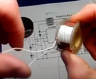

Observing the approximate lengths, where each unwind is approximately an arms length, about one meter, we get the following lengths:
23 arm lengths
26 arm lengths

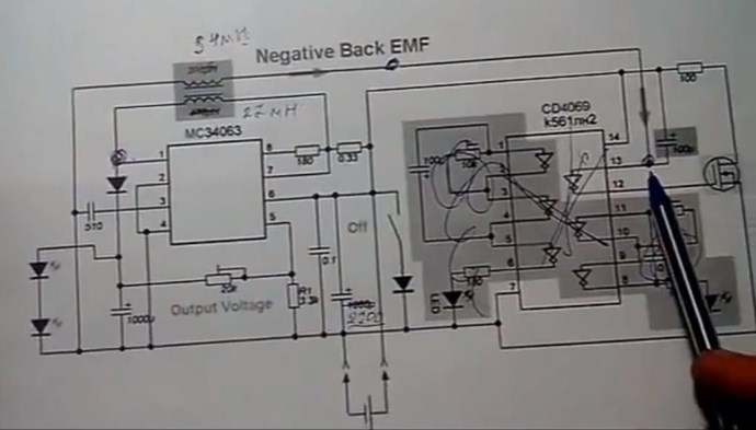

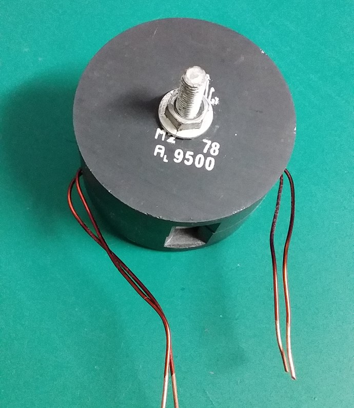

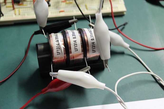

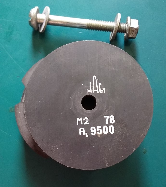

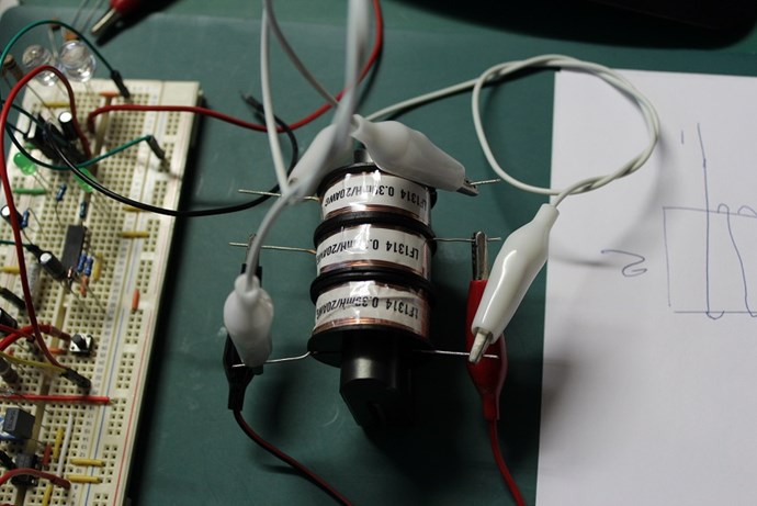

I have a Pot Core, one that you have seen before:

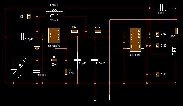

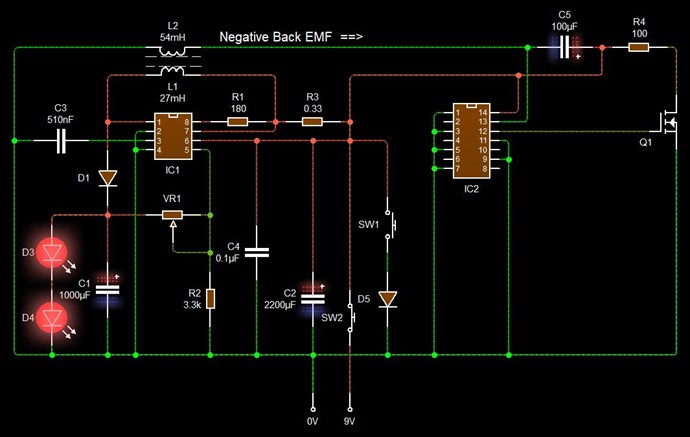

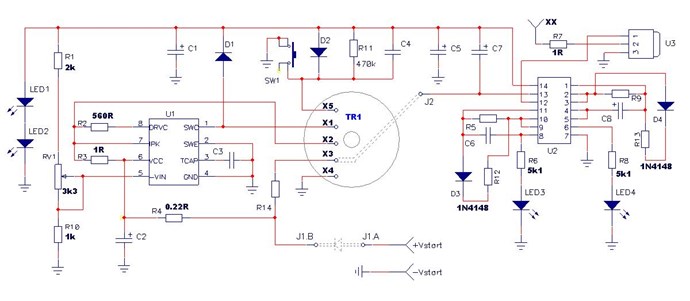

I have drawn the circuit and have the following design:
This is just a start. Any changes / improvements will be incorporated and a new circuit may be shown at a later date. This is a copy of Akula's Circuit:

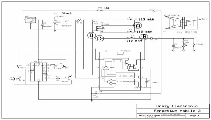

Which was a copy of Andrey Melnichenko's Circuit:

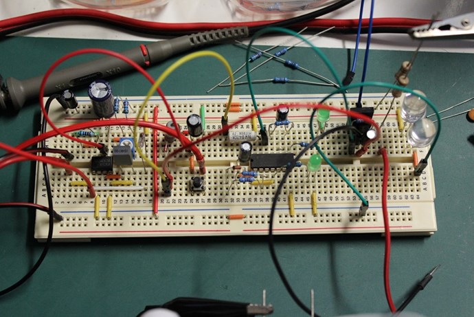

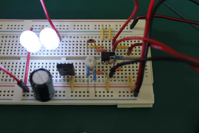

I have replicated this before, on the breadboard. I have had some successes with this circuit, but I thought I would make this a bit more evolved to show others. To try to help others advance! However, I can only do so much, I cant do it all for you! You need to so this for yourself!

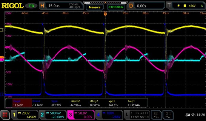

Equal and Opposite
I am going to continue harping on about the basics: Equal and Opposite!
NOTE: The above schematic from Akula, he drew with pen, big dots, above. Each dot is a Test Point, where the Oscilloscope measures the Voltage at each point.
NOTE: The AC Voltage is equal and Opposite:
Also Note: The bottom waveform has a goodly degree of DC Offset!

Here is the Circuit I drew:
I copied Akula's Circuit:
Its a start, and what I based my last experiments on. It may change at any time.

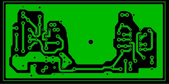

Chris posted this 02 March 2020

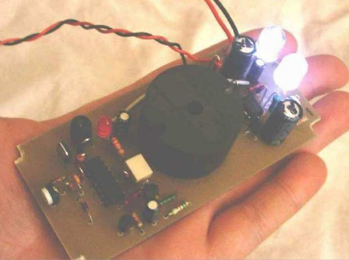

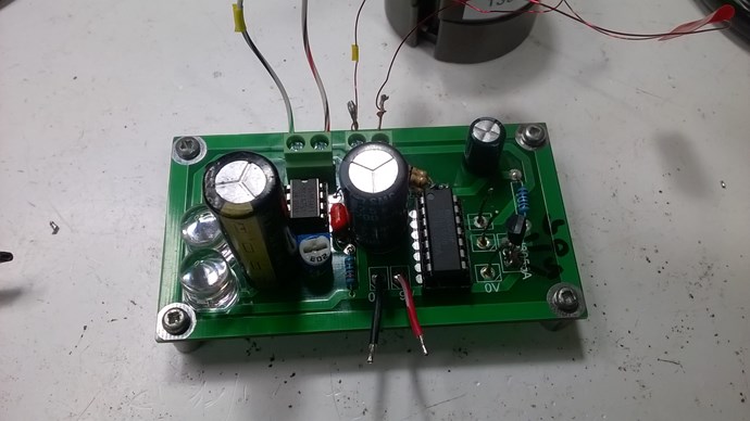

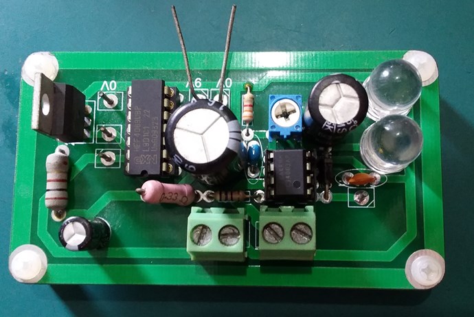

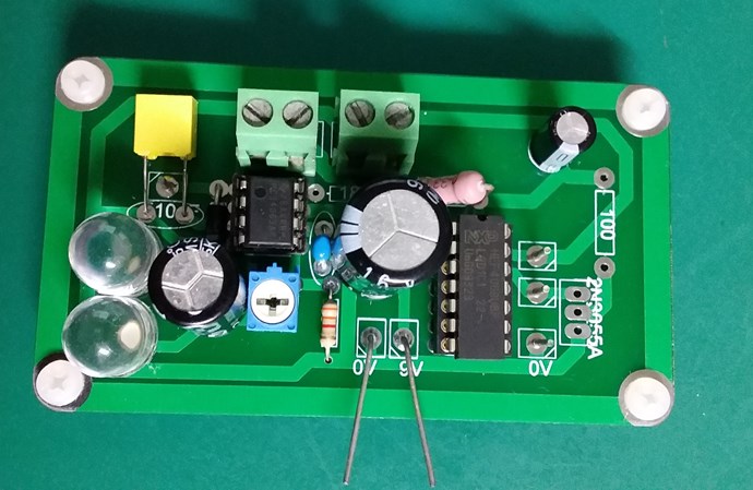

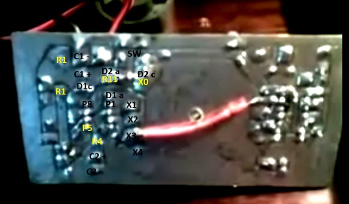

I have a little progress on the PCB:
Still a work in progress as you can see.

Hi Chris, could you post details about the integrated circuits used and about the characteristics of the LEDs?
Chris posted this 07 March 2020
Hey Fighter,

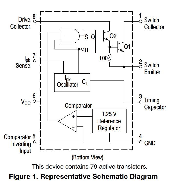

Yes, of course. this is a basic parts list:
I copied from this circuit:
The MC34063 Datasheet is here. The CD4069 Datasheet is here. Just use any LED's you want, I use 10mm White LED's and shave a little off one side, so they fit to the PCB, I have a very tight fitting PCB designed.

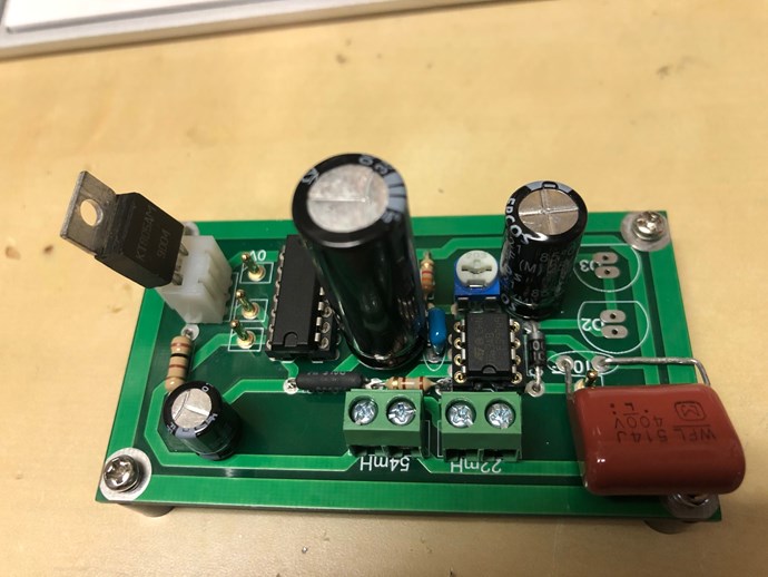

Captainloz posted this 28 March 2020

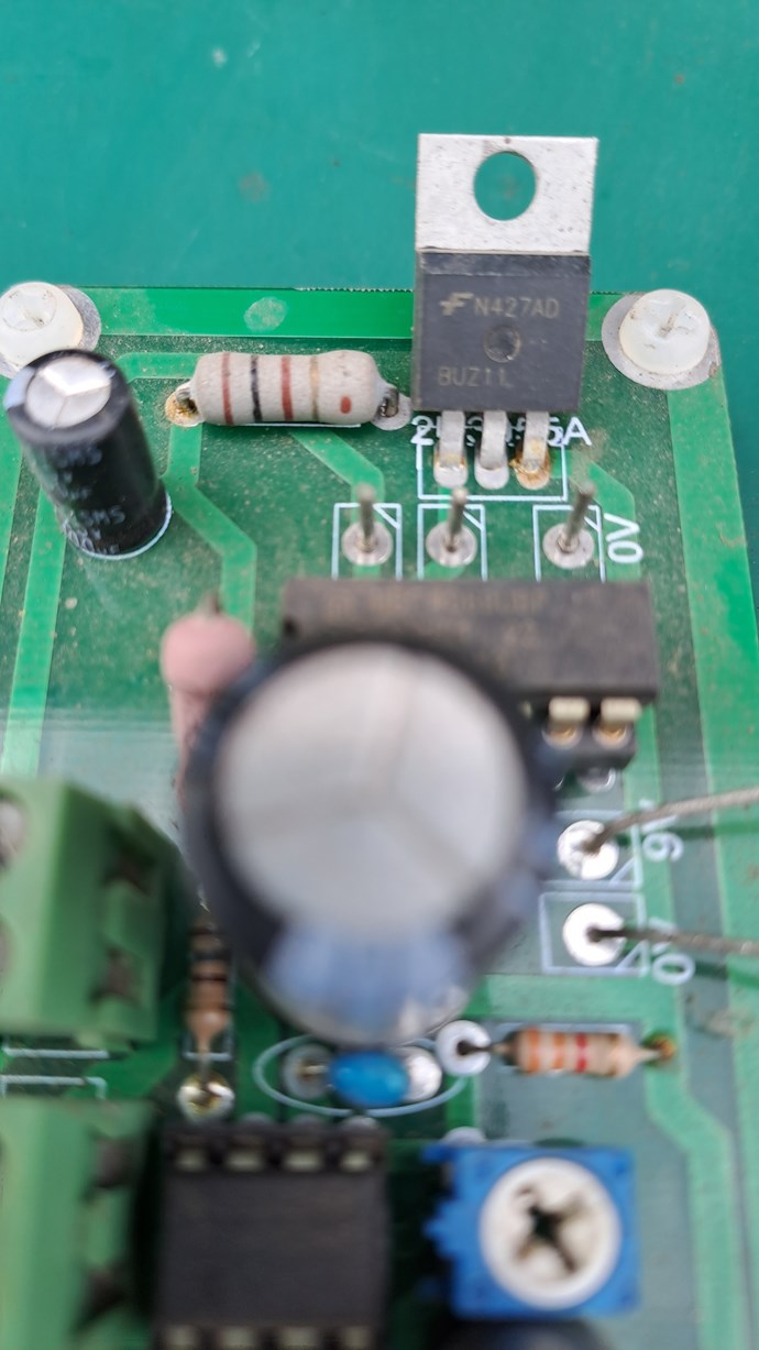

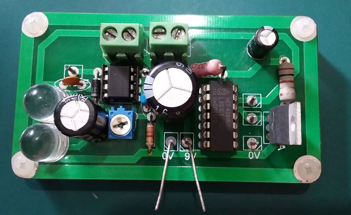

I got side tracked with this. I just couldn't resist. Making a little headway, just waiting on parts to finish. Looking forward to experimenting with it!  Cheers mate

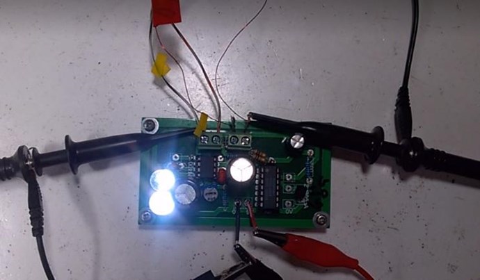

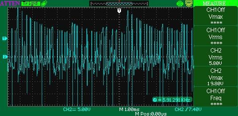

I little more progress. Just playing around to see the circuit working on the scope. I'm still waiting for my bobbin to arrive.  Will post another video once I get it done.
Chris posted this 07 April 2020
Hey Loz,
Nice Work! Thanks for sharing!

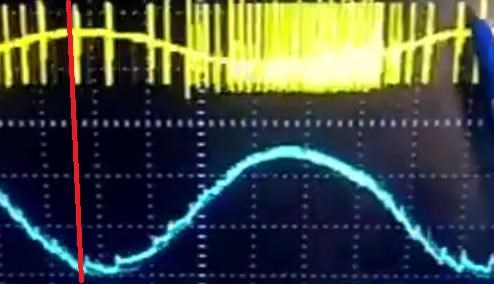

Jagau posted this 10 May 2020
Hi chris and captainloz
I did with you for this beautiful project.
Connect on P.S.

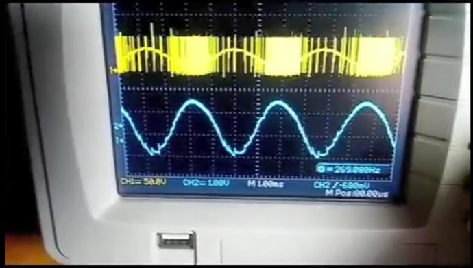

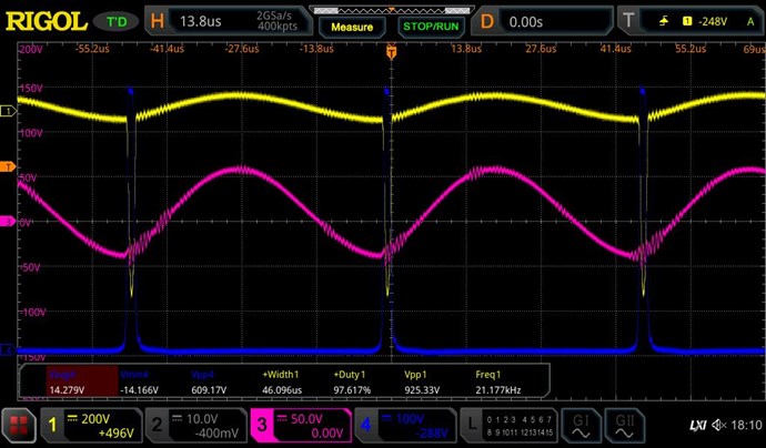

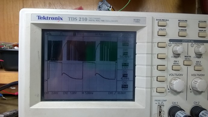

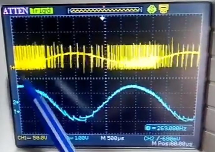

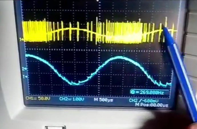

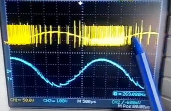

After mounting the components and winding up the potcore I got this figure on my oscilloscope.

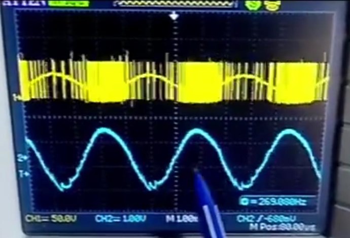

Compare to Akula
The frequency of the bottom is not good it is only 37 kertz I think Akula had 269 so it's not finished.

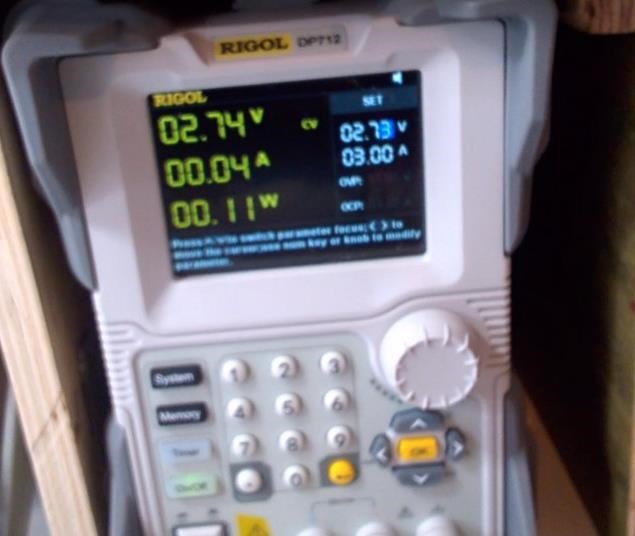

The CD4069 with this photo on the mosfet gate 2n7000 (down waveform) but it is too slow and too dirty so work to do on this side.
the precise operating voltage is 2.74 volts
Tell me how you made this circuit and what kind of figure you got so that we can combine our efforts.
You have made a great board Chris, thank you

Optimizing the interactions between the Coils and making sure the right polarity is involved, then this machine can run itself.
He always did refuse to put inside a Faraday Cage, I asked on many occasions, he did not, only claiming Radio Station was powering it, the problem could have been very easily resolved if he had listened.
This was shown in the original Videos: Video 2

Sorry , but but I do not use any reference signal like this guys does to produce this image in all his Utube that you showed.
What I posted here. It is neither a montage nor a fake.
The image you saw is very real and is produced only by the way the potcore was made and no function generator connected,.
I'm going to make a video instead of a photo to demonstrate it, you can judge for yourself what I did. I would never dare to fool people here,

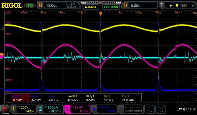

The low frequency component is present only when the 2 copper strips are connected to the first coil only, they act as capacitors and magnetic gap. To have tried different mounting this one is the most effective to date. The lowest voltage and power obtained is from 2.03 volts as you will see in the video.
Work remains to be done to increase the low frequency to around 270 hertz, then adjust the mosfet which should act as a pump recharging the primary capacitor in order to produce a selfrunner.

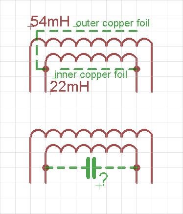

In one video, the diagram shows that one foil is connected to one coil and the other foil is connected to the other coil, see the picture below.
coil_01
If you watch carefully the video where the coil is disassembled, you can see where the copper foils are connected, both foils are connected to a coil of 22 mH. This would mean that it is a parallel capacitor that is not shown in the diagram.
coil_02
coil_02_1

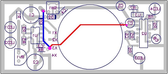

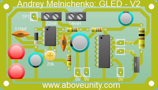

Hi Team

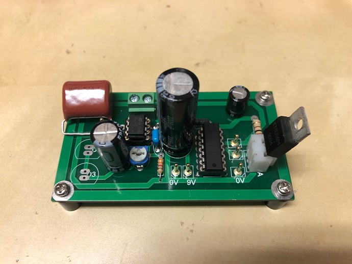

I am working on this GLED build and thought while I was waiting on some suitable cores would also order some boards from JLC. Would any one happen to have a copy of the cwz files for the above board design they are willing to share? I will have some spares from the order so happy to share with any other builders.
Brian

Chris posted this 29 September 2021
Hey Brian and anyone else interested,

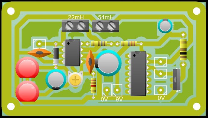

I have the old files, but they are incomplete as I started drawing up a slightly improved version of the Circuit: V2.0
The Files are attached.
Here is the Circuit, basically the same:
You can see, the circuit is basically the same, only giving the LED's more room and also: C4, the 510nF Cap more room.
Zip File is attached below. Remember, you need to specify when ordering:
Dimensions: Xmm x Ymm
File: .gb0 -  Board outline layer
File: .gb1 -  Bottom copper (solder side) layer
File: .gb2 - Top copper (component side) layer
File: .gb3 - Bottom (solder side) solder mask layer
File: .gb4 - Top (component side) solder mask layer
File: .gb5 - Silk screen (component outline) layer

We have covered some of this before, but not in much detail. Today I want to take a closer look at the IC: MC34063:
Observing closely, the Circuits:
Or if you prefer:
We can see a very clear and present similarity to another Circuit we know very well:
Yes, Akula did use the exact same technique, just using slightly different Circuitry, I am specifically referring to this part of the Circuit:
We referred to this Here.
This Circuit, only when in Resonance, Frees and Pumps Electrons from the Copper Atoms, many billions of them, because the Coils Buck each other.
Remember: The Mosfet is simply a Switch, that's all! only 4 or so parameters can be adjusted:

The Akula TPU runs on tapping the magnetic field of the earth.
In this moment this device is putting out about 1 Watt of free power.
As it depends on the location of the earth magnetic field these coils need to be adapted to the location for the maximum output. At his home in Russia he gets already more output, but as he stays in Germany during taping of this video, there was less output there, cause the magnetic fields from the earth are a bit different there. (different resonance frequencies)
This TPU did also run in an underground bunker wrapped in Aluminiumfoil !
So you have it... no hidden batteries and the coil structure is shown.
Many thanks to Akula and Arthur Tränkle for releasing this video to the public.

baerndorfer posted this 08 October 2021

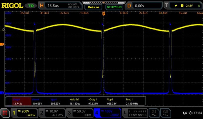

in the last weeks i did a couple of experiments with 2 e-cores and the information that i found from Andrej Melnichenkos. in his basic-circuit he uses 2 e-cores and 2 ordinary wingings on it - i think you know his scematic.
as usual i tried poc-coil on the secondary e-core and a ordinary one for the primary.
i energize the coil on the primary with a pulse-circuit. the switching is low-side.
i monitor the pulse from primary (CH4) and leg1 (CH1) from the secondary which is POC.
this is what i find...
as we can see the Vpp of the energizing pulse is 605V (CH4 - blue)
the reaction from secondary is 920Vpp - and it goes into the minus region
CH3 is the other leg from POC coil. it has no spike - just looks nice.
hope this information is helpful for someone.

in the next step i did a measurment of the current which is happening on both legs of the secondary POC coil.
i did the measurement with a 10mOhm shunt and use a differential probe to get the corresponding voltage drop. the shunt is placed after the diode. we see the current-probe on CH2 in cyan
for some reason the current is very late when i compare it with the voltage in yellow (CH1 voltage, leg1 from POC)
the other leg from POC (CH3 voltage) looks different.
so we have the situation, that both legs from this POC-setup do different things.
i think this is what don smith mentioned in his teachings. one leg is for the voltage - the other is for current.
to prevent confusion i like to add the video where A. Melnichenko shows his finding and demo circuit.  https://odysee.com/@tankcircuit:a/AndreyMelnichenko:b?r=HNY9ETVr7GutyjQY7FZRkJ6rMDrCLsLr
Chris posted this 02 November 2021
From Brians Thread on the Eternal Flashlight, Some good investigative work by YoElMiCrO:
First of all apologize for not being active
for a long time, work issues because
these are difficult times.
Chris the capacitor value is wrong, it is not 510nF is 510pF
since it determines the maximum time for Ton.
Ton=(C/0.00004).
The MC34063 is a hysterical DC/DC converter,
this means that you can vary the two times Ton/Toff and by
consequently their frequency of work.
The maximum duty it is capable of generating is approximately
85%, ton duration is controlled by the control loop and current
that senses between the pins 6/7 through the series resistor.
This current is determined by the voltage drop between these terminals and
is about 0.33V.
That is why their waveforms have nothing to do with the replications made.
Brian, it is the capacitor of 100uF that when it is at its maximum negative if
it is placed in parallel to the input capacitor this recharges it.
It is more complex than what I expose here, but it is a good approximation.
My Reply:
Thank you YoElMiCrO!
Nice Catch, I will correct my Circuits first up in the morning!
Please beware the Value of the 510 Cap should be pf and not nf, this is my error and I am in the process of fixing this thread, it will be done today! Circuits and diagrams will be fixed asap!
I am sorry for this simple error! Please everyone, if you see an error, please point it out, I do very much strive to bring the best and most accurate information I can at all times, however the best of us still make mistakes. embarassed
EDIT: I have changed all Images with the correct Value, please refresh, it may take a few refreshed pages to get the updated Images, because they Cache in your browser.
P.S: 13 February 2020, its taken almost 2 years to pick up this error! Damn! Researchers Unite, help spot any silly mistakes like this one!
Chris posted this 03 November 2021
Here some images of my old experiments on this circuit:
With this circuit, I did get it to run, I think I said that already, I spent a lot of time on this to see results!
I did this work, in and around this work: Here
Amin posted this 03 November 2021
Hello Chris and Friends,
Good job and news, I'm happy to see it is work.
is it possible to show some video of this job?
That is interest for me because it is working with small core like TV core.
Amin
Hi Amin,
A little bit of video in the first post, posted again here:
I spent a lot of time on this circuit, tearing down and rebuilding, looking back now, my documentation was poor, I did not document enough, and did not document enough of the right things!
I think it is important to document every experiment! Circuit, Scopeshots, Test Points, Scope Channels, Pictures, everything you can, that way, later, when you need to return to review information, you can easily!
I started a thread: The Importance of Documentation and Understanding!
Although these last images are old, many years old, they were a good step forward for me! I learned a lot! I remember when I saw the waveform Akula showed us and thinking wow, I am nearly there, and then...
Chris posted this 05 November 2021
From:
Akula's GELD Waveform:
Little more work:
  • Yellow is CN1
  • Teal is CN3
  • Pink is CN2
I would like to note; 2x other circuit's I posted on this thread with the right Capacitance on the 510pF Cap.

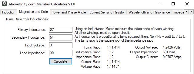

Chris posted this 09 November 2021
For your use: two useful tools:
I am currently Porting to C#, to add to our Aboveunity.com Member Calculator:
namespace AboveunityMemberCalculator.IntegratedCircuits
    #region Using Statements:
    using System;
    #endregion
    /// <summary>
    /// Datasheet: https://www.onsemi.com/pdf/datasheet/mc34063a-d.pdf

Chris posted this 20 November 2021
An Image of the Completed Circuit, V 1.0 PCB, shown Here.
Yes, I have fixed a few issues that were seen in the first Image. With the fixes, I got the Waveform Shown:
  • Yellow is CN1
  • Teal is CN3
  • Pink is CN2
Which is a fairly close approximation to:
Seen in the Video:
However, its not quite right! I have issues in my Waveform, which for the moment I will not be pointing out.
I will share more soon!

The Buck Boost circuit is Resonant:
Another Circuit that uses this idea is Andrey Melnichenko, specifically C5 seen here:
Pointed out in this post.
Of course in the above Circuit, the positive Terminal of C5 must be at least enough Voltage to keep the Machine Running, keeping C2 Charged, Current comes from the Magnetic Field Opposition during this part of the Cycle. Which occurs well after the Input is off as we have learned from our work!
Asymmetrical Regauging:
Evidence for these Regauge periods can be seen in the original video, spikes on the bottom of the Sine Wave:
Good spotting! Thanks for sharing!
And Here:
This thread is soon becoming one of the most important threads here on this forum.
Time ( t ), time is a critical factor, it is a dependant factor in Electrical Energy; which is defined as Joules ( J ) per second. One Watt Hour ( Wh ) is: Joules ( J ) per second x 3600, because there is 3600 seconds in one hour. So, one Watt Hour ( Wh ) is equal to 3600 Joules ( J )
So, the "Generation" of Energy, is time dependant.
Lets observe this image in some detail:
You can see, we have Triangles in the Blue Waveform, clearly seen:
In the Blue Waveform, we see there is a line up of the Spikes, I have marked this in Red. These Triangles are the same as I have pointed out above:
This is where the Coils build up a Potential, this "Generates" Current, the Pump, the Tap is open for a Flow. Currents are Equal and Opposite. Lenz's Law, a Natural State, a state that Nature requires for a System to come back to Equilibrium. A closer look:
Its hard to see in a Sinusoidal System, DC Pulsing is a lot easier to see what's going on. Lets listen to one example:
Lets look at two examples:
Ref: Tinman ( Bradley Richard Atherton ) - The Rotary Transformer.
Ref: Graham Gunderson - The MIT.
Many times we have seen examples of this Triangle Waveform, its the same as I have described here:
As long as we have a Voltage on the Y Axis, we have a Pump that can Pump Current for the time indicated on the X Axis.
All we need do, is create the Voltage, its Asymmetrical Regauging, described as:
Ref: Tom Bearden - The Tale of Rajah
Right here we see not just one, but four examples...
P.S: Some of my videos have been removed from YouTube and there is no explanation why.
What's wrong with my waveform?
I have not yet, "Caught the Wave", I have not got the correct Regauging going on, You can see I have a little bit:
But it is not enough yet:
NOTE: What we see here, is very similar to the Kapanadze Grenade Coil, or the KappaGen! Its the same Sine Wave with a Spike on the top, instead of One Spike at peak Sine, we have many Spikes on the Sine. The same basic Concepts apply here! I am confident that this phenomena is related to Antenna Theory!
Chris posted this 07 December 2021
"The Trigger" for what I call "The Stairway to Heaven" is the "Duty Cycle" and "Frequency" of Your Input.
Remember: Voltage is either "Generated" or "Un-Generated". We saw this in the Thread: Timing
Seen in the last post, we have a short DC Pulse, in the very narrow Duty Cycle range, and this is The Trigger, explained above, and also seen in the above Triangle as the Voltage Amplitude.
Seen in the above Scope Shot, and shown again here:
My Waveform was not quite right, simply, I did not "Generate" enough Voltage, or I did not quite reach "The Stairway to Heaven"!
I am using this Pot Core:
LARGE size POT (P, PP) ferrite core. AL=9500
Manufactured by HAGY, Hungary.
Bobbin (coil former) is included. The bobbin which I will include is shown on photo #2. Photo #1 shows an old type of bobbin which is no longer available for sale.
Ferrite Size:
Outside Diameter: 47mm (1.85")
Width (of 2 cores = one set): 28mm (1.10")
FOUR slots
Condition - brand NEW, stored in their bulk factory package.
The price is for 1 set (2 halves + bobbin)
Ref: Ebay - P4728 HAGY 47x28mm M2 78 LARGE POT P PP Ferrite Core transformer AL=9500
I recorded my Coils Wire Length and Ratio as:
L1 Primary: 4.7 Meters of 0.6mm wire.
L2 Secondary: 9.85 Meters approx of 0.45mm Wire.
Wire Length Difference = 1 : 2.09574 times.
NOTE:  We saw a calculated Turns Ratio in Akula's GLED of:
Ref: This post Here.
You can see, my Turns Ratio are Higher: 1 : 2
I think I could have taken a few turns off the Primary: L1.
To calculate the Timing Capacitor, we need a frequency of: 45.7KHz. This gives us a Timing Capacitor Value of: 5.105762217359592E-10 Which is: 510pF. Our Capacitor is 510pF.
So, the question is: Does my Input Coil become Resonant at 45KHz? Or, is there an: L1 to L2 Coil Resonant Interaction, that becomes evident at approximately: 45.7KHz?
This L1 to L2 Interaction is Magnetic Resonance!
Jagau posted this 07 December 2021
Thank you for the reference of this potcore with a great AL (9600)
To calculate the turns I use this formula
I use the internal capacity of the 2 coils that makes the system easier.

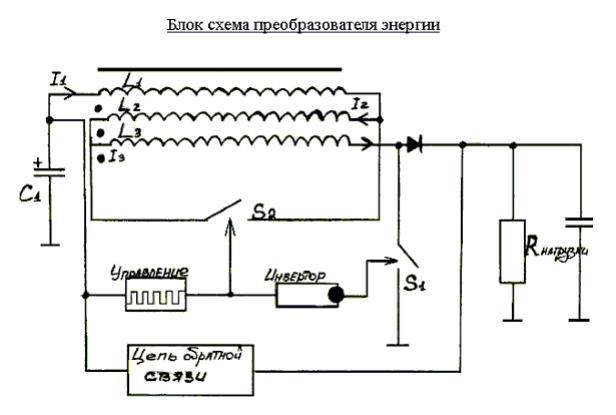

Remember what Floyd Sweet and also Andrey Melnichenko said:
The underlying principal (forget Millikan’s experiment) has been derived in that magnetic effects vary on the square of the current.
Ref: Floyd Sweet - The Space-Flux Coupled Alternator
The main area of research is the study of theoretical and technical possibility of creating devices generate electricity through an open process, the author of a physical transgeneratsii electromagnetic field energy.
The essence of the effect lies in the fact that the addition of electromagnetic fields (constants and variables) are added no energy, and the field amplitude. The field energy is proportional to the square of the amplitude of the total electromagnetic field.
As a result, the simple addition of the energy fields of the total field can be many times the energy of the initial fields separately. This property of the electromagnetic field is non-additivity of the energy field. For example, when added to a stack of three flat circular permanent magnet energy of the total magnetic field is increased to nine times! A similar process occurs with the addition of electromagnetic waves in the feeder lines and resonance systems.
Total energy of a standing electromagnetic wave can be many times greater than the energy of waves and the electromagnetic field to add. As a result, the total energy of the system increases.
Ref: Andrei Melnichenko Inventions
You can see, the same thing is being said: 32 = 9.
Magnetic Resonance is a Standing Electromagnetic Wave!

The Integrated Circuit, IC, MC34063, has a Timing Capacitor on Pin 3, to Ground, that regulates the Timing on the IC's internal Circuitry.
The Value of the Timing Capacitor can be Calculated:
OnOffRatio = (IsStepUp ? ((Vout + Vf - Vin) / (Vin - Vsat)) : ((Vout + Vf) / (Vin - Vsat - Vout)));
Toff = (1.0 / (Freq * 1000.0)) / (OnOffRatio + 1.0);
Ton = (1.0 / (Freq * 1000.0)) - Toff;
Ct = (4.0 * Math.Pow(10, -5.0)) * Ton;
The Timing Capacitor ( Ct ) is a Calculated Value, depending on Frequency and other variables. 45.7KHz is a Rough Guess at a Value for the Frequency with a Timing Capacitor of: 510pF.
I provided the Rough Calculation above, in my second to last post: Here.
Hey Fighter,
May I ask what N channel mosfet and diode would you recommend? Also in your PCB it seems that you use a KT806A transistor instead of a mosfet? Is this correct? What would be the reason for this?
Greg
Chris posted this 28 November 2022
Hello Greg,
I used a Buz11, but any will do within spec:
Some may work slightly better than others.
Sorry for the dust!
Chris posted this 01 December 2022
I have already tried to point out, the Key to making this machine work, is right here:
Regarding my Waveform:
And, the Issues are, My Asymmetrical Regauging is not right, I have more tuning to do to make sure, I get the Peak Amplitude for the minimum input Pulse via the Cap C3 and the Coils Inductance L1 and L2:
If you guys want to make this work, to Self Run, you need to focus on this very specific area: Asymmetrical Regauging:
It should be obvious to any paying attention:
A small, High Frequency, very low Duty Cycle, DC Pulse is timed, to Resonantly Gain Maximum Amplitude on the Coils, Resonant Electromagnetic Induction, REMI, if you like!
This is Asymmetrical Regauging! Resonant Electromagnetic Induction, REMI, is Magnetic Resonance, and also part of Asymmetrical Regauging! All small parts of a very Simple, yet illusive process!
Akula called this Ferro-Resonance. It is not, because this works with a Core and without a Core, so there is no "Ferro" about it!
If you focus specifically, on this very simple area of this device, it will Self Run! You will be Successful!
This is why We are Light Years Ahead of the other Forums!
Chris posted this 12 December 2022

I even gave you the PCB:
Many have had differing success with the PCB! However, if you focus on the spikes as I have shown, you will achieve a selfrunning machine!
