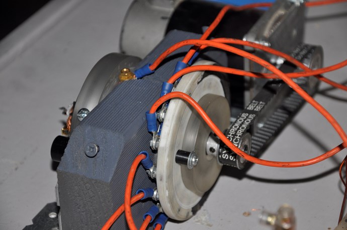

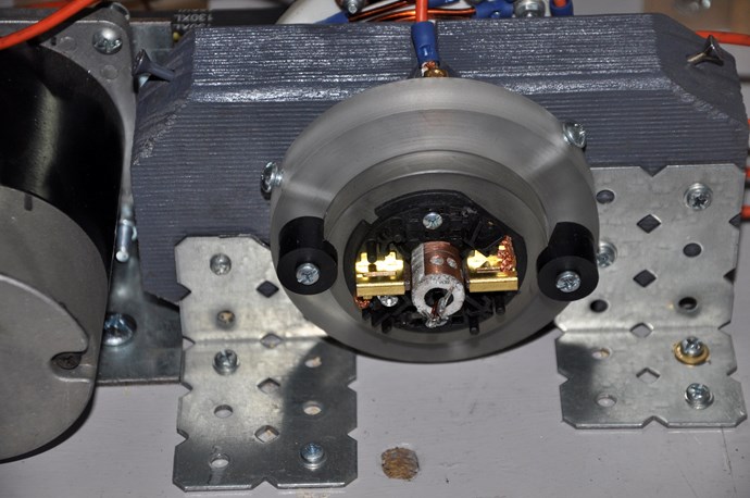

Cornboy posted this 14 June 2019
 Hi All, a small success with my new Commutator, still loosing contact, will run it for a few hours to seat the brushes and then see.
 Regards  Cornboy.   smile

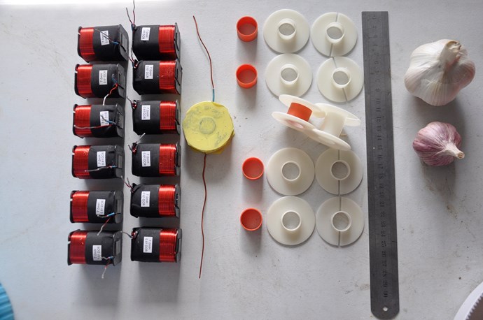

Cornboy posted this 15 June 2019

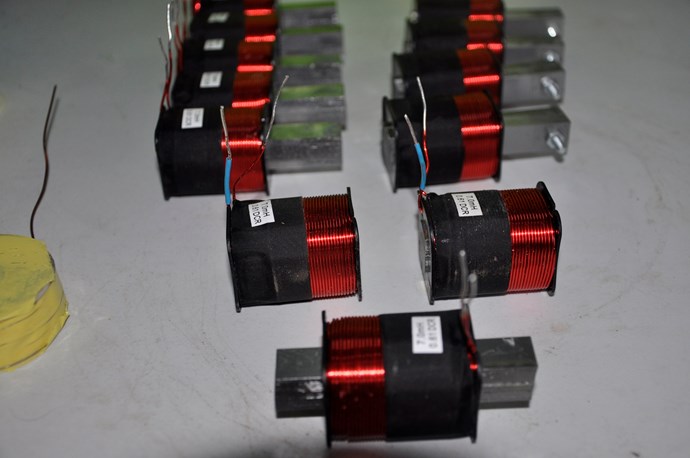

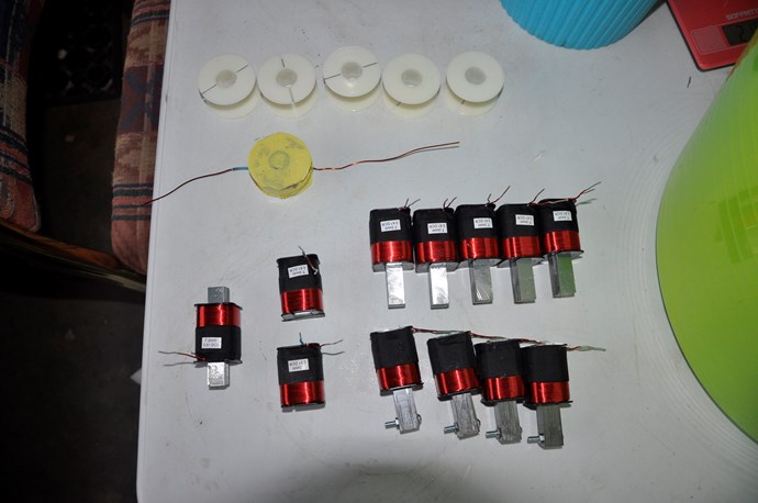

 Hey All, this almost feels like cheating, compared to you MM, it is a very easy and cheap option for anyone for testing on a lot of projects.
 Off the shelf audio inductors, for around $12.00 AU each, including cores.
 When i asked my au supplier can you move the coil along the core he tried and said definitely not, so i ordered one and found a way without any damage, then ordered 12.
 I am saving the left over cores after cutting them, to place in the centers of the secondaries, which are a loose fit, and then filling them with a mixture of iron dust and epoxy, to make filled cores.
 All the Best  Cornboy.   smile
 MM.
 The coils are 40mm long, the cores are 75mm long, and are laminated.
 Wire is 18g , 7mh inductance, 0.6ohm  dcr.
 Still a bit of work to do on these, like machining one end of the core flat and trimming the cores to the right length and all equal length, but still very economical.
Cornboy posted this 16 June 2019
 Hi All, primaries are cut and machined all the same length, ( within about 5 thou ).
 Secondaries bobbins i bought online from China, closest i could find, then cut them down and made correct spacers for desired length.
 So on to winding the secondaries, and making their cores.

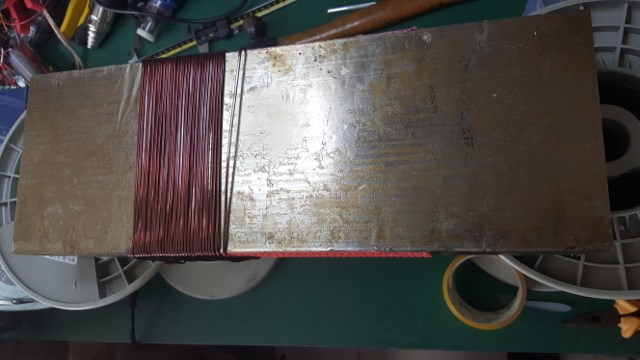

Cornboy posted this 23 June 2019
 Neat Job MM, i hate winding coils!.

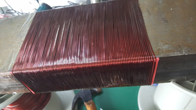

Cornboy posted this 24 June 2019
 Nice work Peter, great to see you at it again.

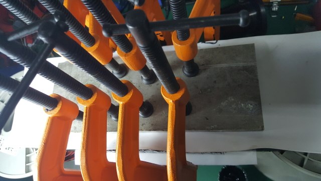

Cornboy posted this 27 June 2019

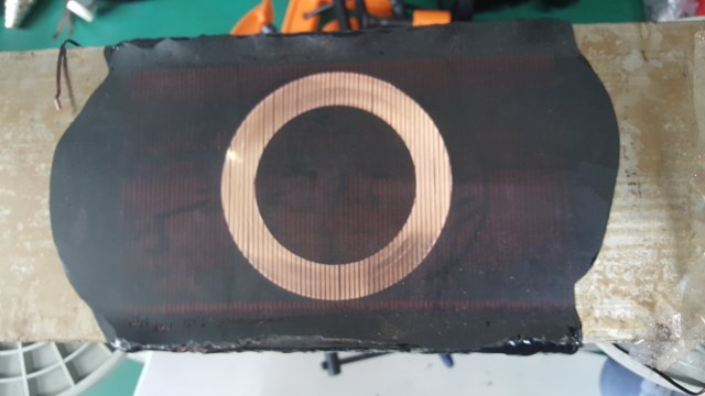

 Bloody hard stuff to work with MM, clamping it together and holding it flat while you epoxy it will be a challenge, maybe Aetherholic could shed some light, after doing his.

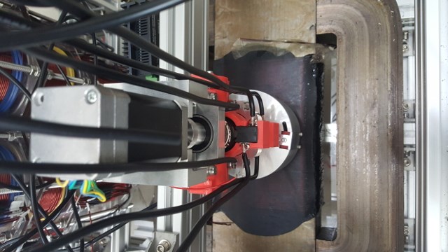

Aetherholic posted this 27 June 2019
Cornboy
Part G wire 93 turns 2mm x 1mm rectangular enameled copper 2.5mm spacing.
Build sequence:
1. Support the core on 2 empty wire spools
2. Epoxy 2 3D printed wire guides one each side and wait 24 hours for cure.
3. Start to wind the core.
4 Finish the wind.
5. Coat the windings liberally with epoxy. use 2 1mm PTFE sheets and two aluminium plates and clamp as hard as possible.
Leave 2 days to cure.
6. Remove the clamps etc. and clean up.
7. CNC the surface 0.05mm at a time until all wires exposed.
8. Mount on the frame.
9.  Mount the Part G head and finish up the wiring.

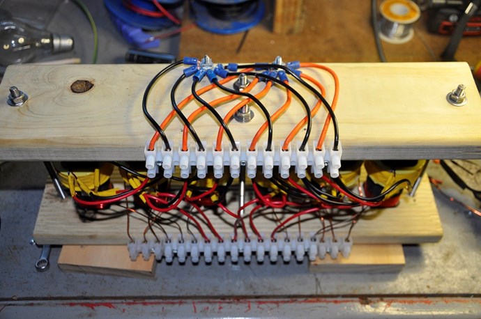

Cornboy posted this 28 June 2019

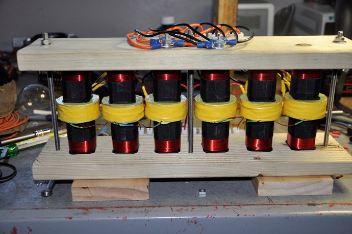

 Hi All, some shots of my mini coil setup.
