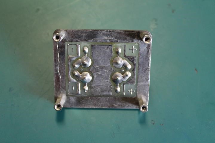

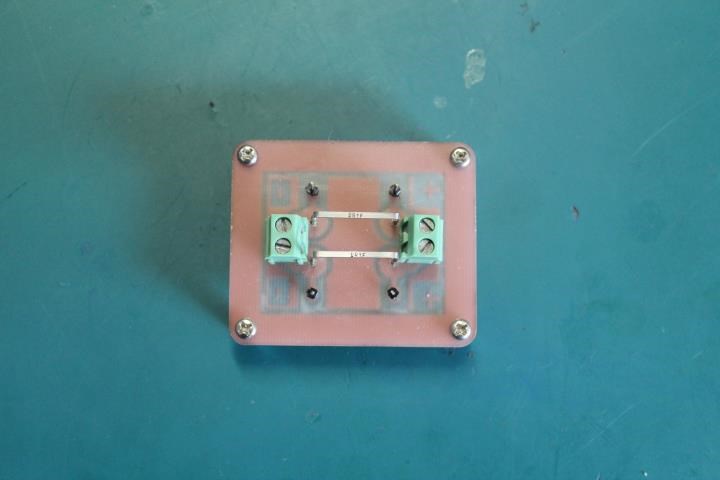

cd_sharp posted this 11 April 2017
Hi, Chris! I finished up the current sensing PCB. From the following pictures I believe that the voltage drop on one resistor is positive and the voltage drop through the other precision resistor is negative. I think this means the currents go in opposite directions, right? It's what we need?
