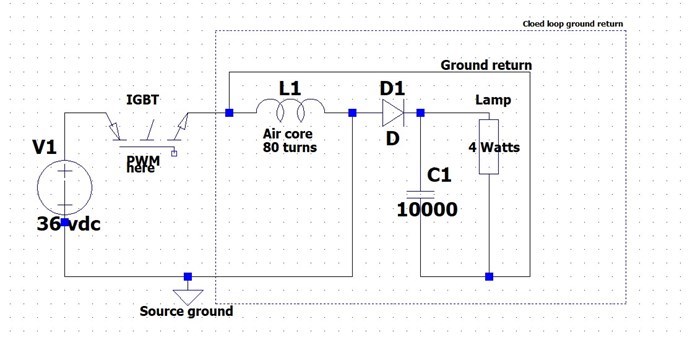

To study the phenomenon take the very simple diagram from the website of A. Melnichenko
This schematic has two coils L1 and L2 in mutual connection and as can be noted the same phase polarity (dot). To understand what is happening in the coils, an analysis of the polarities is necessary.
As Melnichenko himself explains there are two phases to take into consideration, the 1st magnetization and the 2nd demagnetization.
1 When magnetizing, T1 closes and L1 becomes negative on the bottom and positive on the top with the same phase polarities on L2. D1 and D2 being in reverse polarity then X1 and X2 do not light up.
2 During demagnetization, T1 opens causing L1 and L2 to reverse polarity as shown in the following diagram:
Since D1 and D2 are now forward biased then both diodes conduct so that X1 and X2 turn on.

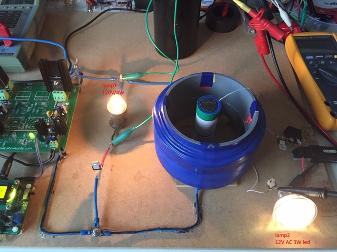

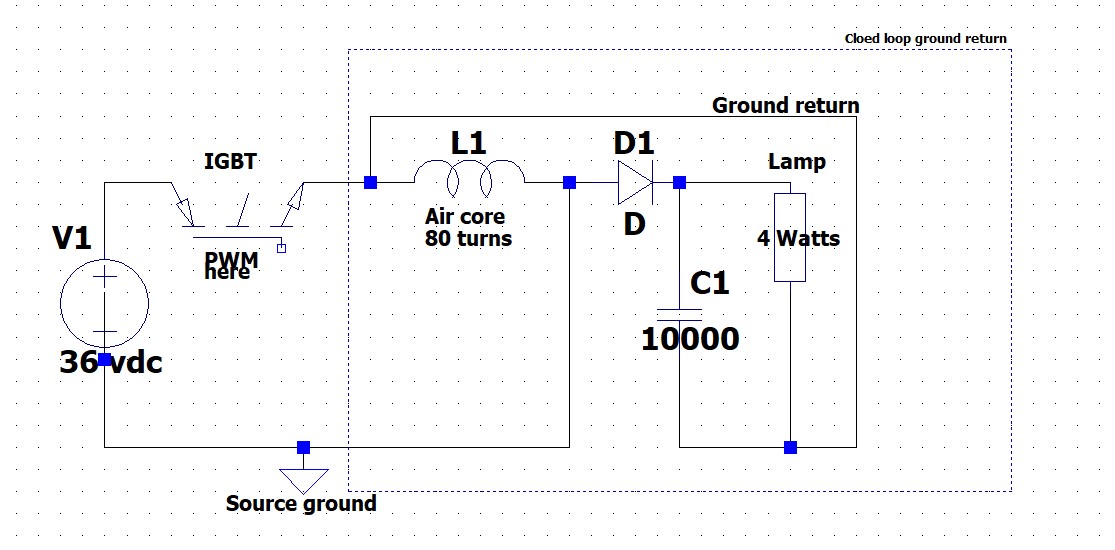

To help you build, I offer you the first part of the circuit in order to arrive at the final circuit.
If you succeed in this very important first part, the sequel will come for the Melnichenko effect.
You will notice the position of the IGBT and that of the two different masses that I had already mentioned in a previous post.
The proposed circuit
When the circuit is in operation, if you remove the lamp, the power at the input does not change, but the accumulation of energy in the capacitor is very fast and high, that is why it takes a capacitor in the around 10,000 uf. Melnicehnko advised 2 x 6000uf.
so be careful, this is not a circuit for beginners.

It is simple, again here is Jagau's Circuit:
@Jagau, I believe there is an error in this Circuit, please confirm.
Pretty much, this is a Bedini SG Circuit, and everyone is no doubt familiar with this Circuit! Its very Easy to Build!
Those Members searching for Answers, that have not already found Answers, and many have already and not Publically acknowledged it, please join in and Create your own Replication Thread: <Member>'s Melnichenko's Effect
  • Mimo
Jagau posted this 14 June 2022
When the circuit was copied on the site it was too pale and conductors are missing this one is the good one
The second ground was barely visible.
you'll notice there are two grounds in this circuit, so one doesn't affect the other, it's a modified flyback.

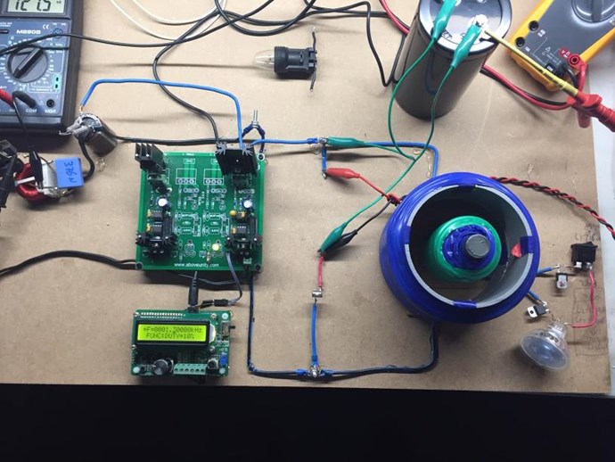

Jagau posted this 20 June 2022
I've been very busy these last few days, I couldn't wait to go back to my experiences.
So I made myself a little gift, sometimes you have to have a little fun according to your budget, with a very special purchase, a TEK P5021 current probe. It's not the latest model but it works very well with my scope.
So still great experiences made and shared.

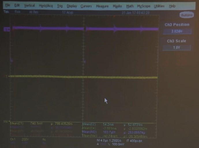

For others watching and reading, we have done experiments where we can see a very large amount of Power Coming back to the Input:
This is on the Input Measurement Block: -1.63 Kilowatts!  Of Negative Power, not Positive Power, Power in the Spike going back to the Power Supply!
For the moment, I am not going to show where this is from, or discuss it further, as I already know what's possible, and seen this sort of thing for a very long time! I share this, because it will be of assistance to other researchers!

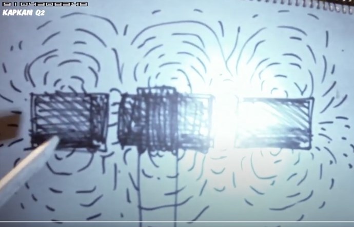

My opinion is, as the saying goes, a Picture is worth a thousand words:
Ref: Andrey Melnichenko - Transgeneratsiya electromagnetic field energy
If one is to evaluate the Vector Directions of each Field Individually, then one will see that a Superposition does occur, meaning there are some Vectors that Sum to Zero, for example: 1 + -1 = 0
Of course, the Vector Equation: 1 + -1 = 0 is Conventional Electromagnetic Induction, a frivolous approach to an almost 200 year old technology on Science's part!
There is more!
Asymmetrical Electromagnetic Induction is seen right there! This Vector Equation becomes: 1 + -1 + 1 = 1, of seen in Melnichenko's form: H1 + H2 + H3 = H3.
The Magnetic Field does not change Polarity, as in this case, a DC Source is the Supply, the Magnetic Field only changes in Amplitude, of Intensity, as the Magnetic Field Grows and Decays. So there is no AC, or Alternating Current seen, per se, its a DC Current Source for the most part, but the Primary Voltage Polarity flips between Mosfet TOn and TOff. So there is confusion seen amongst Researchers that have not yet put the work in!

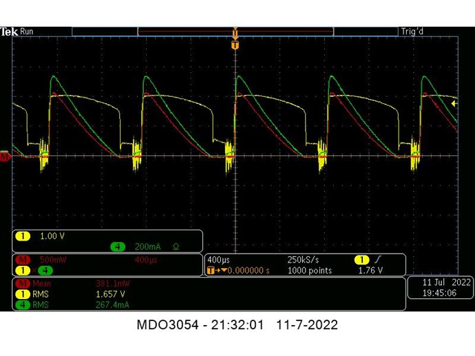

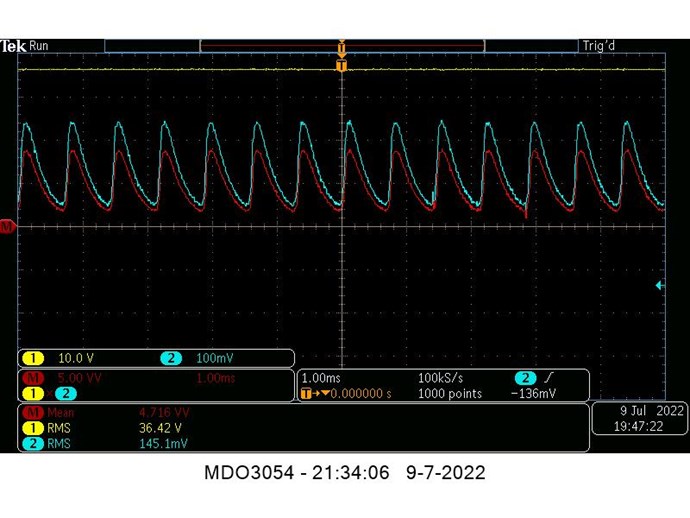

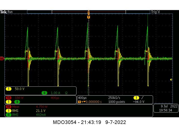

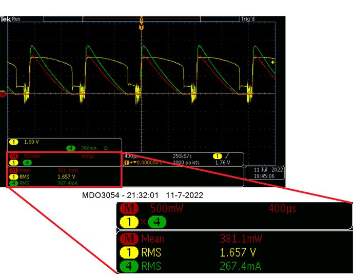

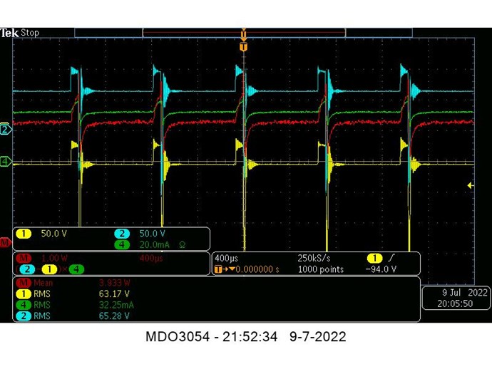

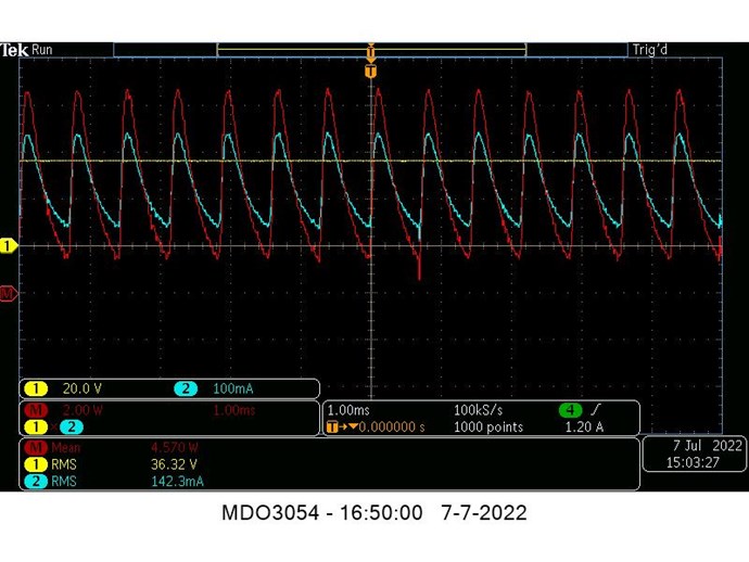

Ironically, OverUnityResearch.com Member Itsu, several weeks after turning down an Invite, is now doing a replication of Jagau's work, Here!
My present replication of this basic circuit looks like this:
With this as diagram:
Some data on the used circuit:
L1 primary air core 80 turns: 726uH
L2 secondary 2x 144 turns ferrite cores separated by 1.5mm gap: 4mH    (this L2 is not yet in use in the present basic circuit!!).
When inserting L2 into L1 in the next step, the L1 inductance raises to 850uH.
When shorting this inserted L2, the L1 induction drops to 710uH.
But again, this L2 is now not in use!
FG running 1.4KHz @ 9% duty cycle (adjust to get ~120V across Lamp1)
Lamp1 120V / 4W

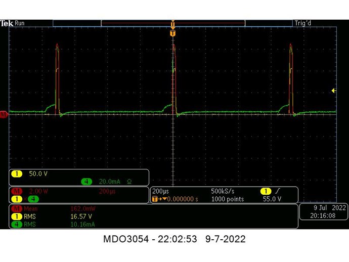

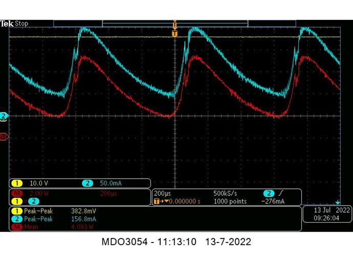

Initial power measurements shows for:
input power:   4.57W, see screenshot 1    (yellow: voltage, blue: current through csr and red calculated power)
IGBT power:   4.63W, see screenshot 2    (yellow: voltage, green: current and red calculated power)
Lamp1 power: 4.66W, see screenshot 3    (yellow / blue voltage (differential) , green: current through lamp1 and red calculated power)
As can be seen in the screenshots, the measured signals get more and more erratic and accurate power measurements gets harder to make.
I had to use the differential probing technique and advanced math function to measure the Lamp1 power due to its floating state.
It also shows that in this basic setup, almost all input power is being consumed by the Lamp1
Next step i guess would be to insert L2 into L1 and attach a load to L2 to see if this load (lamp2) can be lit for free (so without any
influence on the input power and Lamp1 power.
Side note 1: AboveUnity.com is often offline for some periods, so you might get some time outs.
Side note 2: the input DDM's (and PS meters) show lightly less current (thus power when calculated) as compared to the scope probaly due to the current AC component
in the signal.
Regards Itsu
NOTE: In the above image, you can see Itsu does have a Negative Power Component, pointed out in our thread: The Input Coil, which is Positive Voltage x Negative Current = Negative Power!
A Major Error seen, is the use of RMS Power Values! You can NOT use RMS Power Values on the DC Input Power, see our: Measurement Thread for an explanation!
Schooling the Gurus again, we are!
I have said it before, Itsu is a good Builder! He does good work! If Itsu was able to see through his projects and gain a greater understanding, he could be very successful!
I wish Itsu Luck, I truly hope he is able to see this Experiment through to the Knowledge required, However, I see a very important issue, that we here at AboveUnity.com have warned about before, do you see them? Digital Multimeter's? Yes? Don't use them! They are not accurate!

Chris posted this 10 July 2022
I believe we see more strife:
Doing some more accurate measurements on this new setup which includes L2 and its load see above post #2
Ref: Itsu's A Melnichenko effect replication
Now, I am sorry, but Itsu is no where near the mark! There is problem after problem after problem seen here!
Itsu states:
Input power:   4.71W  see screenshot 1
and we see:
Still Itsu is using RMS Voltage and Current Measurements, this is wrong and can not be used! This is NOT how you measure DC Input! This is In-accurate! Very Wrong!
Itsu's wave forms:
Itsu's waveforms are not inline with ours! I have no idea what itsu is doing! I mean, this is VERY Important to get right!
Of course, a bit of the Sawtooth waveform is seen clearly in Jagau's Screenshot, all three traces, it's not present at all in Itsu's!
Jagau showed early on:
Totally different Waveform, Totally different Effects! Totally Outside of the guidelines Jagau has set out... And Itsu is showing final measurements saying:
So this present setup with L2 does not show any special effect, but there are several tuning options which can be explored.
Sorry Itsu, your Work shows nothing special, this is certain!!! Your work, however, is NOT what Jagau has been showing everyone, you're comparing Apples and Oranges!
I am sorry, but the terrible attention to detail, when making a representation to our work, really does frustrate me beyond belief!
Itsu has not accurately replicated what we are showing!
Hmmmm, Accurate? No, not at all !!!

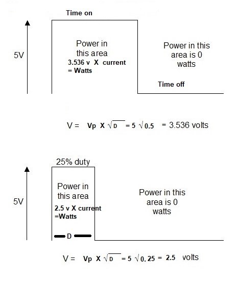

A few years ago Adrian S. Nastase Phd Electronic engeenering said:You can think of it like this:
You can think of it like this: A pulse signal with its amplitude between 0 and Vp (its peak value)and a duty-cycle d, has the average value:
VpulseAverage = d*Vp

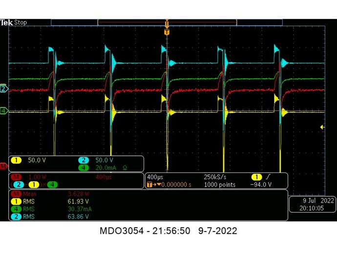

I am sad to report, the response from Itsu is not a sensible, logical approach:
For Chris,
the beauty of power measurements with a scope is that the scope does not care what kind of signal it has, DC, AC, peak, square, sinuous etc.
It just takes millions  of samples of the signals (not rms, not mean, not ...) from its buffer and multiply (in this case) those instantaneously getting millions instantaneous power values which then get averaged (mean) presenting the average power across that buffer.
So nobody is using rms value's to calculate power, those rms value's you see on the voltage and current are JUST a representation of the signals measured by the scope, it does NOT use them for calculating power.
I don't pretend to be a guru in anything, so please anyone with extended knowledge on scope power measurement techniques step forward and either confirm, deny and/or improve on my above statement.
Concerning the dimensions of L2, i did use several different L2's, see above post #7, but all shows similar output value's (65 to 160mW), so i hope Jagau can shed some light on what dimensions he uses to get cop > 1.
Regards Itsu
Itsu
Ref: A Melnichenko effect replication
I understand what you are saying Itsu, I understand very well how a Scope works, Thank You.
Your Scope is taking the RMS Values for that Channel:
You are averaging: Instantaneous V RMS x I RMS = P in Watts
  1. 1.657 V RMS
  2. 267.4 mA RMS
Which is Wrong! You cant do it this way, not on DC Input! I know this scope shot is not your Input... But using this as an example.
Very simply, compare a Sinusoidal Waveform with each channel, one Mean and one RMS, the difference will amaze you! I have already shown this in the: Measurements Thread, if you go and Read it!
However, any setting on RMS means you have the Scope Calculating RMS for the Buffer Size across the data points captured.
RMS is Specifically designed for AC, Alternating Current Only! It can NOT be used for DC, Direct Current, at all.
RMS or root mean square current/voltage of the alternating current/voltage represents the d.c. current/voltage that dissipates the same amount of power as the average power dissipated by the alternating current/voltage. For sinusoidal oscillations, the RMS value equals peak value divided by the square root of 2.
Ref: RMS Current
The Oscilloscope will take the RMS Value, if you capture the RMS Value, again, which is wrong! Please do the Math!
The term “RMS” stands for “Root-Mean-Squared”. Most books define this as the “amount of AC power that produces the same heating effect as an equivalent DC power”, or something similar along these lines, but an RMS value is more than just that.
Ref: RMS Voltage Tutorial
Its a real shame, because not a single measurement can be accurately represented, unless the Correct Data Points are Calculated! Its sadly a fact, that these are the same people, telling Itsu how to measure incorrectly, that have been telling everyone for decades, that their Measurement Data is wrong! I can show you thread after thread that states that you should use RMS on a DC Source, when you absolutely Should NOT !!!
Ask yourself, why have they insisted on RMS for so long? Is it a means to falsify the Data just in case others did get something of Value?
RMS can NEVER Measure any Negative Power, RMS is ALWAYS Positive, never accounting for any Reverse Currents! It Should NOT be used on DC if one wants Accurate Measurements! Should we not expect measurements to be accurate if measurements are to be given?
For those providing Measurements, they should be providing accurate Measurements, that are in-line, with Industry Standard Definitions, and Defined Values and Guidelines!
I have provided the evidence, the proof is right here, with References, if you persist to make in-accurate measurements, I can no longer assist.
This is Jagau's Thread and I do not wish to waste any more resources on his Thread, Sorry Jagau!
SonOfLuck posted this 13 July 2022
( Hi Chris
(I'm pretty sure I will be labeled a troll for this, which i'm not)
  1. 1.657 V RMS
  2. 267.4 mA RMS
1.657 * 0.267 = 0.442419 ~= 442mW
This is not the value that Itsu reported for this image.
Itsu stated 381 mW wich is the mean of ( V measures multiplied by A measures )
itsu measurment
And you saying that's the correct way. Every wattage reported by Itsu was calculated this way, you can check.
Sorry Jagau! )

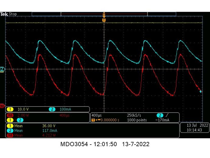

Chris posted this 13 July 2022
Hi SonOfLuck,
Yes, I have done the math, which is not a conclusive answer to the problem!
If Itsu can show in Scope Math Functions where he is setting Mean or Average Values for each Channel, I will accept his answer, however, currently, the Scope is showing RMS Values! Of course I have already pointed this out.
Post 1:
Post 12:
There you have it, Margin of Error: ≅ 0.5 Watts, a large error! 10.43%
Even with less cycles on the screen...
If a Scope Shot is shown, then the Scope Shot should show the Correct Values! Other wise its misleading and incorrect, Accurate Measurements can NOT be assumed, again as is pointed out.
Mean or Average, same thing, must be used on DC Input!
Thank You Itsu:
Thank You for showing Correct and much more Accurate Measurements. More coming soon, stay tuned...

Jagau has given us an Equation that Calculates the Average Voltage:
Lets look at some examples:
  • Voltage Peak VP = 10 Volts
  • Duty Cycle d = 50%
  • VAverage = d * VP = 0.5 * 10 = 5.0 Volts Average
Another:
  • Duty Cycle d = 10%
  • VAverage = d * VP = 0.1 * 10 = 1.0 Volts Average
These Average Values, they are logical! They Make sense for an Average Value.
Thank You Jagau!

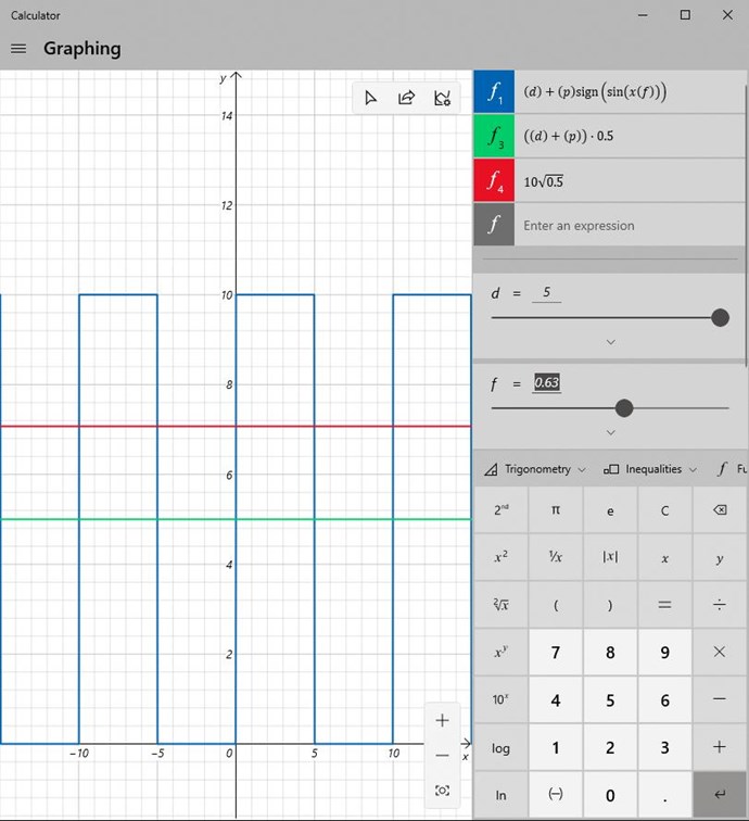

If we use: 10 VoltsPeak, and a Duty Cycle of: 50% and set our Area to 100 Squares, for One Cycle:
I have to say, I am not in agreeance with Dr Adrian S. Nastase. We get a result that does not appear to be correct:
  • RMS of 10 VoltsPeak = 7.07106781 Volts, or 70.7106781 Squares above the Zero Line in One Cycle.
  • Average of 10 VoltsPeak = 5.0 Volts, or 50 Squares above the Zero Line in One Cycle.
Taking One Cycle, at 10 Volts and 50% Duty Cycle, then we get:
  • 100 Squares x 0.5 = 50 Squares at 10 Volts, and 50 Squares at Zero Volts.
Over one Cycle, we have an Average Voltage of 5 Volts, so the Green line makes sense to use, as the RMS gives a greater usage of Voltage, by 2.07106781 Volts. Because the Sine Wave is Non Symmetrical between Zero and Peak, I fully understand why RMS is used for Sinusoidal Waveforms:
RMS means ‘Root Mean Square’ in mathematics. It is also referred to as quadratic mean. The RMS is very useful in many fields, particularly in electrical engineering and in the domain of signal amplifiers. RMS is very useful when the random variables in the data are negative and positive such as sinusoids.

SonOfLuck posted this 15 July 2022
Consider this....
1V peak pulse(0 bottom) with 50% duty cycle on a 1 ohm Resistor gives us 1A peak pulse.
if you multiply the measured data points you get 1 W peak pulse.
Now you average it and you get 0.5 W.
Now if you average the 1V pulse and 1A pulse, that gives us 0.5V and 0.5A, this value feels right ( to me at least) in the individual context, but if you multiply them that's 0.25W.
Now if you RMS the 1V pulse and 1A pulse, that gives us 0.707V and 0.707A. For me its weird to say that
1+0+1+0+1+0+1+0+......+1+0
a series like this the average value to be 0.707, BUT if you multiply the values that's 0.5W.
From this it's seems like RMS is king, but we don't need to go far to see that's not truly the case.
itsu measurment
Here the RMS V and A multiplication gives different W than the measured and averaged value, 381mW vs 442mW.
Best regards,
SonOfLuck
Chris posted this 15 July 2022
Hey SonOfLuck,
Some good points there! I am running an experiment at the moment. Long winded math to show the RMS and Mean are totally different Math Problems and that RMS should not be used on DC or even Pulsed DC Systems, in General.
If you look at the Pro's, Graham Gunderson, he uses Mean:
Graham Gunderson is a very high level Electronics Engineer in my opinion, he has worked in many High level positions and is a professional at what he does.
TinselKoala, TK has a very extensive history in Metrology and he uses Mean, recommends to NOT use RMS:
which generates an instantaneous power waveform, then take the _average_  (not RMS) value of that IP waveform.
Ref: Accurate Measurements on pulsed system's harder than you think.
Interesting read, observe Names and Recommendations for more insight!
I have to agree, when you say:
itsu measurment
Its not hard to show mathematically, that RMS is not always Correct! However, like Jagau said:
It is very very important that this applies that in the case of a square wave which does not go down below 0 volts, it is always positive. If you have a square wave varying from plus to minus you should not use this formula.
Generally, RMS and Mean, in most Positive going V and I, the Values will be pretty similar. I showed this in my video here:
RMS is an AC, Alternating Current Calculation:
For DC and Pulsed DC Systems, generally Mean or Average Should be Used. This is especially true when one has a Non-Linear Load.

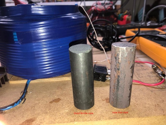

Chris posted this 16 July 2022
Itsu's center coil:
does anyone see a problem with it?
Increasing CSA by packing the core with tape?

Chris posted this 31 July 2022
@Itsu,
You need to study what CSA or Cross Sectional Area is! How it works and why its IMPORTANT!
You're wasting your time with this:
Ref: WTF Man?
I really don't know why some people persist with something that is not going to work!
If you happened to study Melnichenko, you would see, as I have already told you, the Core is about three times bigger:
СВОБОДНАЯ ГЕНЕРАЦИЯ Андрей Мельниченко translates to: FREE GENERATION Andrey Melnichenko
Andrey Melnichenko's YouTube Channel is: www.youtube.com / channel/UCEtqI2EhN32Mvq7Wp5G9Vpg/videos
Andrey Melnichenko's Core is about three times the size of Itsu's at minimum!
A Replication requires some Attention to Detail!

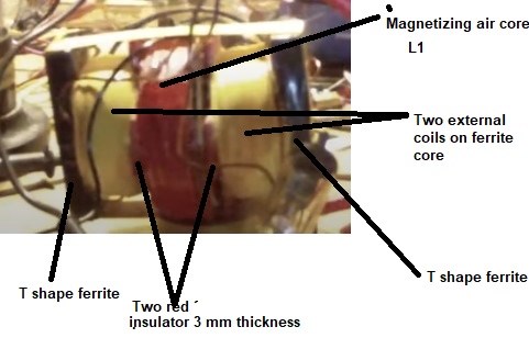

Jagau posted this 03 August 2022

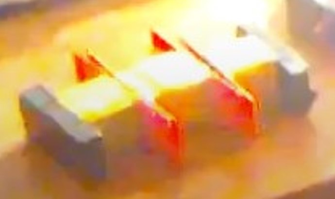

When Melnichenko talks about three-core this is what he's talking about.
This image taken from a video of Melnichenko
The center air core or magnetization coil and the other two at the T-shaped ends, wth 3mm insulation in red
Chris posted this 03 August 2022
I can confirm, Jagau's recommendation will, under specific conditions, work as is intended!
Don't forget however, Coil Geometry defines the Magnetic Field, the Magnetic Field defines Voltage "Generated" via Charge Separation, and the Current Pumped via Opposing M.M.F's! So, Design is an important factor here.
In the arrangement of the air core on the magnetic core,
the coupling coefficient is a paradox, it works in reverse,
Statement from Melnichenko, at line 39 his patent 2022
 It is important to simultaneously increase the magnetization and, at the same time, weaken the magnetic coupling of the ferromagnet with the inductor
This is one of the most important things about his invention,
it shouldn't have almost any magnetic feedback effect on the primary,
but as he says in his videos there is always a little.

Appologies to Jagau for posting Itsu's work here, please say and I will move to another thread if you wish?
I want to quote:
I did some measurements on this new BIGGER L2 coil made of 3 stacked ferrite toroids as core
Using a 100 Ohm 1% induction free resistor as lamp1 and a 12V / 5W lamp as lamp2, i have a 219 / 211V BEMF spike across L1 @ 36V input voltage.
FG:1.5KHz @ 10% duty cycle
The input power in that situation is:
with lamp2 load off:   3.2W
with lamp2 load on:   3.2W
The power into the 100 Ohm lamp1 load is:
with lamp2 load on:   2.1W
The power into the lamp2 load is:
with lamp2 load off:    0mW
with lamp2 load on: 855mW     some light in the 12V / 5W lamp
At 36V input voltage, the lamp2 load when switched on does take / shares its power from Lamp1 once again.
Efficiency with:
Lamp2 load off:  3.2W /  3.2W = 1      = 100%            Max. efficiency up till now with L2 off
Lamp2 load on:  2.95W / 3.2W = 0.92 = 92%
