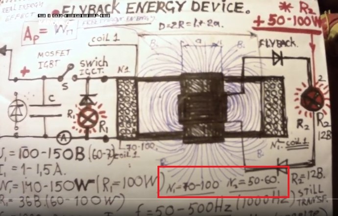

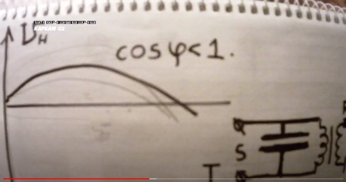

Andrey Melnichenko is another great inventor and has several patents on the effect he found. On his Utube channel he made countless videos to demonstrate the effect he found.
Chris has made several demonstrations to allow everyone to better understand the different effects of Andrey Melnichenko's research and I would like to make it a study and continuity of his thread.
When doing various searches on the web it is very rare to find those who have managed to make a replica of its effect.

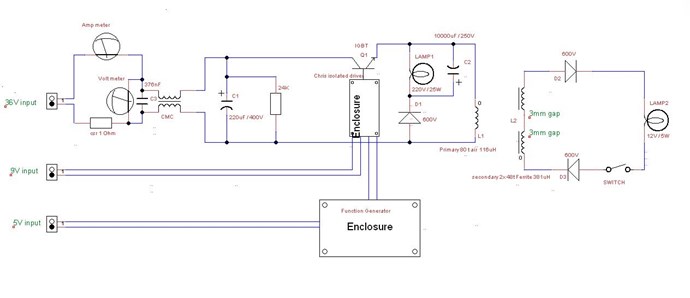

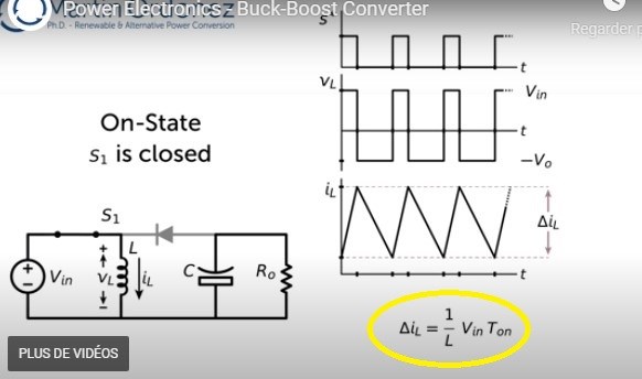

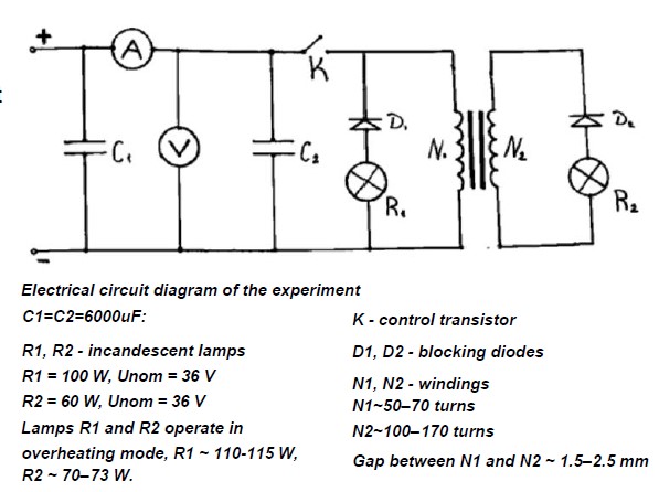

To study the phenomenon take the very simple diagram from the website of A. Melnichenko
This schematic has two coils L1 and L2 in mutual connection and as can be noted the same phase polarity (dot). To understand what is happening in the coils, an analysis of the polarities is necessary.
As Melnichenko himself explains there are two phases to take into consideration, the 1st magnetization and the 2nd demagnetization.
1 When magnetizing, T1 closes and L1 becomes negative on the bottom and positive on the top with the same phase polarities on L2. D1 and D2 being in reverse polarity then X1 and X2 do not light up.
2 During demagnetization, T1 opens causing L1 and L2 to reverse polarity as shown in the following diagram:
Since D1 and D2 are now forward biased then both diodes conduct so that X1 and X2 turn on.
Practical experience will follow to demonstrate if this is indeed what is happening.

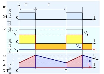

Lets observe this image in some detail:
You can see, we have Triangles in the Blue Waveform, clearly seen:
In the Blue Waveform, we see there is a line up of the Spikes, I have marked this in Red. These Triangles are the same as I have pointed out above:
This is where the Coils build up a Potential, this "Generates" Current, the Pump, the Tap is open for a Flow. Currents are Equal and Opposite. Lenz's Law, a Natural State, a state that Nature requires for a System to come back to Equilibrium. A closer look:
Its hard to see in a Sinusoidal System, DC Pulsing is a lot easier to see what's going on. Lets listen to one example:

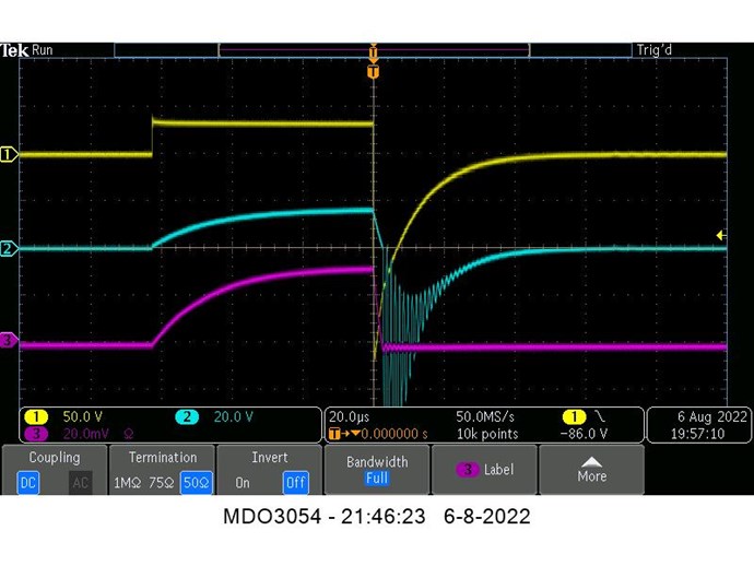

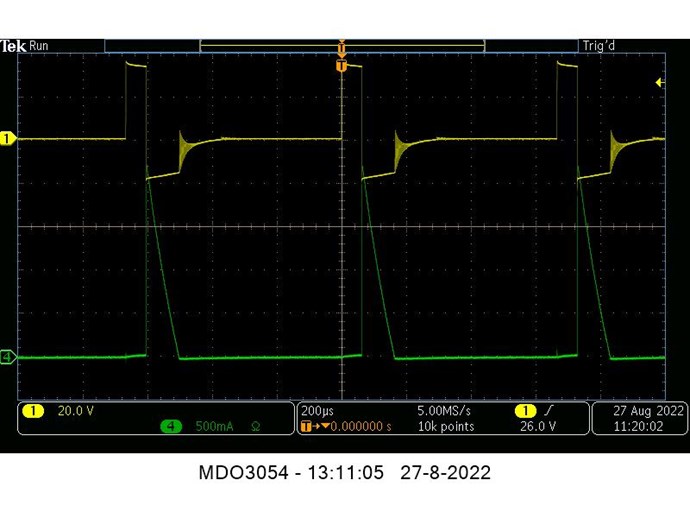

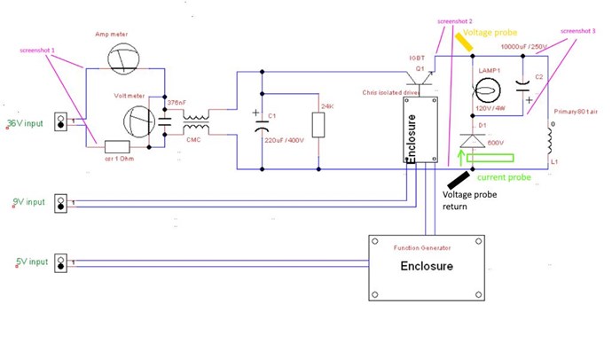

Itsu posted an image as requested, by my last post:
Ref: Itsu's Thread - A Melnichenko effect replication
This is wrong, its not how the Melnichenko Effects Works! L2 should be conducting a few micro seconds, D2 VConduct or break over Voltage, Delayed Conduction, D2 Conducts just after IGBT TOn! Itsu's Polarities are Incorrect!
I want to point out more, but at the moment, this is the first and most important issue!
Please go and read Itsu's post and thread if you have not already.

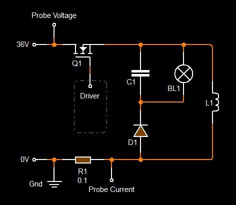

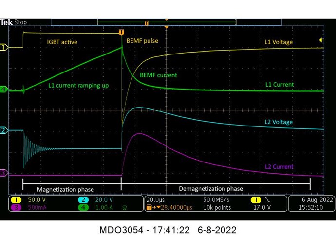

Itsu's Response:
Concerning the polarization of L2 in the above screenshot with the voltage and currents, it deliberately is chosen that way so that the power induced into L2 comes from the "demagnetization phase" aka "collapsing magnetic field phase" aka the "bemf phase" of the cycle, as that is, according to Melnichenko and Jagau, where the free energy comes from.
Jagau correct me when wrong!
The below screenshot is from when the L2 connections are swapped, so showing the other polarization effect of L2:
We see that now the Power into L2 is induced during the magnetization phase of the cycle which is, according to melnichenko and Jagau, NOT where the free energy comes from.
If those signals are still wrong, even when they are coming from a close replication of the circuit used by Melnichenko, then the circuit is wrong or the effect claimed is not there.
Itsu
Ref: A Melnichenko effect replication

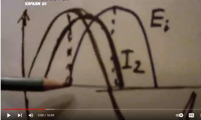

I just want to point out again, on this thread:
Yes, this image of the current is very important and
I confirm that I also find it in the Melnichenko thread effect.
The Conduction of the Diodes only stops if the applied voltage polarity changes or drops below the break over voltage! All Coils should not change their polarity during One Full Cycle! I have no idea what you're talking about? This is purely a DC System!

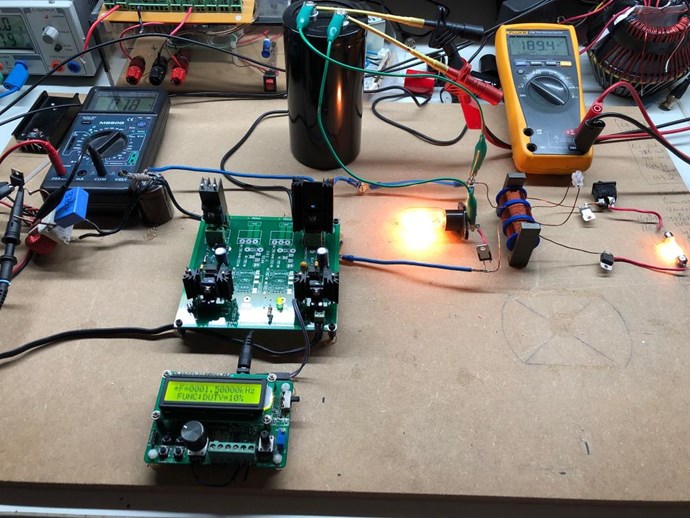

Chris posted this 10 August 2022
Gyula,
thanks for the extensive point by point analysis, this is a skill i lack still and very useful.
Like Chris, i would like to see some different kind of signals coming out of this circuit (less input and more output preferable), but the scope does not lie and presents these conventional signals belonging
to this conventional fly back circuit.
I can not magically change those signals to something more promising, it is what it is.
I tried both the original Melnichenko circuit and the modified by Jagau circuit with several coils and cores, but they all stay within the conventional 70 to 90% efficiency range.
I still have some modifications pending on the L1 and L2 coil / core, presented by Jagau, so we will see if it will change much.
Regards Kees

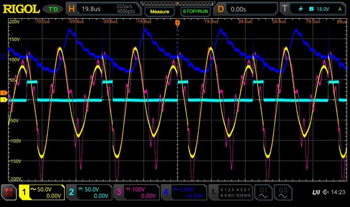

Hello Itsu,
You need to think Simply about this and NOT complicate these very simple things that entry level Electrical Engineers have mastered: Standard Buck Boost Converter
Waveform:
Any Alternating Current there? Or is it Purely a DC System? Hmm Trolls everywhere!
Which is as we have shown!

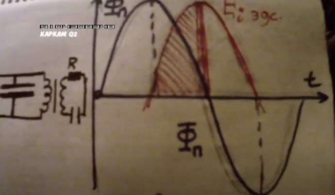

Beyond making a nice flyback, a more advanced electronics is an integral part of the Melnichenko effectt,
there are 3 important points to understand: taken from video by andrey melnichenko
cos phi
Magnetic flux versus voltage
and current, flux and voltage
I mean the maximum and minimum to observe.
The magnetic flux is expressed in Weber or Volt .second
The integral of the magnetic flux density (B) multiplied by a defined area (dA) gives us the magnetic flux of our system.

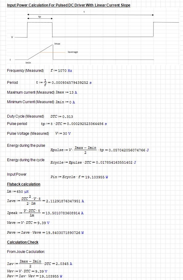

Aetherholic posted this 23 August 2022
Here is my input calculation in Joules together with a corresponding Flyback calculation that Jagu just posted. So now you have two ways for calculating the power from different measurements.
Input Power Calculation
This was done in SMath Solver which I like because it verifies the units so its a great check for calculations. Smath Solver is freely downloadable.

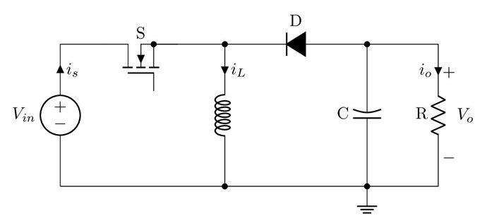

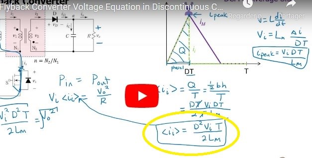

Found a video clearly explaining how to calculate the parameters of a flyback with the formulas you will recognize.
She is a young E.E. who explains very well flyback configuration parameters in DCM mode.

It seems the Guru's are having all sorts of simple Measurement Related Troubles:
To minimize the loading effect of the probe, clamp it at the low or ground end of a component lead when possible. This method also minimizes noise or stray
signal interference. This is a Tektronix recommendation
On this side you have the magnetisation
Si Itsu you are correct on the low ground side
Ref: Spark2 - A Melnichenko effect replication
Correctly Drawn Circuits with Measurement Points should be provided as standard. How about we give them a leg up and let them know where we take our measurements from in the Circuit?
Jagau posted this 26 August 2022
Itsu asks very good questions, and he is an outstanding experimenter
we are in discussion
Chris posted this 26 August 2022
I hope Itsu Respects your effort and ability and Reliably follows your Advice and Guidance Jagau!
I hope he Respects your Assistance!
Itsu should be measuring the Input Circuit also and NOT all the spirrious Components he has added before the actual Circuit:
Itsu should be measuring after C1 and NOT before C3 which is not marked. This is a very bad Measurement Practice! Very Bad! These Components are NOT Part of the DUT and should NOT be Measured as part of the Input to the Circuit!
This Circuitry consists of High and Low Pass Filters, including the Common mode Choke, and other components, which will skew the Signals entirely! Why Filter a Signal you're attempting to measure? All of these components have their own Losses also which is NOT Considered!
This is VERY BAD Measurement Practice!
This is how the Input Measurement should be measured:
Replace the 0.1R Resistor, R1 by the Isolated Current Probe if you have one!
Jagau has given you the Correct advice already:
Any Accurate Measurement should always be as Close as Possible to the DUT, Device Under Test and an effort should be made to exclude any Un-Necessary Circuitry that is NOT Part of the DUT!!! This is really Important and is basic Engineering Knowledge!!!
What we have seen is VERY BAD Measurement Practice!

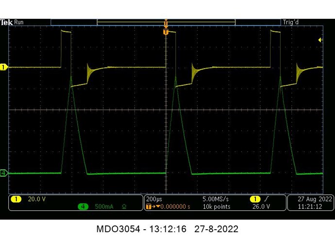

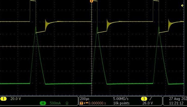

Congratulations to Itsu for achieving some success:
I think Jagau's Guidance and Patience is to be commended! Truly a Genuine and Humble Human Being!
Itsu now needs to figure out how to extend the Demagnetisation Phase:
And in comparison to the Magnetisation Phase:
My Friends, focus on the Area Under the Green Current Trace:
Is there More Current on the Demagnetisation Phase or the Magnetisation Phase? Its Asymmetrical Right?
Please Note: This set of scope shots do not show AU, we have no conclusive evidence Itsu has yet achieved AU yet! More work is needed! At least Itsu now has a Waveform that should be represented!

the area under the curve represents the amount of magnetic flux which is actually present.
the guy in the video from university did not mention, that energy is stored inside the coil. maybe he thinks all of the audience knows that but i'm sure most of them did not.
it is also funny, that if someone wants to step voltage down from 24V to 12V the ON-time from halfbridge has to be 33%  -  does this sound logic?  we can produce voltage for nothing they told us...    why is it not linear? 😎
have a nice day!

It is very important to make the difference in using the right formula.
When your circuit operates in CCM mode Chris provided you with a video and this is the one used,
If your circuit works in DCM , Like that of Melnichenko, the formula used is very different and this is the one used.
This formula is derived from an integration.
And the cuurent look like that,green curve. Photo provide by Itsu
have a nice day!
Hi, the area under the voltage curve is volt-second and is equal to ΔΦ, the total flux, like you said. 33% duty cycle for half voltage is logical: during 33% the coil is charged, magnetized with 24v, during twice that time it i demagnetized with 12v (or actually -12v) at steady state.
current steepness=V/L=di/dt, higher voltage over L, steeper current ramp. .

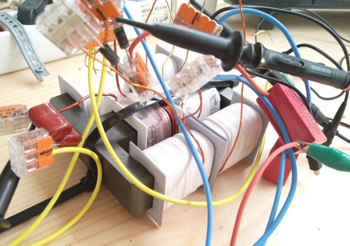

baerndorfer posted this 01 September 2022
this is how it looks - 2 e-cores like A.Melnichenko uses. in my build i use POC-coils as output coils because for me it makes perfectly sense.
when you got the right frequency you will see how the output is pumped (CH4 - this is where the load is connected). my input is from halfbridge topology (CH2). CH1 is my primary which is in series resonance with capacitor. CH3 is one leg from POC output coil.

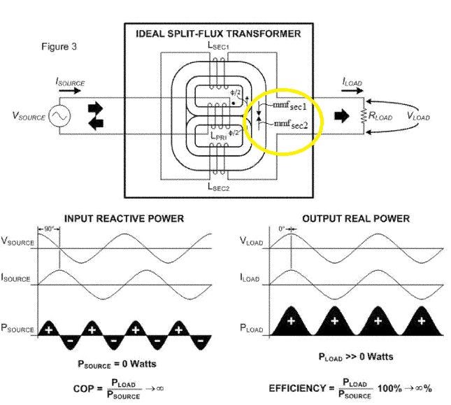

In the current project here, on the primary side the pulse on the primary (air core) produces negative energy as predicted by Lenz's law. The energy thus stored in the inductor produces this negative electricity and is almost entirely recovered by lighting the first lamp.
In addition, the air core is not magnetically linked to the other two ferromagnetic cores, which pick up the air core's magnetic fields for free with almost no magnetic link.
This is the first principle of the Melnichenko effect and it is called the principle of field separation. It is essential to fully understand this basic principle before going any further.

For those who want to understand it, even Bill Alek EE in Magnetic Flux Transformer patent US9620280B2, does the same calculation as me when calculating the average power in an inductor Pavg = almost 0 watt with some very minimal losses.
An inductor does not consume a watt same for capacitor.
The energy (joule) stored in an inductor momentarily can be calculated, the voltage (V) BEMF as well as the current (I) peak.
 But at no time the power in watt, because it is almost entirely returned to the source or as in Melnichenko it is used to light the first lamp, then it becomes the consumption of this first lamp which otherwise would have been returned to the source.
The meters measure the positive energy supplied to the source only.
Jagau posted this 06 September 2022
If we take a good look at the output configuration of Alek's SFT you will notice that the two output coils are in partnership configuration.
Look in the yellow circle.
What Chris always said.  Although others don't speak highly of his measurements, I find them to be correct. It's because he's a little ahead of the others and they have trouble understanding what he's saying, so they try to contradict him.

Jagau, this patent you're sharing is gold! Many thanks.
It closely explains how Chris' system is working, and what he has been telling all along but in less technical terminology. Phase-conjugate :
In operation, the system causes the split-flux transformer (SFT) to function as a pumped phase conjugate mirror (PPCM), which transforms conjugated electromagnetic (EM) energy to real EM energy. Very high transformer efficiencies have been realized with this technology. The PPCM occurs by splitting the flux equally between the two transformer cores. The two cores include secondary output coils wrapped around each core and wired in Such a way that the resulting magnetomotive forces oppose one another. This is a special bifilar output coil configuration, which has a benefit of greatly lowering the output impedance of the coils. The output coils may be wired in series or in parallel In addition to lowering the output impedance of the coils, little power is reflected back to the primary due to the mutual coupling of the coils. Therefore, power delivered to the primary coil is highly conserved and not wasted on impedance. Nuclear non-recoil action emits both real EM wave and its phase-conjugated replica EM wave. While the real EM wave is a time-forward wave, its phase-conjugated replica wave is time-reversed. The phase-conjugated time-reversed wave is present everywhere in the universe as negative energy and is utilized and transformed by the PPCM as real EM energy.

@Jag
   I am ready to wind up the coils. Will use the rods I have for now and order ferrite from a local source here. I am a bit unsure of the turns count tho. I have a 4" form and 3 layers on it with 50 turns is only 2.7" . Is 50 enough or should I go more and double that for the inside coil?

In his Y.T  video
you will find the recommendations and frequencies of Melnichenko, look in the red square.

SRO, clever circuit. I wanted to see what's happening, here's a falstad schematic:
https://tinyurl.com/2zp8ylne

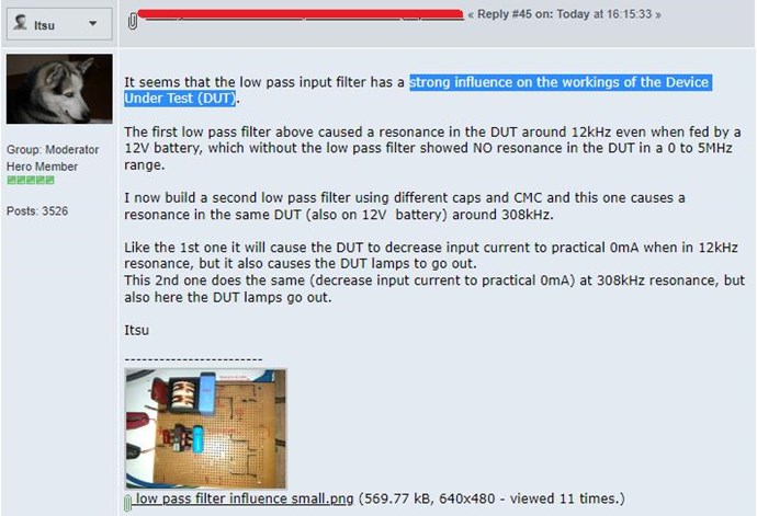

Chris posted this 07 November 2022
It seems we have another confirmation, of the Other Forums Measurement Practice being totally Un-Satisfactory for Accurate Measurements on a Running Machine:
The practice of insisting on Filtering a Main Buss, that affects the actual Operation of the Machine Under Test, or Device Under Test is BAD Measurement Practice and should NOT be done!
We now have confirmation, from Itsu, that was insisting on this Filter in the First Place, to make Bad Measurements, that this is now in fact the case!
I believe I have been telling others that this is NOT a good idea and is Bad Measurement Practice for some time now! Skimming through this thread will show you!
Remember, some of these people have been telling you for decades that DUT was a "Measurement Error" - Mostly Fake and False Information!
My Friends, this is why we are Light Years Ahead of the Other Forums!
Filtering out this phenomena is about as un-wise as anyone could get!
This is why we are Light Years Ahead of the Other Forums!
