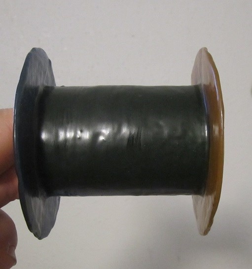

Aetherholic;
Your coil/core looks outstanding but which is it a primary or a secondary. ??

It is an exciter coil.
Marathonman posted this 14 July 2018
In that case you are correct as i would throw out the software  because something doesn't add up.
i think you might agree with me at this point to why i chose to stay away from electronics and definitely simulation.

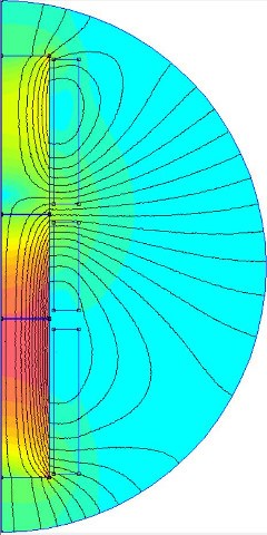

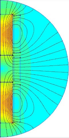

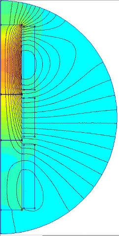

Validation of Figuera Triplet coils and Marathonman's theoretical explanation using FEMM 4.2
To check my coil setup I decided to simulate the magnetic field of the coil triplet using FEMM. The setup is top and bottom opposing field (N-N) and a central output coil. Dimensions including air gap were exported from CAD into FEMM. Coils were simulated using correct wire gauge and number of turns. Cores were simulated using pure Iron. DC conditions were used at the 3 extremes of exciter currents. Output coil currents were set to be opposing the movement direction of the field (as per Marathonman's explanations).
Condition 1 - Top coil 10A Bottom coil 5A Output coil drawing -10A
Condition 2 - Top coil 7.5A Bottom Coil 7.5A Output coil drawing 0A
Condition 3  - Top coil 5A Bottom coil 10A Output coil drawing 10A
Finally a simulation with no load was done - - Top coil 10A Bottom coil 5A Output coil drawing 0A
Results
As can be seen, with a load on the output coil the field outside the cores is swept backwards and forwards over the output coil and surprisingly the field within the core is pushed into the core of the less energized exciter. The fourth plot shows clearly that if there is no load, the field on the output coil remains static.
A further plot was done where the current was set to produce an opposing field at the more energized exciter:
This produced less gauss on the output coil but the change in gauss, induction, may actually be more.
Conclusions
From the simulation the output coil must have a load for the system to work and two field movements are involved, one outside the cores and one within.

Marathonman posted this 16 July 2018
Aetherholc;
  It seams your simulation is not so stagnant after all as it is quite correct, there has to be a load on the output in order for the device to work and even be tested otherwise there will by zero on the test bench. this was brought up when i was on another Forum but apparently i failed to bring it up here which i am much sorry for my mistake or forgetfulness. or my otherwise lack of full disclosure and for that i am truly sorry.
One thing i will bring up is the evidence that Figuera might have use 1 amp with the spilling of Buforn's guts as he did indeed run his mouth in his prior nullified patents. i would just use this as a guide line to work with though which is what i am doing.
PS. your simulation still does not look right as it shows the wrong field projections but i guess that is just me.
Aetherholic posted this 16 July 2018
I completely agree, a simulation is only as good as the simulator which in this case assumes the imaginary field lines can flow from pole to pole which is clearly incorrect but until we have a correct simulator its the only thing we have to work with that might save some time when designing the coils as long as we recognize its severe limitations. The good thing is that it managed to simulate the need for a load and so all testing should as you said be done with a load in place and i would think preferably the load which the coils are designed to drive because only then will the required exciter current for that particular coil arrangement be apparent.
As you have proved before there is no substitute for bench work.

The simulation of the field lines going from field to field in an electromagnet is quite possibly correct (kind of). as we all know a magnet has both fields intersecting at the bloch wall but an electromagnet will not let that happen because of the windings blocking it from happening. i think that is one of the reason why an electromagnet is much stronger as all field lines are streaming from pole to pole but in a magnet they are not. of course there are millions of domains involved also but you know what i mean.
"As you have proved before there is no substitute for bench work"
I couldn't have said it better myself.

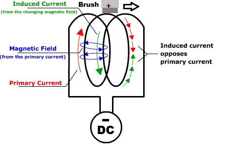

This graph depicts the the exact thing that is happening in the Figuera part G device.
as the brush is rotating the winding count changes per that side of the brush separated by two north opposing fields. as the magnetic field to current ratio is either increased or decreased per side it changes the opposition to current flow. the more the magnetic field linking loops the less current flow, the less magnetic field linking loops the more current will flow.
each loop added to that side of the brush will add to the magnetic field to current ratio so according to Faraday's Laws any change in magnetic field induces EMF which according to Faraday's Laws of induction to occur a magnetic field change has to take place in which it just did.  according to the Lenz Law it will be opposite to the original current flow which will reduce the original current flow as more loops are added and increase the current flow the more loops are subtracted.
each time the side that adds magnetic linking loops and current is reduced,  it will release the reduced current potential from the magnetic field into the system combined with the reducing primary's reduced potential will off set the rising side potential drop.
each time the side that subtracts magnetic linking loops and current is increased,  it will store into the magnetic field for the next half cycle of reduction causing a voltage drop on that half of the system.
each side of the system will off set each other so the added secondary loop back will cause the losses to be replaced and amplification within part G to the rising side of the system.

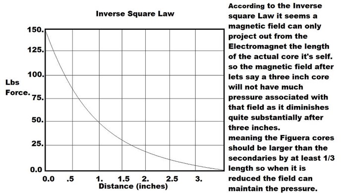

Again i can not emphasize the importance of the Inverse Square Law. when you are dealing with magnetic fields the projected magnetic field is in proportion to the length of the core it's self. what this means is the magnetic field will project out only the actual length of the core so if you have a three inch core the magnetic field diminishes rapidly to zero per the length of the core it's self.
so what i am trying to say is when building your primaries always make the cores and coil at least 1/3 longer than the secondaries so when your primaries are reduced it will still be able to maintain the pressure between them. if the secondary core is the same length the reduction of current will be to great to get the sweeping action across the secondaries and induction will fall to that of the rising primaries alone. always wind the coil almost the entire length of the core.

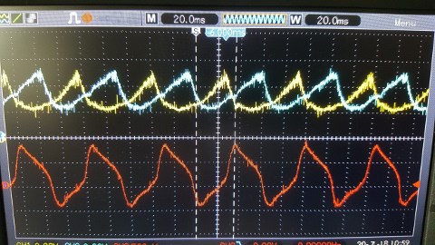

So, correct me if i am wrong, my interpretation of what you said is:
We have two exciter arrays, part G, a commutator and the output coil array. In order for the correct fields to be generated there must always be a current flowing through the output coil of the correct polarity.
In the initial condition we have a DC supply connected to part G north brush and via part G to the exciters. We also have the Output coil connected to the north brush via the commutator. So in this initial condition, the external DC if connected correctly, is commutated as AC to the output coil maintaining the correct polarity minimum AC field in the output coil until the induced AC via the exciters takes over.
Now I am trying to work out the connections for the DC, the negative return from the exciters, the commutator, the south brush and the output coil.
Here is my part G and output coil without exciting the output coil with additional current.

Correct, as there has to be a load on the output at all times.   the DC is raised and lowered from part G to the primaries which causes the AC in the secondary no commutation. the commutation is from the secondary feed back commutated to DC for part G and the primaries. the only AC is in the secondary and the load.
Yes, once the polarization takes place the primaries and the secondaries part ways and it is just the sweeping motion of the primaries inducing motion into the secondaries.
your wave forms are looking better.
inducing system is DC the output is AC with feed back to part G commutated to DC just like a standard generator.

It is quite amazing once you realize with the change of inductance the current flow will be reduced just how smart Figuera actually was in using an active not static inductor in his system. running current through one loop of wire over an Iron core will not change the current much at all but adding multiple loops to the core then you will have much more self inductance as the loops magnetically link to each other increasing the opposing magnetic field to current ratio. then using a closed core controller you will achieve an even higher efficiency with very little flux loss.
since the magnetic field is basically the brakes to current flow the larger the magnetic field the lower will be the current flow. as Faraday's states for any induction to take place all that is needed is for the magnetic flux to change within the circuit and never states anything about current. since we are using DC in the system the circuit has to be changing at a constant rate or self induction will cease.
so Figuera used an Inductor that has a positive moving contact that constantly changes the amount of loops that magnetically link to the circuit and in doing so constantly changes the intensity of both magnetic fields on either side of the brush that cause self induction within each independent sides of the circuit to take place.  this is in exact accordance with Faraday's Laws of induction.
If you have two negative sides to an Inductor with a moving positive brush contact,  you will in fact have two opposing magnetic fields at the positive contact that will keep those two sides of the circuit completely separate but in complete unison.
thus the end result that Figuera achieved was two electromagnets that increase and decrease in absolute unison which is required in order to maintain the required pressure between them and on going induction to take place. the magnetic fields will never combine yet the Electric fields are positive and additive.
then on top of all that, when one side is reduced that portion of the reduced magnetic field is released into the system combined with the reduced primary potential to off set the rising side voltage drop as any increase in magnetic field storage will cause a voltage drop in potential. he then looped back a portion of the output just like a standard generator, to replace the losses occurred and give rise to amplification to the rising primary.
Sheer Genius!

It is really simple folks.
if you have X amount of loops on an iron core the self induction will be X amount that opposes the current flow. if the contact is stationary the current flow will equalize to a steady state.
if you add winding's to the coil the self Inductance will in fact have changed as adding loops changed the magnetic flux to current ratio causing an even larger current reduction then it to will equalize to a steady state.
if you move the contact on a continuous basis adding or subtracting loops, the self Induction will in fact change on a steady basis which will be opposing to the original current flow. so in doing so an EMF is produced in the circuit that opposes the original DC current flow because the magnetic flux has changed and this change according to Faraday's Laws of Induction will cause an EMF to occur that will be opposing to the original current flow.
static self induction taken to an active self induction with the rotation of a positive brush will in fact control current flow by changing the magnetic flux to current ratio which is in complete compliance with Faraday's Laws of Induction.
anyone stating otherwise is just fooling themselves and others.

Aetherholic posted this 14 August 2018
A quick update.
After spending a lot of time running simulations I came to the conclusion that Marathonman's C core is the way to go because the parallel inductance on the torroid Part G causes too many tuning problems if it is a continuous wind. I am now in the middle of building Part G 3.0 and the entire system so I will post details as soon as I can.
There is one thing to re-iterate. As Marathonman said, this system is controlled by INDUCTANCE. Once you forget resistance and concentrate on inductance ratios then everything becomes clear. How many joules do you need to store to offset the system losses and what effect does field addition have not only on the exciter/output triplets but also on Part G and where does the additional energy go within the system. Tesla once said that to generate power you have to use power which is absolutely true in this system, No load and you will get nothing out.

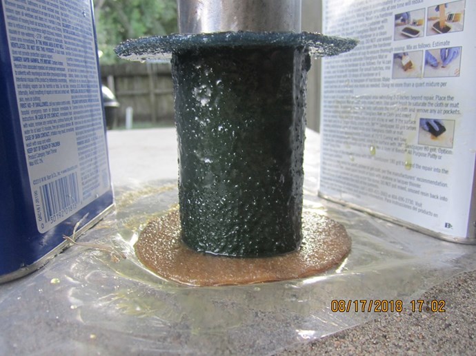

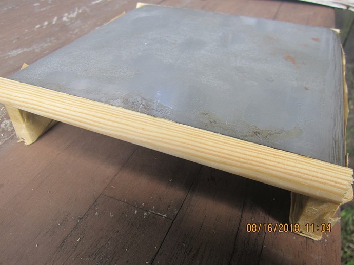

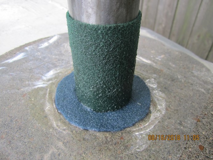

Finally have time to work on my new part G core. the first pic is half round glued to the core to alleviate the square edges that are a complete pain to wind. the round corners help in the transition when winding. i will be using the epoxy i ordered to hold the wire to the core that i posted in a previous post.
the second pic is of the new primaries i am finally finishing up.
Marathonman posted this 17 August 2018

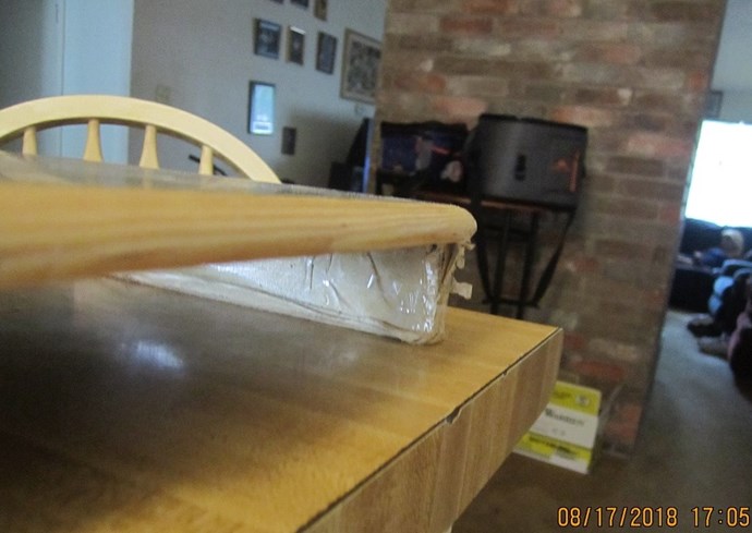

managed to get some sanding done on the core edge and is ready to wind and the bobbins are almost ready to sand and paint.

I would also like to add more information on that 1 kilowatt 14.8 lbs per square inch 7.4 per primary.
in order to induce movement into the secondary Figuera had to reduce one primary and raise the other to get the sweeping of the secondary across the electric field. in doing so the reducing primary is reduced hypothetically 30 percent while the other is increased to get full sweeping action of the secondary. so if you reduce one primary 30 percent that means from 7.4 lbs per square inch to 5.2 lbs per square inch while the other primary is peaked at 9.6 lbs per square inch. the rise in the primary is from the amplification factor of the two reducing potentials and the secondary feed back combined giving the needed amplification to the rising primary electromagnet. from this action both primaries will always maintain the 14.8 lbs per square inch across the entire length of the secondary needed for the 1 kilowatt secondary output. these numbers are not exact but at least you get the idea of what needs to be done in order to maintain the output and how it is done. the primaries must be built with these parameters in mind yet still avoid saturation.
both primaries at any time will add up to the total output of your secondary. one increasing in pressure the other decreasing in pressure but both pressures equal the needed output pressure at all times.

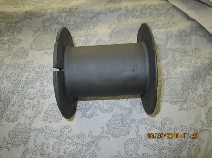

Here is the finished new bobbin. all i need now is a light sand and paint then its wind time. these babies are so strong i can not crush with my hands. so great to wind on.
total cost to build is around $1.00  to $1.50 per bobbin.

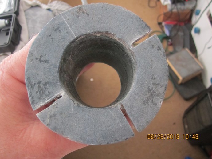

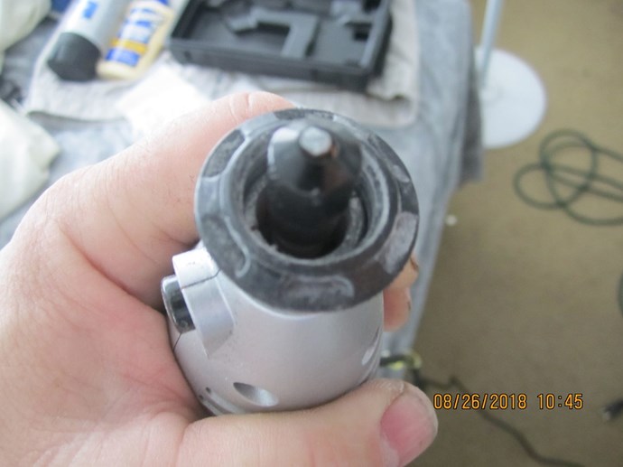

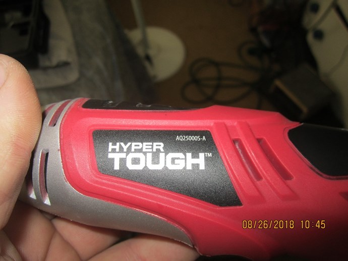

Really bad day in Paradise.
bought a off brand Dremel tool to make four cuts in the end of the bobbins to begin winding and the lousy shaft of the cutting tool sheered off after three cuts flying hitting me in the stomach cutting me.
the tool below is the most lousy Corporate piece of SH#T i have ever bought. DO NOT BY THIS BRAND as you will have nothing but trouble. so now my whole day is wasted because of this BS.
