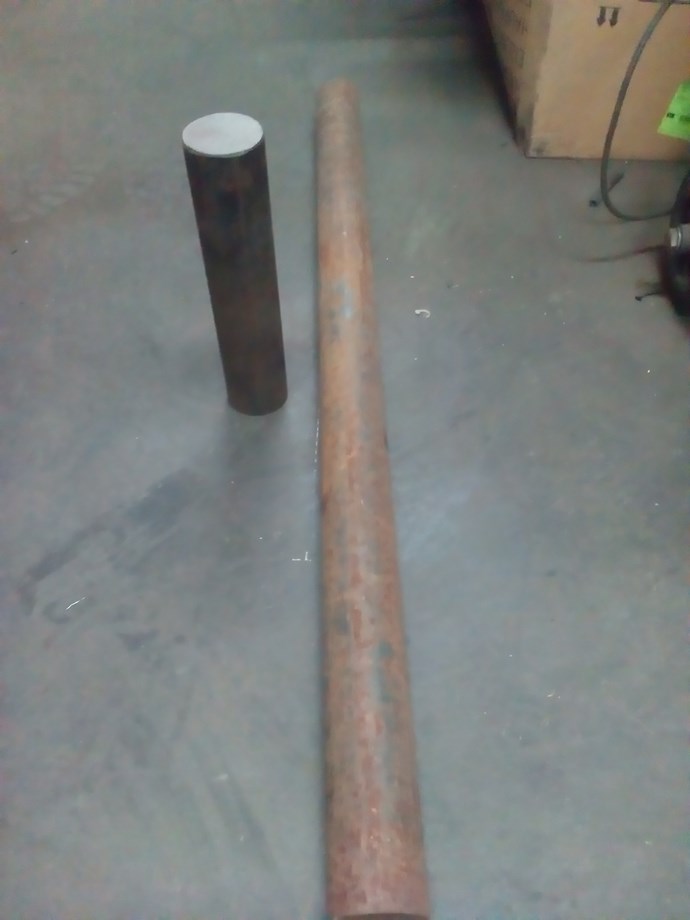

Peter posted this 08 October 2018
Aetherholic,
Thanks for the quick responce. And thank you for elaborating..
I got hold of 130cm of iron rod  (60mm  diameter). Planning on annealing it prior to use
iron rod 60mm..

Peter posted this 15 October 2018
Hi Aetherholic.
8 layers and 367 turns of 2.1 mm means your primary's are approx. 10cm length..  I cut my cores 9cm lenght.
Annealing them today .  Will use laminated MOT core's on secondary's.

Peter posted this 16 October 2018
Cornboy..
That's some build you've got there..  very nice indeed.
Aetherholic.
I chopped up the 130cm bar in pieces of 9 cm, then fired up the old Oxy- Acetylene torch, and heated them all up until they where REDHOT      after that, i let them slowly cool down to roomtemperature.  took about 10 minutes per core to get them that hot.
This will remove any stress within the iron core, and make it less hard..(better magnet i think)
I will leave one core un-annealed, so i can compare the magnetic field strenght's, with the same coil setup later.
Next i will be sanding and coating them to prevent oxidation.
Kind Regards, keep on building...

Aetherholic posted this 16 October 2018
Peter
Great, the annealed / un-annealed comparison will be of interest to all I think and quite valuable information.
